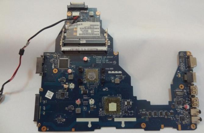

          I can't see a schematic for this board anywhere easily, do you have one? How much experience do you have in repairing laptop boards?
          Also, can you post photos of the board?

            Here is the sample picture of motherboard, sir.

                        chceck pins of mosfets right behind the ffuse or on the other side of board right to the fuse

                          Re: toshiba satellite c660d-13h no power problem
                          sir ktmmotocross, Can you help me how to test if the mosfet is working or not? I don’t know how to test it using a tester.
                          • ktmmotocross
                            Boardkiller
                            • Feb 2014
                            • 3627
                            • slovakia
                            just chceck voltage on its pins
