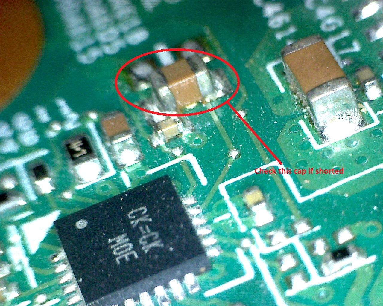

    Dell N5010 no power on
    Hi guys....
    Today i got a dell n5010 with no power on.....
    1. i found that no enable (EN) voltage at RT8206b
    2. i found that no AC_IN voltage at EC
    3. No voltage at power button and no 5v and 3v out put...
    I inject the 3.3v AC_In voltage but no EN voltage at RT8206b
    Whats the problem........ any body suggest me......

    Re: Dell N5010 no power on
    there is a post if you search where it say if 3.3v on AC_In the chipset its bad
    https://www.badcaps.net/forum/showthread.php?t=39965
      i have repaired two laptop whith this syptom and it was a shorted capacitor near the 3/5 REGU, just replace it and it goes fine.
