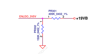

    Hi, all
    LA-L191P BQ24781 signals pin 28 -> 19V [VCC], pin 5 -> 3.3V [ACOK] pin 6 [ACDET] 2.6V, pin 24 -> 5.3V [REGN], pin 25 -> 5.3V [BTST] ,
    missing +3VLP -> EC -> signals for manage BQ24781. In the power sequence the +3VLP is the first signal in AC mode.
    I presume that the bios is working because one time the motherboard generate +3VLP and goes ON but after a shutdown the situation
    came back to no power on -> no main 19V. The question is: who generates +3VLP which is the basis of all other signals?
    Every time with the BQ24780S it's like starting from scratch, is +3VLP essential for the BQ?
    Schematic & boardview - https://www.badcaps.net/forum/troubl...-g53g-la-l191p
    Many thanks

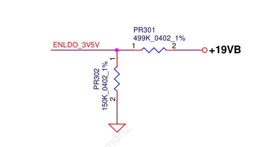

    See attached. These 2 resistors enable the LDO rails.
      • 21441
      looks like PU301 .+19VB -> PR301 -> ENLDO_3V5V -> PU301,PU501
