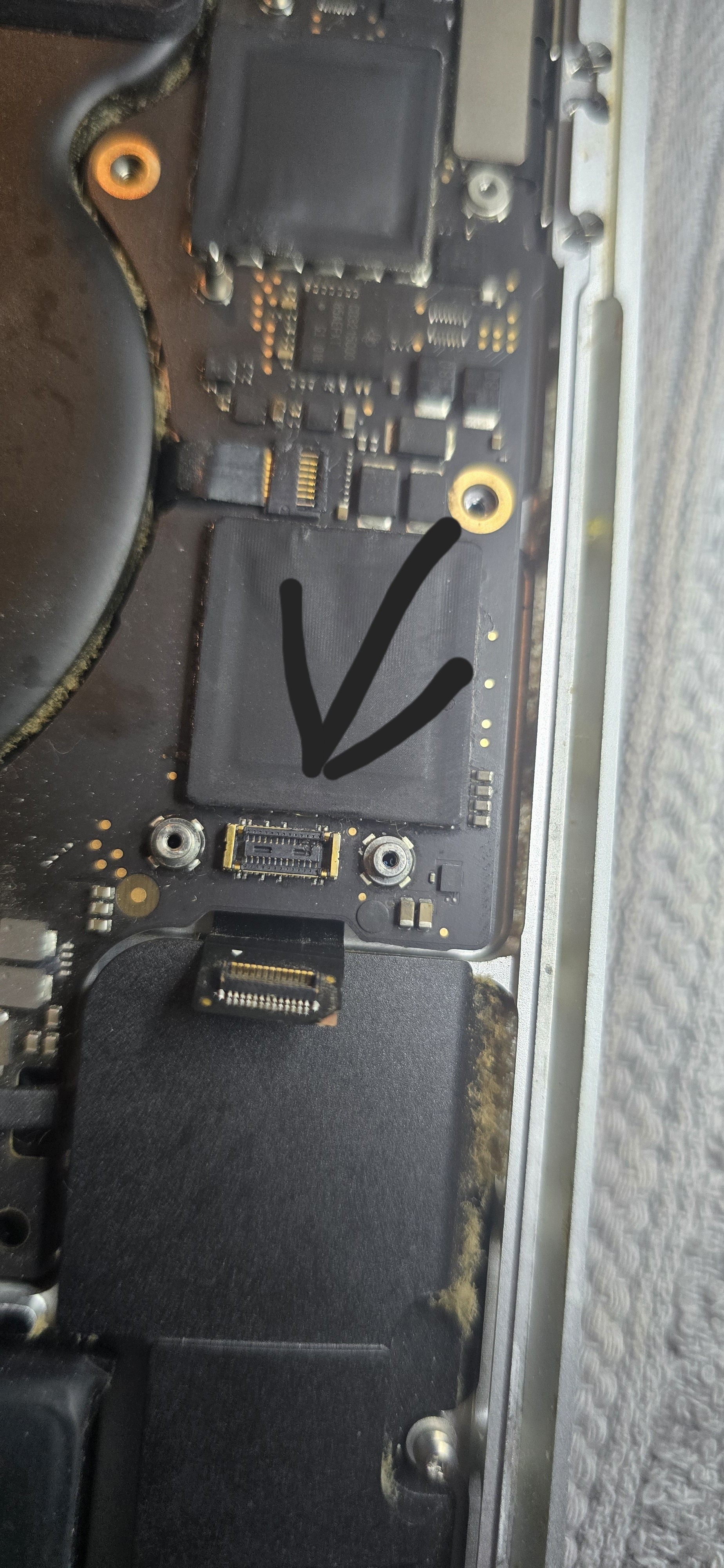

    Hello, can anyone tell me where I can get this 26-pin FPC connector? What is the connector for?So that one's also for the Touch Bar. I thought only the FPC at the top was for the Touch Bar. But where can I get it? I can't find the connector online. I only found the 22nd pin. Thank you.

    The Touchbars (aka DFR) consist of 2 components, the CTP (capacitance touch panel) and the MIPI DSI interface.
    As expected, each is a custom part made for Apple. Of course available in Asia with a few creative search keywords.
    The part # for the 26 pin connector is DF40SG(1.5)-26DS-0.4V = J5110. Best to request the 'J5110 connector for A1990' when chatting with suppliers in Asia.
    For the touch component, it is AA07-S022VA1 = J5100.

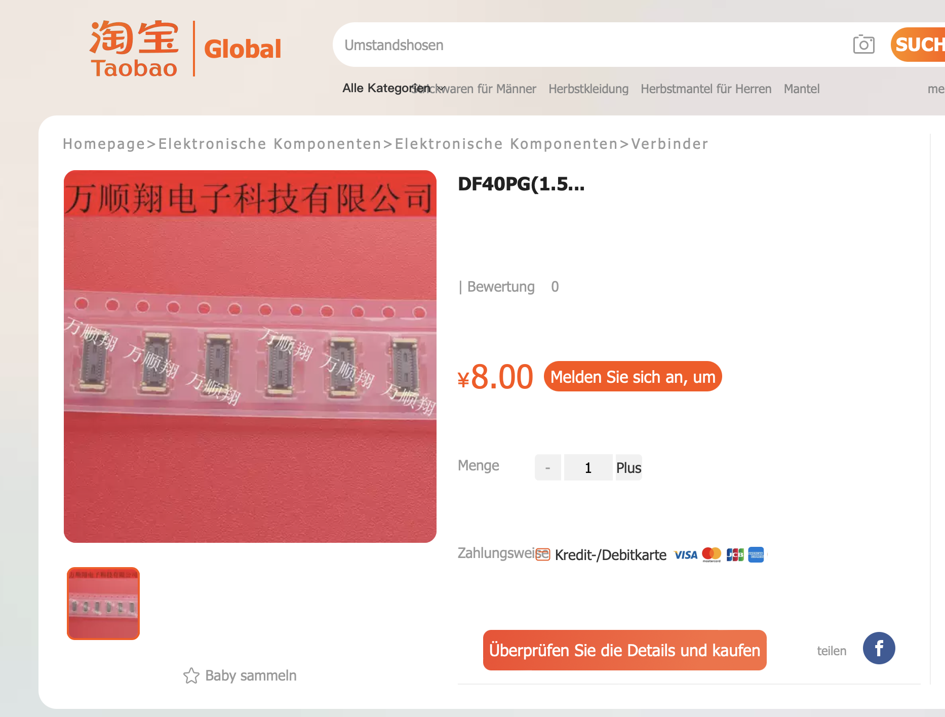

        https://www.hklrf.com/DF40PG15-26DS-04V51_6285.html
        We will be in Asia in October and determined to find a lower cost option for these parts. Confident they exist.

          It's very cheap here. I can't just manage Chinese
          • mon2
            • Dec 2019
            • 14657
            We did manage to setup an account with Taobao. Was not simple to do but succeeded after following a few YT videos.
            From the published price, the connector is ~$1 USD which is fair for low qty purchases.
            The trick to Taobao app is to select Singapore as the country to deliver and then the app will be all English. Find and fill you cart and before checking out, switch to Chinese again but with your real address for shipping. We did this earlier this year on some development tools which are only available on this portal.
            Review this video:
            https://www.youtube.com/watch?v=KGRr...el=AttiqueStic

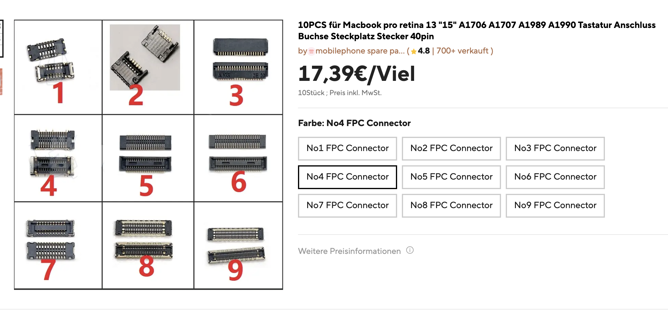

                  What about this listing on Ali?
                  https://www.aliexpress.com/item/1005...origin_prod%3A
                  Failing that, steal it off a donor board. Should be plenty of dead A1990/A2141 boards floating around with dead SSD's

                    Hi, i think the Nr 4 is right! 10Pcs is ok for 17€ thx

                      I did buy
