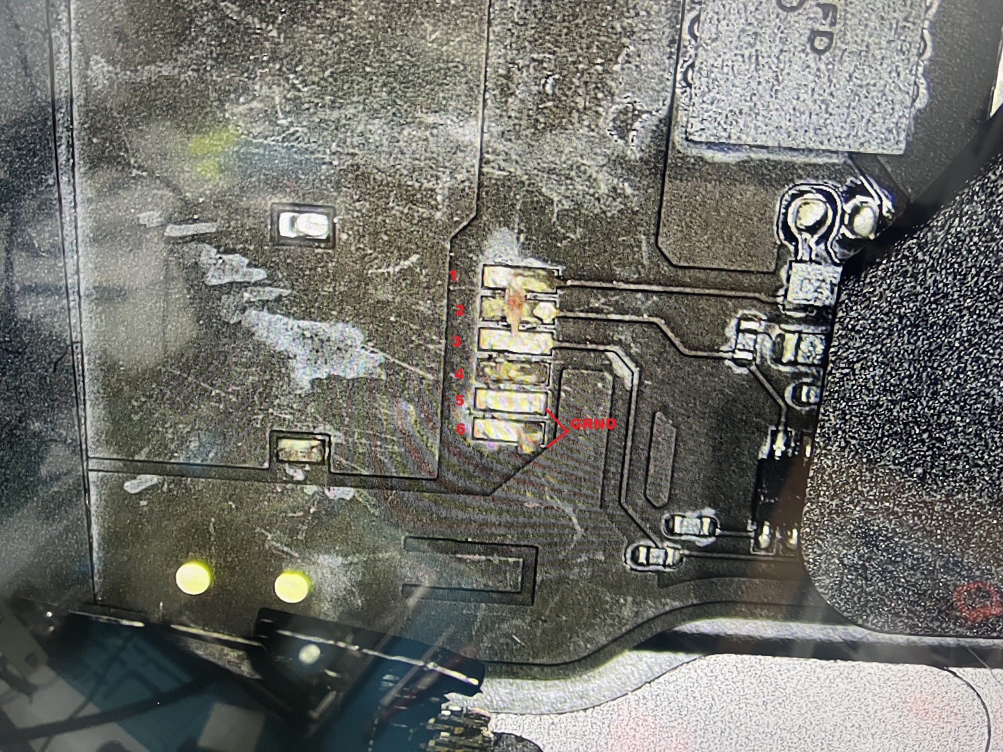

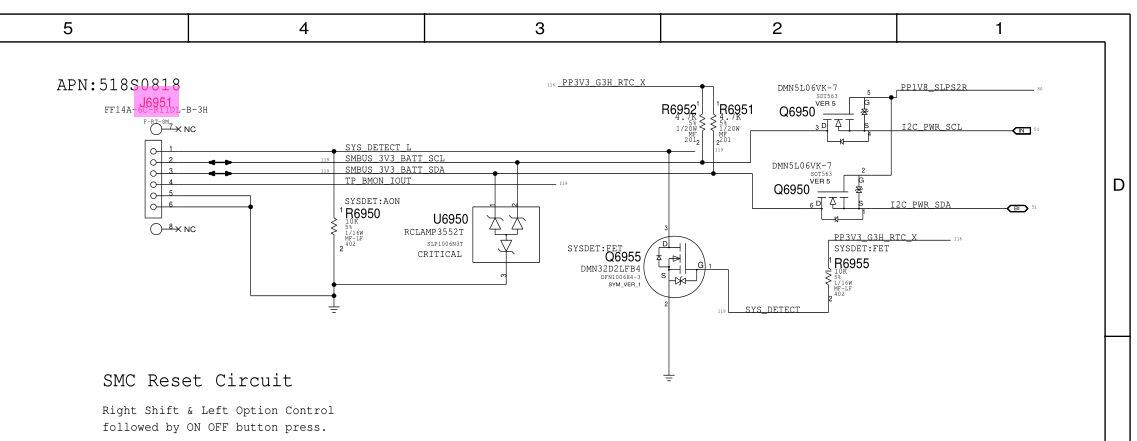

Hi Gang, Im working on Macbook Pro A1990, the battery connector was torn off during friend trying to replace battery. I soldered on the connector back, and created traces. The battery does charge (according to amp meter), and does power on battery only. But the signal detect line maybe done incorrectly, and the macbook shows "X" over battery icon, and "Service Recommended" on new battery
Can somebody point me to which of these connector pins is responsible for battery detect/data line? Pin 4 on schematic had a nub on the trace, im not sure if that is important, but I ran a jumper to the corresponding test pad
Any help or advice much appreciated!
