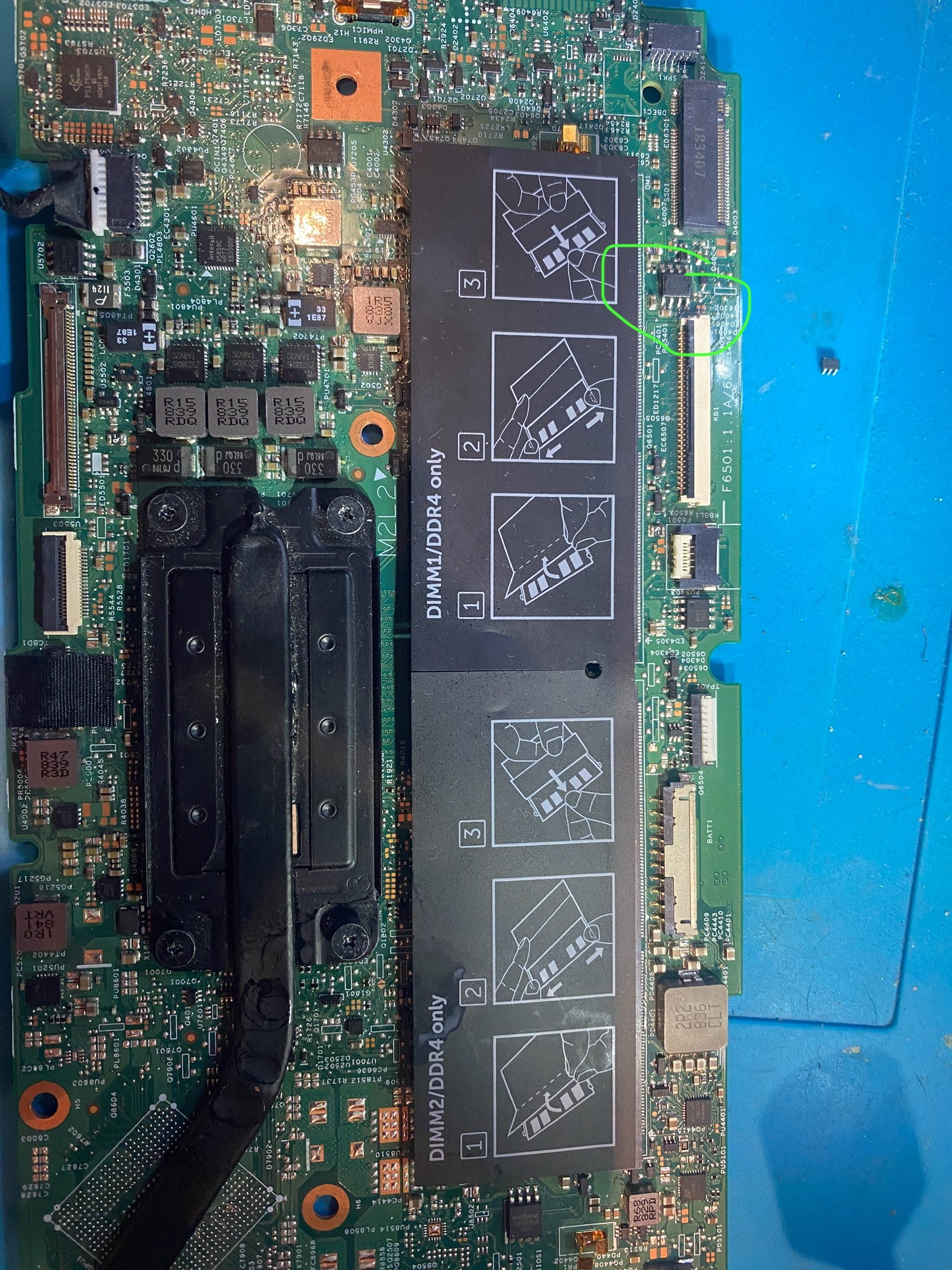

    Does anyone possibly have the boardview file for this board. I have the Schematic already.
    The IC labeled "53A8" is getting extremely hot. This seems to be a 5V voltage regulator.

    Post a few pics of the area of interest.

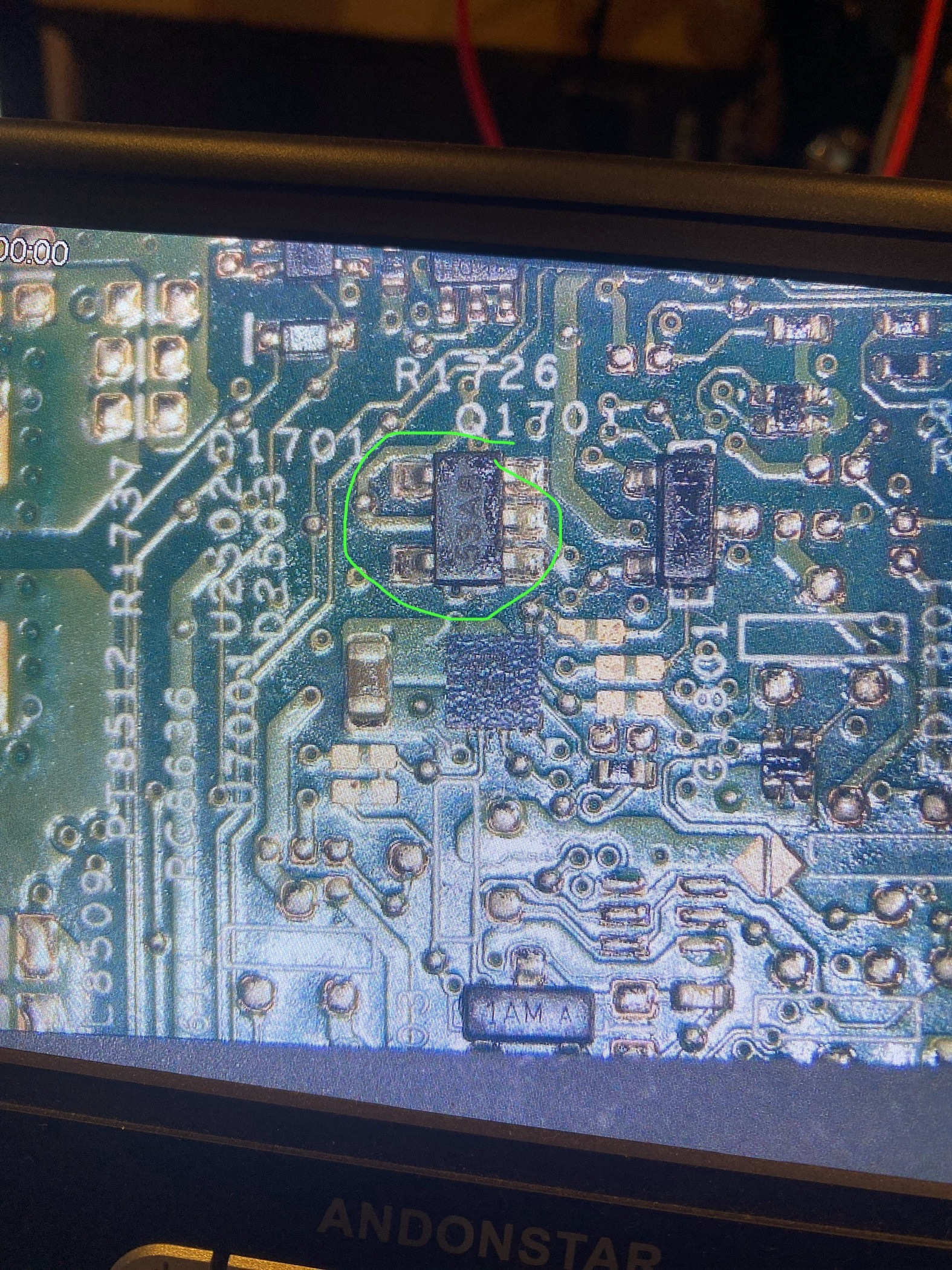

      This is the area and attached pic. The circled IC is getting very hot.

        It's a USB power distribution switch IC
        APL3553A
        Marking 53A*
        Remove it, you'll lose power to the USB port it's connected to
        Also check for shorts on the USB ports themselves
        Afterwards you can replace it, many vendors offer pin compatible equivalent ICs

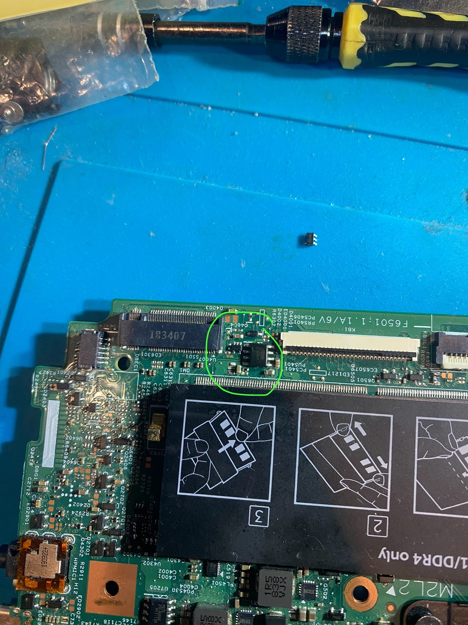

          Thanks, I removed the IC and still no sign of life.
          There is a mosfet that is getting a little warm but not super hot as you can see in the pic.

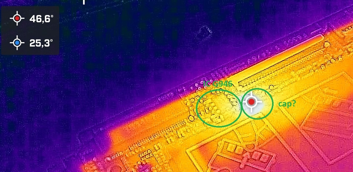

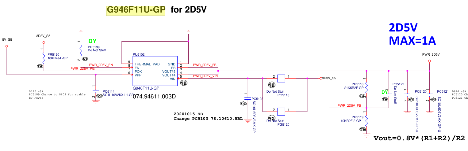

            Looks like one of the caps near the G946F11U-GP IC, it's --2.5v regulator for DDR4-- EDIT: Not actually, see below post
            As the IC is to the left of keyboard connector, that cap looks below it
            Click image for larger version  Name:	ic G946 or cap.jpg Views:	0 Size:	262.9 KB ID:	3650689
            Found it on an schematic for another board, this one specifically, attached the relevant part for reference
            Click image for larger version  Name:	g946f11u-gp.png Views:	0 Size:	99.9 KB ID:	3650693
            EDIT: On your schematics it says APL5934 for 1D8V

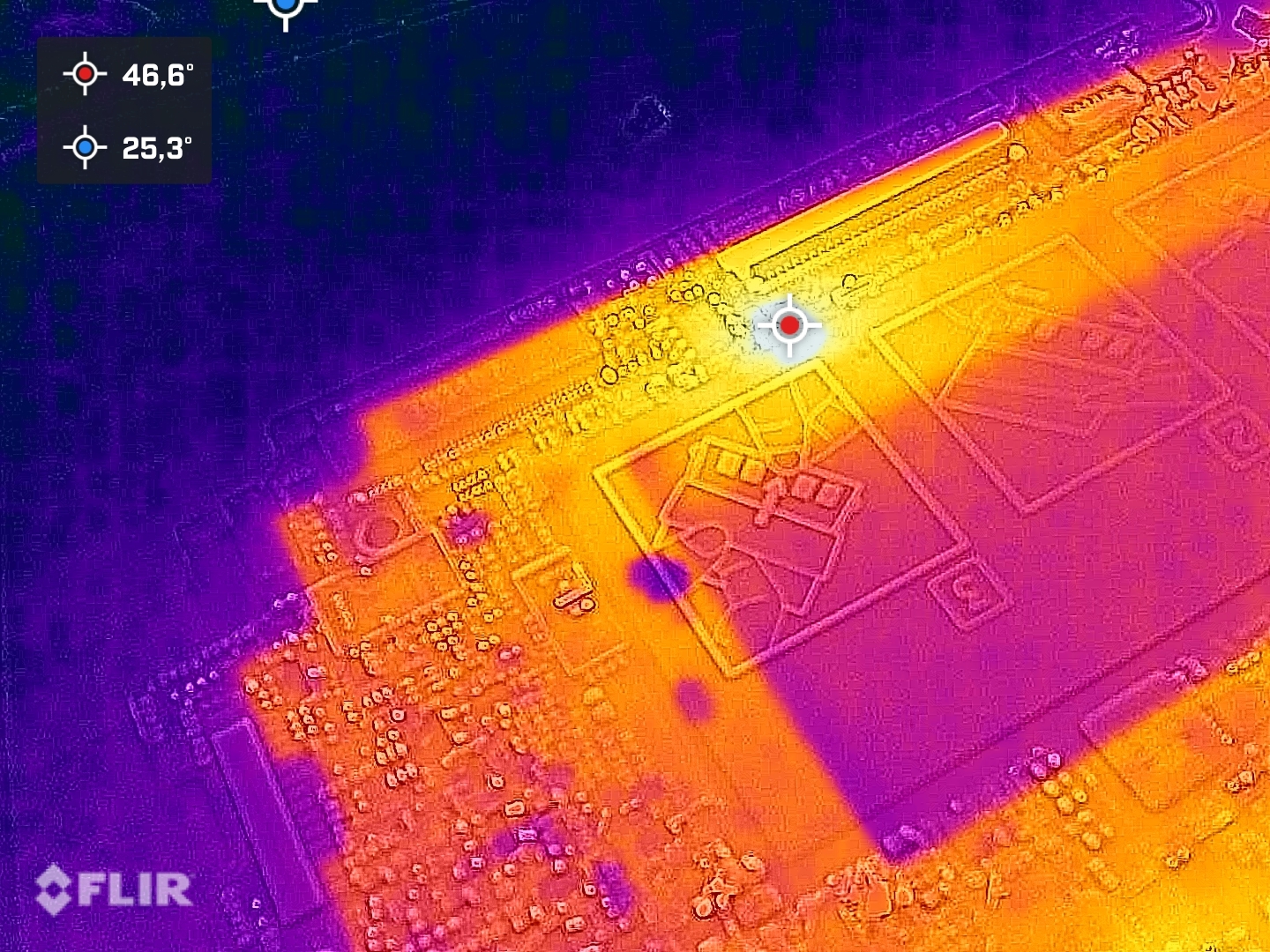

              So my thermal cam has a bit of an offset ghosting affect to so it looks as though the hotspot isn’t over the mosfet but it actually is.

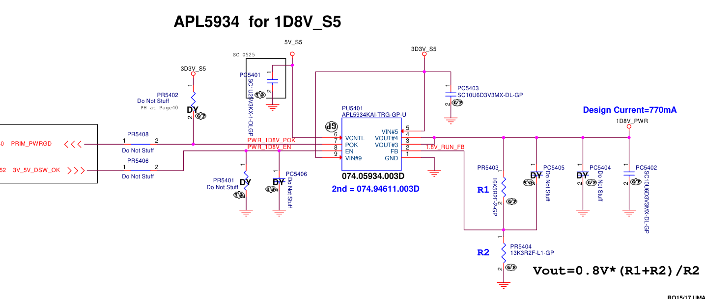

                Got the schematic for your board, it's actually the 1.8v supply, on your schematics its listed as APL5934 for 1D8V_S5
                2 things could cause it to get hot:
                1. The IC itself
                2. The output of the IC is shorted, may be PC5402, or something else in that rail

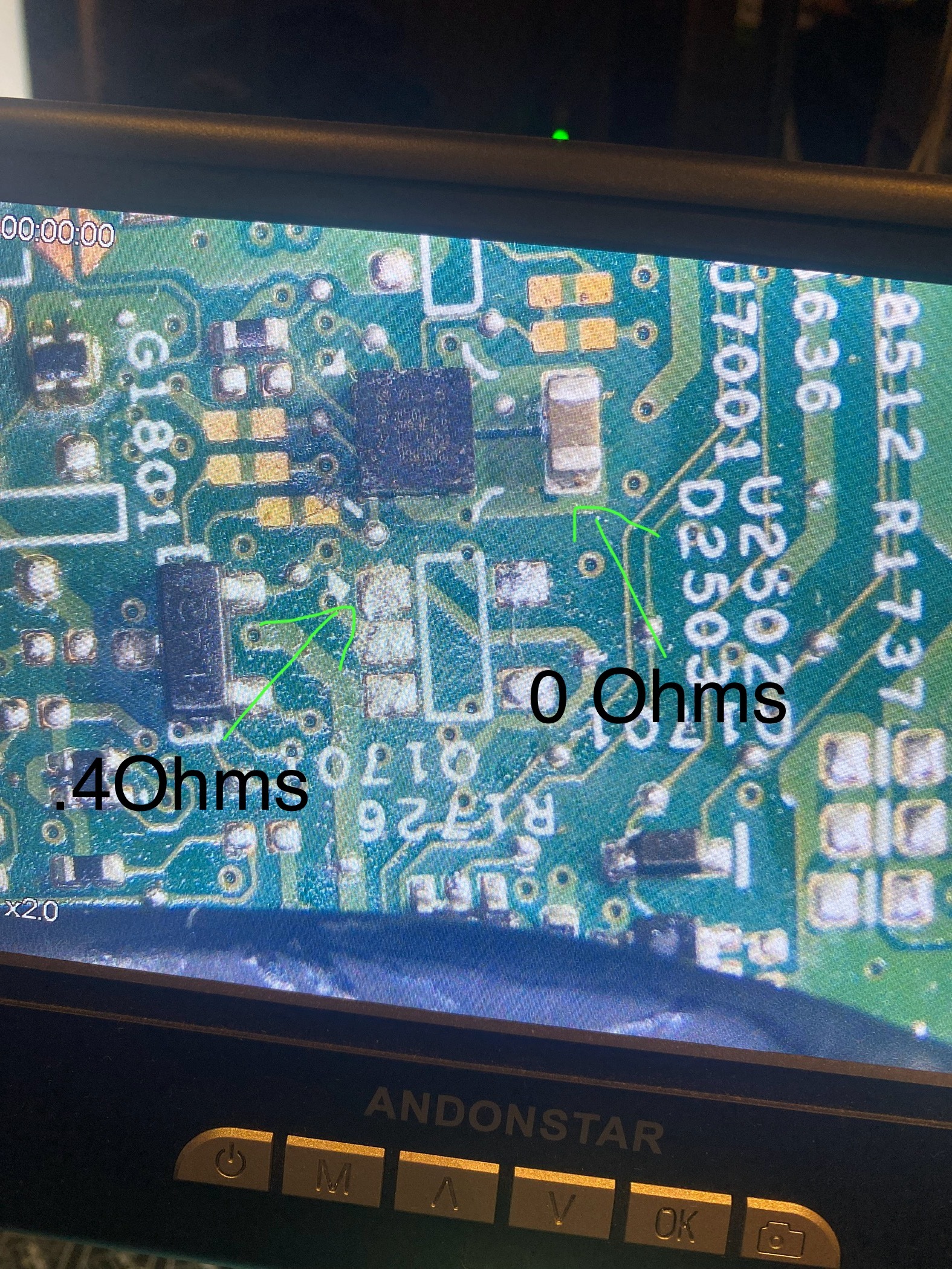

                            That is correct. USB load switch is off the board. Please see attached pic of measurements.
                            am I correct in saying this cap is likely the problem and needs to be replaced and the usb load switch is probably still ok?

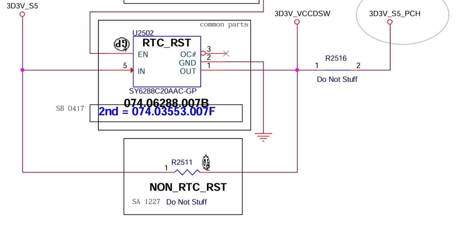

                              This IC is marked U2502 on the board, and Dell actually used it to switch 3.3v, I didn't notice the silkscreen at first, I just went from the marking on the IC
                              Schematics says that it's SY6288C, "Low Loss Power Distribution Switch", actually the same thing, same pinout as a USB load switch with a different name, and Dell used the other part (APL3553A) as a substitute
                              The output of that ic goes to 3D3V_VCCDSW, 3D3V_S5_PCH and 3D3V_VCCPRIM, search those names on the schematics
                              Click image for larger version  Name:	IMG_20250603_072520.jpg Views:	0 Size:	135.7 KB ID:	3651242
                              The cap you're pointing to is on 3D3V_S0, near U7001, maybe your thermal camera misled you?
                              Measure resistance on that "USB load switch" itself from Vin to GND to confirm it's shorted
                              Tip: to confirm where a short actually is, once you located the approximate hot spot with thermal camera, add a drop of isopropyl alcohol and visually check where it evaporates
