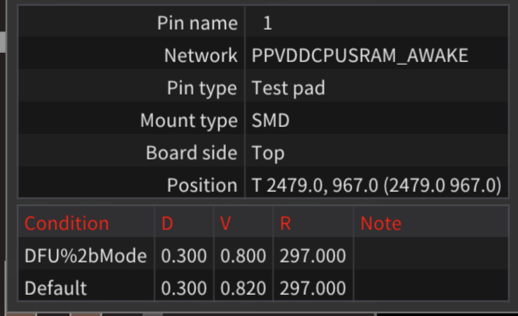

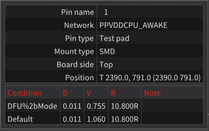

          Hey mon2 ! I'm back.
          So after replacing the 2 ISL mosfets, PPBUS is now fully back at 12.3. The issue is, board only draws 5,2v. When plugging the charger, small spike to 170mA for a fews seconds, then 70mA, and remains at that level, no matter how much time passes. Both USBC ports show the exact same readings. I tested some voltages, and 2 were no present at all, PMU_CLK32K_SOC and P5V3GS_EN.
          Otherwise every other line is present. I measured voltage readings that were lower than expected on those 2 lines (1st and 2nd picture) I basically got what OBData says is DFU mode voltage. The weird thing is nobody has put the laptop in DFU mode.
          is the T2's firmware just corrupt so do I try to put it back in its housing and to the keyboard combo, or is it dead, or is the PMU dead? Thanks

          • mon2
            • Dec 2019
            • 14725
            #45
            You are missing PMU_CLK32K_SOC? This clock is required. Review crystal @ Y8001 which is the base clock used by the PMU.
