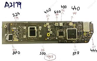

MacBook Air A2179 - shorted trackpad, PPBUS_G3H stuck at 1,1v.
  • Gueric
    • Feb 2025
    • 72
    • France
    Hello people !

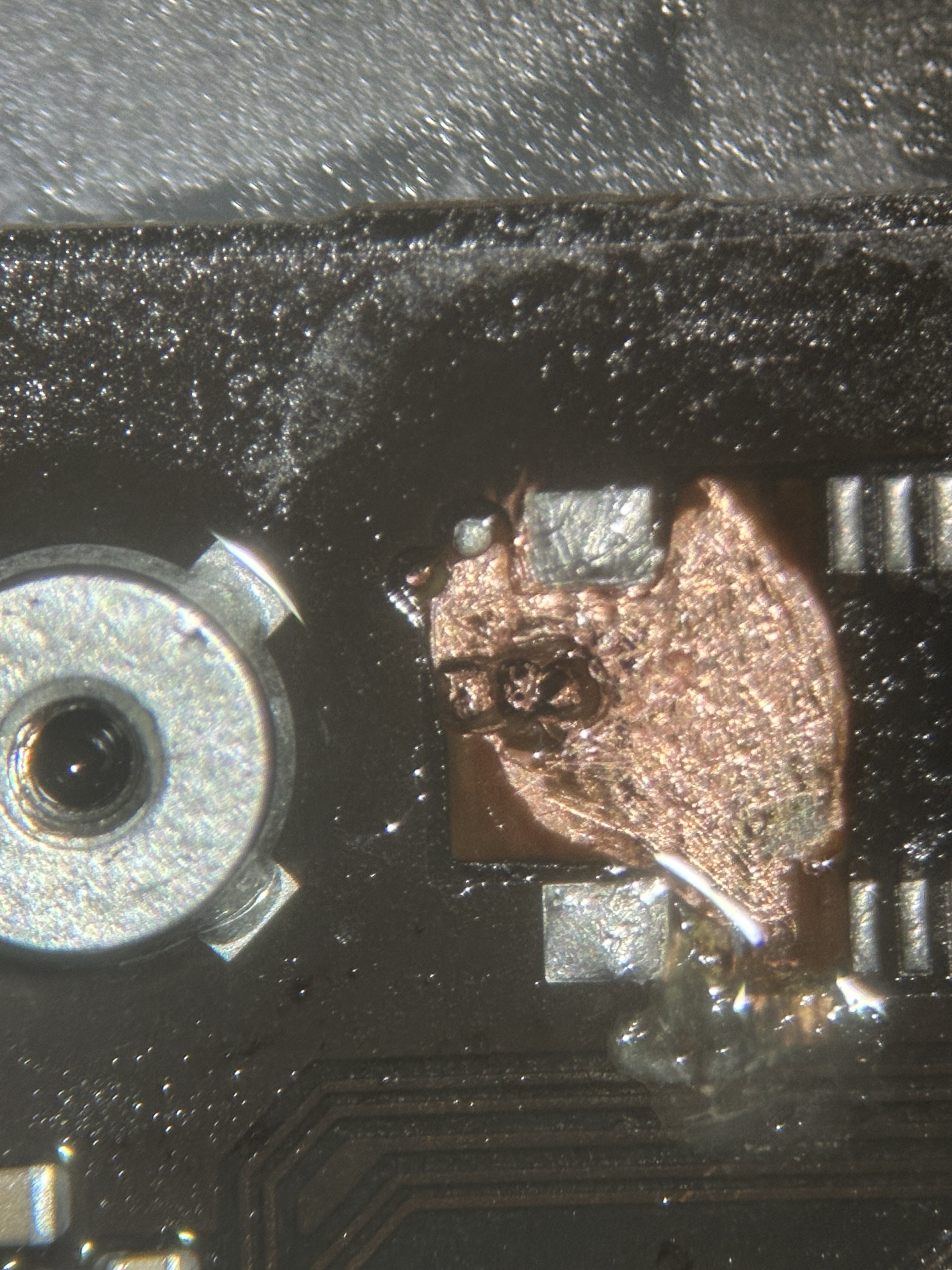

    I received an A2179 with a destroyed trackpad connector (all PPBUS_G3H_TPAD_FLT pads were destroyed). PPBUS_G3H was shorted to ground. I removed the trackpad connector, cleaned the area thoroughly, removed some bits of burnt copper, and short was gone. But PPBUS was stuck at 1,1v, even tho PPDCIN_G3H measured 5.2v So I replaced the 2 ISL's MOSFETs (Q7030, Q7040) in case they got killed by the short. Nothing changed.
    I then replaced the ISL, still nothing. measured all its pads, good. resistors around the chip are also good. resistance on PPBUS was good, diode reading was a bit high (.510 instead of .410) and resistance was perfect.
    Still nothing. absolutely no current draw, still 1v on PPBUS. so I removed the coil that connects PPBUS_G3H to these trackpad pads (PPBUS_G3H_TPAD_FLT), in case this mess was causing this, still nothing. I even replaced Q7680 and Q7660 just in case, absolutely nothing changed.
    I've included a picture of the connector.
    What should I do ? Maybe I've missed something? I'm out of ideas. Any help is appreciated.

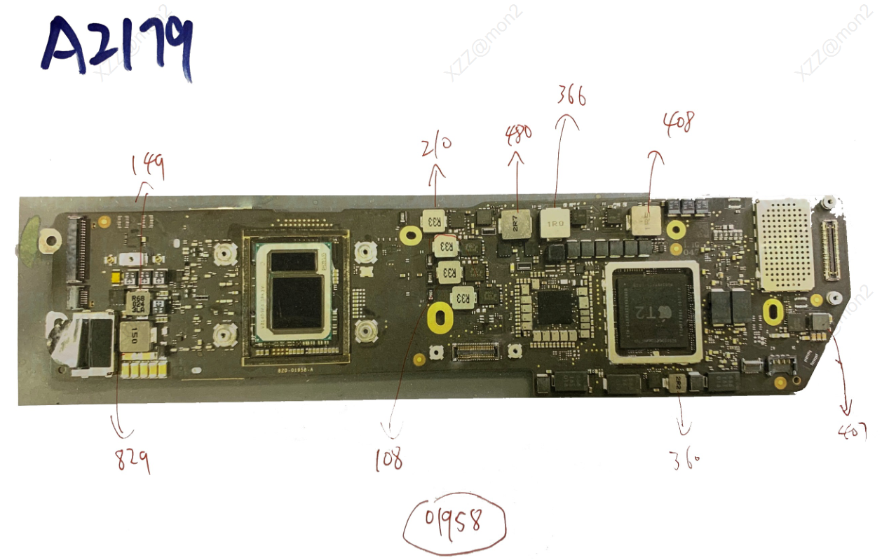

                    There are 2 versions of logic boards for the A2179. Which is yours?
                    820-01958 or 820-01055?
                    Check the diode mode measurements of all inductors onboard. See attached. No power to the board when testing in diode mode.
                    Red meter lead to ground.

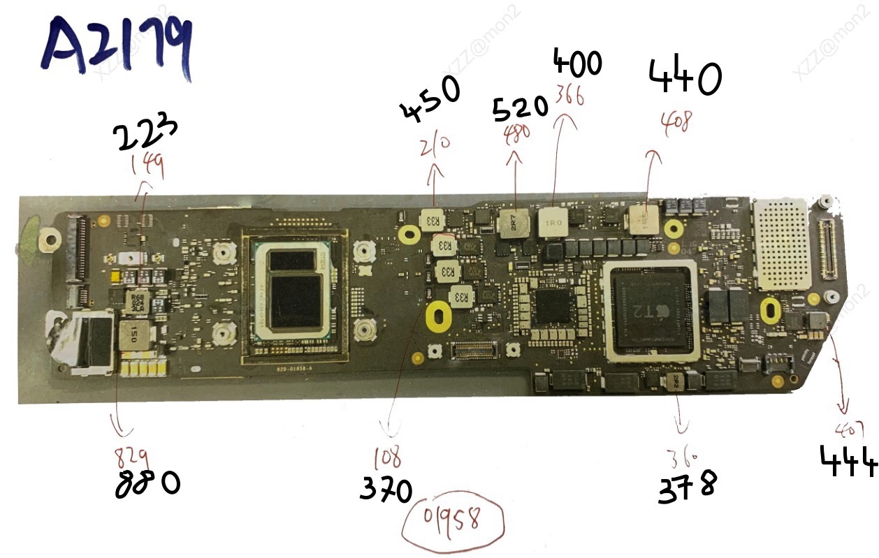

                    • Gueric
                      • Feb 2025
                      • 72
                      • France
                      Click image for larger version  Name:	Image.jpg Views:	0 Size:	188.3 KB ID:	3613052
                      Here is your picture with the measurements I just made. mon2
                      Also this board is a 820-01958
