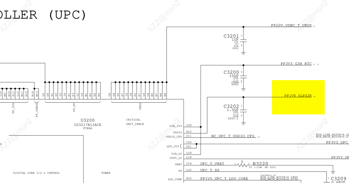

            PP1V8_SLPS2R: 0v. I think that's the culprit. diode mode from C7080: 0.430 resistance mode is at least 300Kohms.

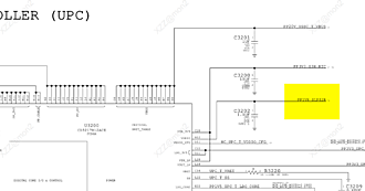

              So this rail is created by U3200. Measure the resistance to ground first to see if there is a short on this rail or not. If not, then U3200 is defective or not soldered correctly.

                  mon2 So as the resistance on the 1,8v line was fine, I decided to replace U3200 and now It went from 0v flat to a few milivolts, unstable. sometimes 10mv, sometimes 50mv. Is this bad soldering/bad chip or could it be something else? maybe the other CD3217 has to be replaced aswell?
                  Also I reflowed the ISL just in case, but at that point I replaced it twice already so I'm definitely sure the chip is not at fault. Also diode readings have improved on PPBUS after the CD3217 replacement and this reflow, going from .530 to .500

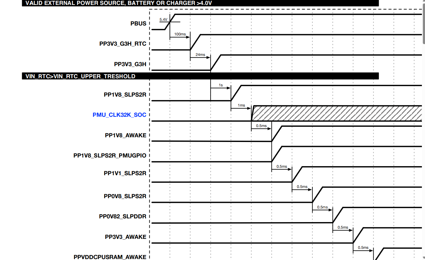

                    #29
                    https://logi.wiki/images/6/6a/820-01...iagram_LO2.pdf

                      #30
                      measured PMU_CLK32_SOC on a test pad. I'm getting 100mv.
                      PP1V8_SLPS2R: 20mv
                      PP1V8_AWAKE measures 0v.

                        #31
                        My bad, U7800 is creating the PP1V8_SLPS2R rail.
                        https://repair.wiki/w/MacBook_Air_A2...VG3S_EN_repair
                        Check the details for:
                        Check output voltages of U7800

                            #33
                            Confirm the first 3 primary rails in the power up sequence. The ISL9240 is a buck-boost regulator. When a stable 5v is present, the part should boost to ~12v. When 20v is negotiated by the CD321x PD controllers, then the ISL9240 will enter buck mode and lower the 20v to ~13v to operate the logic board. As a power up default, each PD controller must be able to pass a stable ~5v onto the logic board else something is wrong here.
