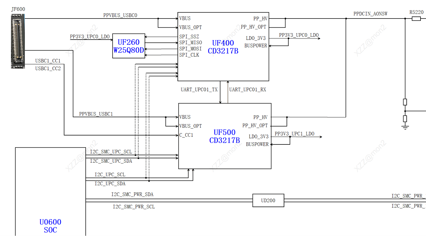

        Review the PD controllers (CD3217) and confirm each of their LDO rails. Only the active port will have the BMC power rail active but other power rails on the CD3217 must be present.
        Review the following voltage to ground measurements:
        (use UF400)
        * measure with care as the parts are SMALL!!!!
        PPVBUS_USBC0 @ CF401
        PP3V3_S2_UPC @ CF400
        PP3V3_UPC0_LDO @ CF408
        USBC0_3V3LDO_EN

          Charger conneced to the top port.
          PPVBUS_USBC0 - 0V
          PP3V3_UPC0_LDO - 3.3V
          USBC1_CC1 - 1.6V
          USBC1_CC2 - 0V
          PPVBUS_USBC1 - 5.1V
          PPDCIN_AONSW - 5.1V
          PP3V3_UPC1_LDO - 3.3V
          I2C_SMC_UPC_SCL - 1.2V
          I2C_SMC_UPC_SDA - 1.2V
          I2C_UPC_SCL - 1.2v
          I2C_UPC_SDA - 1.2v
          I2C_SMC_PWR_SDA - 1.2v
          I2C_SMC_PWR_SCL - 1.2v​
          • mon2
            • Dec 2019
            • 14740
            Looks good. Next, test the other port for similar measurements.
            This will confirm that PPVBUS_USBC0 = UF400 is ok (or not).
              Yes, everything the same. Ecxpt for the USBC1_CC1 is now zero and CC2 is now 1.6V.
              PPVBUS_USBC0 still zero.

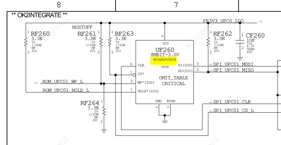

                                        The flash tools I linked earlier are for 4*3mm. This footprint is present on some current iMAC units and perhaps also on macbooks.
                                        Your UF260 is a 2*3mm footprint. The purple board I am fairly confident also supports this footprint but you must solder the flash to R/W the device. Suggest to purchase both zero force sockets as they will be useful. Purchase the 4*3mm and also the 2*3mm and some good tweezers to use the socket.
                                        The schematic is showing indeed a Winbond part @ UF260:
                                        So Winbond W25Q80DVUXIE will be suitable to use for your case + zeroforce or the purple solder type board to work with your programmer. The VCC for this flash is @ 3v3 so no issue to use with almost any programmer.
                                        Be sure to use the full part # before ordering.
                                        If you do not have a proper dump for this chip, post back and should be able to assist from my database of dumps. I believe they are also posted inside the dedicated bios forum.
