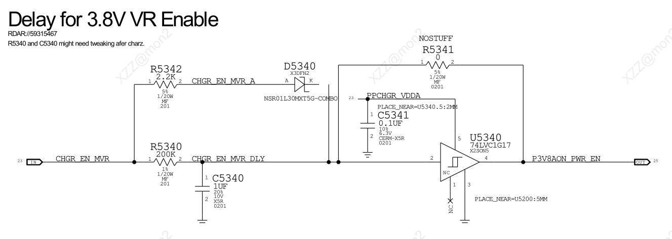

            Carefully measure the voltage to ground of P3V8AON_PWR_EN which is created by U5340.
            If this voltage is low, then carefully measure the voltage to ground of PPCHGR_VDDA as used by U5340 for its power. That is, we are checking if this buffer IC is being powered or not. You can measure on C5341 with a steady hand.
            If the chip is being powered, test the voltage to ground of C5340 (CHGR_EN_MVR_DLY).
            For these DC voltages, configure your meter to 10v or higher if you have a manual meter. If automatic, do not bother but configure for DC volts mode.
            Red meter probe to the point to test; black meter probe to ground (metal shield is ok). Be sure your meter probes are sharp enough to measure these tiny parts else stop till you have the proper probes.

              P3V8AON_PWR_EN = 5.118v (measurement taken from R5341)
              PPCHGR_VDDA = 5.117v (measurement taken from C5341)
              CHGR_EN_MVR_DLY = 5.015v (measurement taken from C5340)

                These are good measurements and means the logic board is attempting to enable this key power rail yet the power rail is low and is not shorted.

                PP3v8_AON_VDDMAIN low or missing
                • Check for a short to ground on PP3v8_AON_VDDMAIN (normal diode mode to ground reading ≈ 0.350).
                • If a short to ground is found, replace the shorted component.
                • Check the enable signal to U5700 (Figure 8), P3V8_PWR_EN, and address any issues with U5340 (Figure 9) or surrounding components.
                  • P3V8_PWR_EN is sourced from CHGR_EN_MVR from the ISL9240 (U5200) and passes through a delay switch (U5340) where it is outputted as P3V8_PWR_EN.
                  • If P3V8_PWR_EN is missing, check voltage on R5340 (CHGR_EN_MVR). If CHGR_EN_MVR is missing, replace U5200.
                  • If CHGR_EN_MVR is present, but P3V8_PWR_EN is missing, potential faults could include U5340, or surrounding traces/resistors.
                • Ensure VIN (PPBUS_AON) is making it to U5700; Occasionally a via or trace can break resulting in a voltage not making it to some parts of the board. PPBUS_AON can be measured adjacent to U5700, on C5704 or C5804.
                • If the above findings are negative, replace U5700

                    Ok so i did receive the U5700 replaced it and the short is gone.
                    PP3v8_AON_VDDMAIN = 0.358v on diode mode
                    P3V8AON_PWR_EN​ = i measured the R5710 and i do get 5.10v on both sides. so i believe that the signal does reach, correct?
                    PPBUS_AON = 11.9v (measurement taken from C5804) is that the correct voltage?
