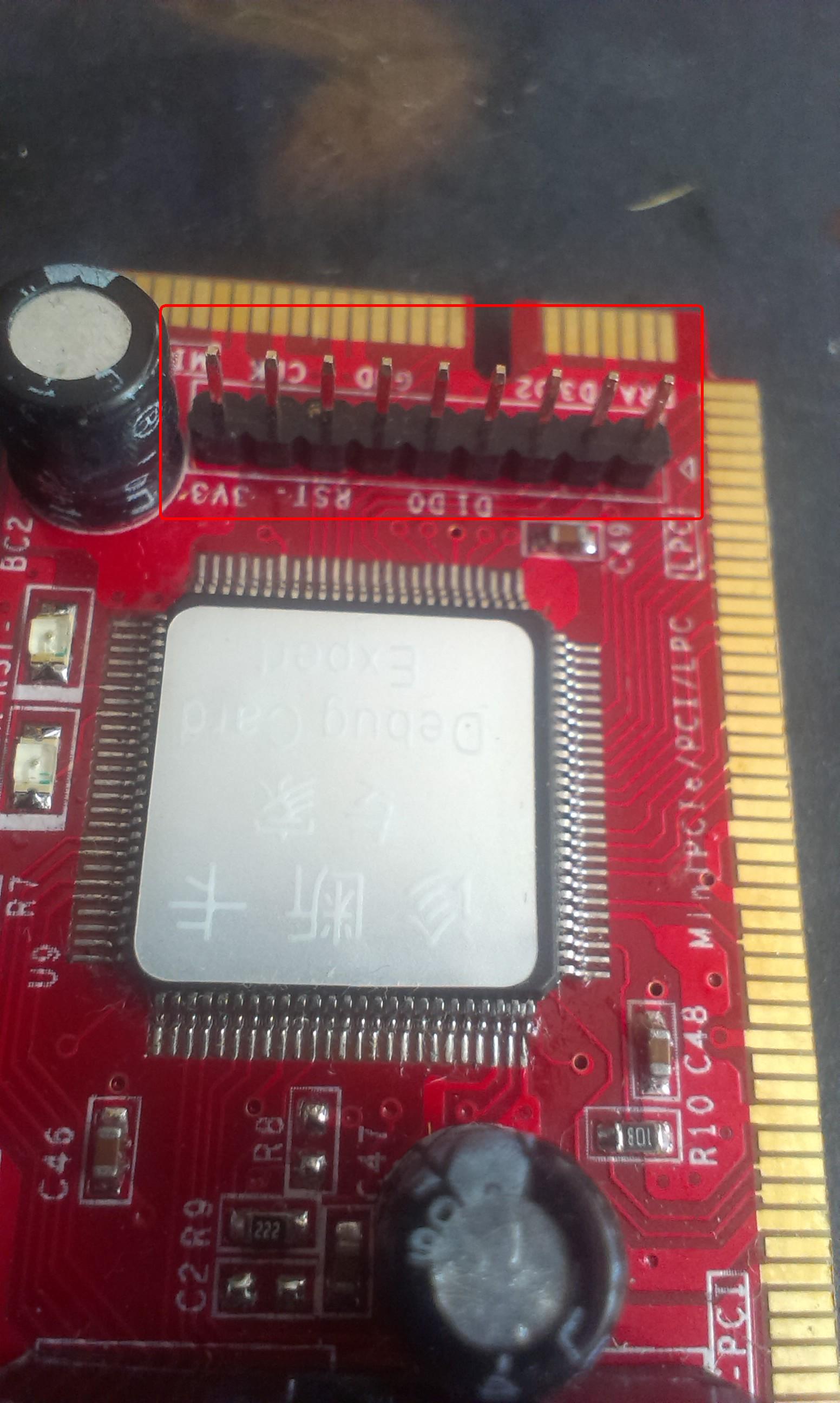

    Hello.
    I buy two post cards for diagnostic boards when all voltages and pwsignals is working but have blacck screen. One 5$ shit and Debug king post card, but they uset to be nearly unusefull. Have anybody some better cards or other diagnostic methods when board is starting but no video??

    Debug cards only work when the mainboard has routed the LPC bus thru to the wifi card slot. This is not a requirement, it is optional in the specs, so it's up to the manufacturer to do it. Generally i've noticed that HPs all seem to have it, other manufacturers, less so. The bus is always exposed somewhere on the motherboard but you'll have to solder wires.
    In most cases it still boils down to voltage measurements. Or if you have a fancy digital scope...

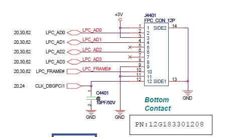

      i was sad about not working cards and now i look to the schematic for laptop and found debug connector. Im gonna make some wiring and wish me luck :-)

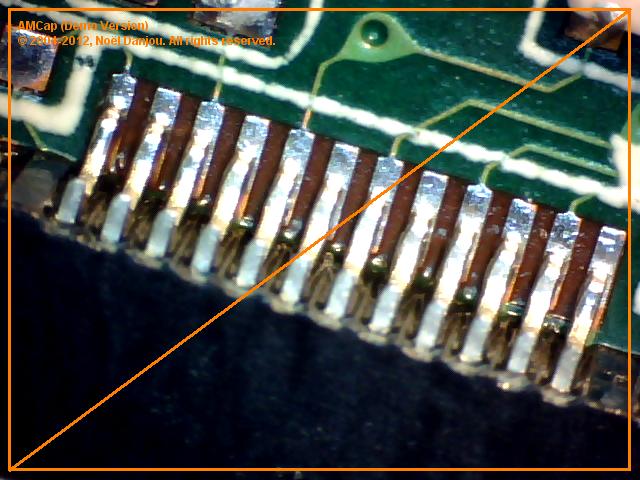

        this work sucks. no connector on board and sooo tiny 14 pins that must have soldered connector and attach flex with stripped wires. lot of work.

          LPC bus is only 7 wires.

            use kynar wire.
            if you need REALLY small wire, use enamel covered copper wire by unwinding a small transformer.

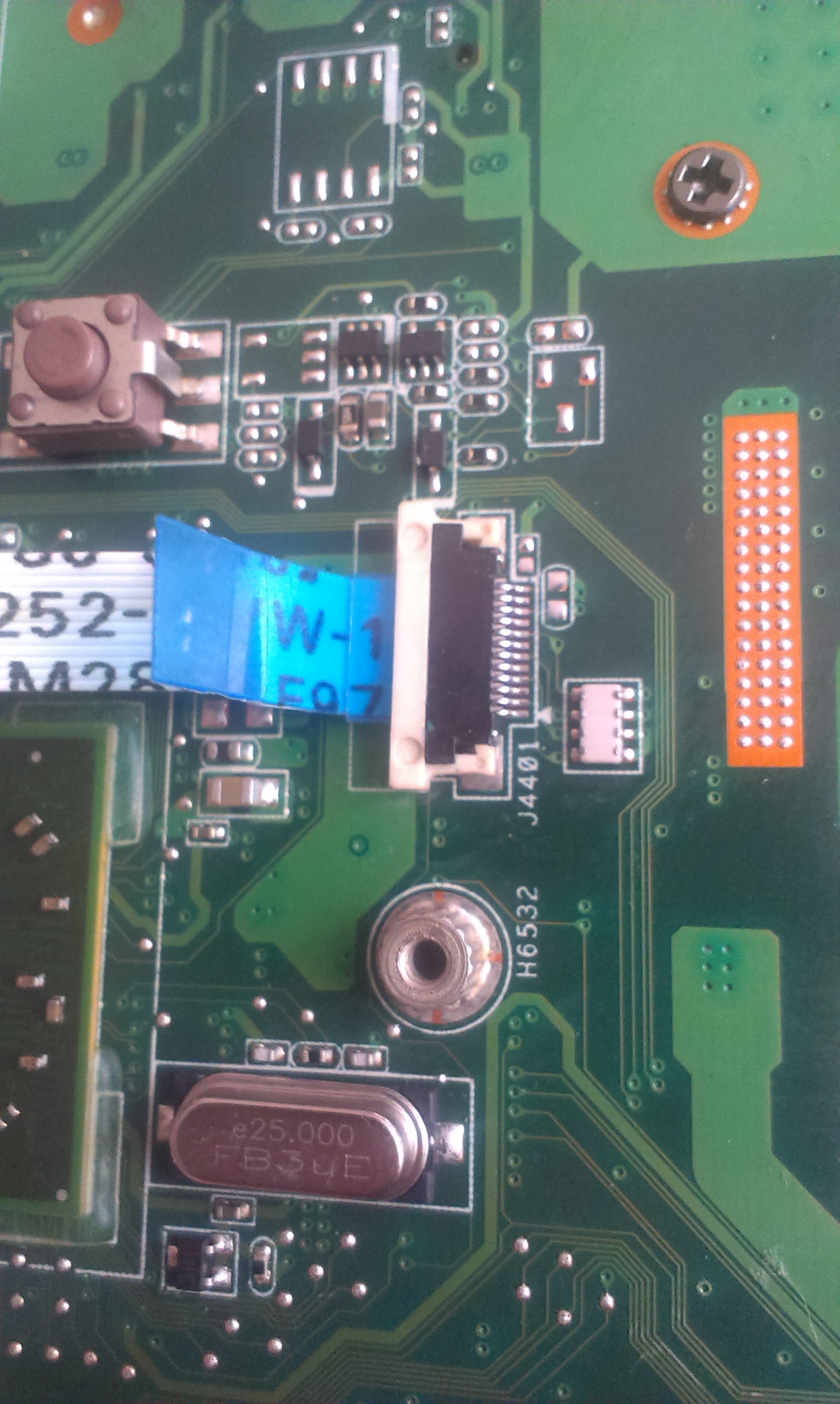

                1 image - asus f5z - no connector
                2 image - dr4ag soldering works good
                3 image - attached flax and strip wires
                4 image - schematic of LPC connector

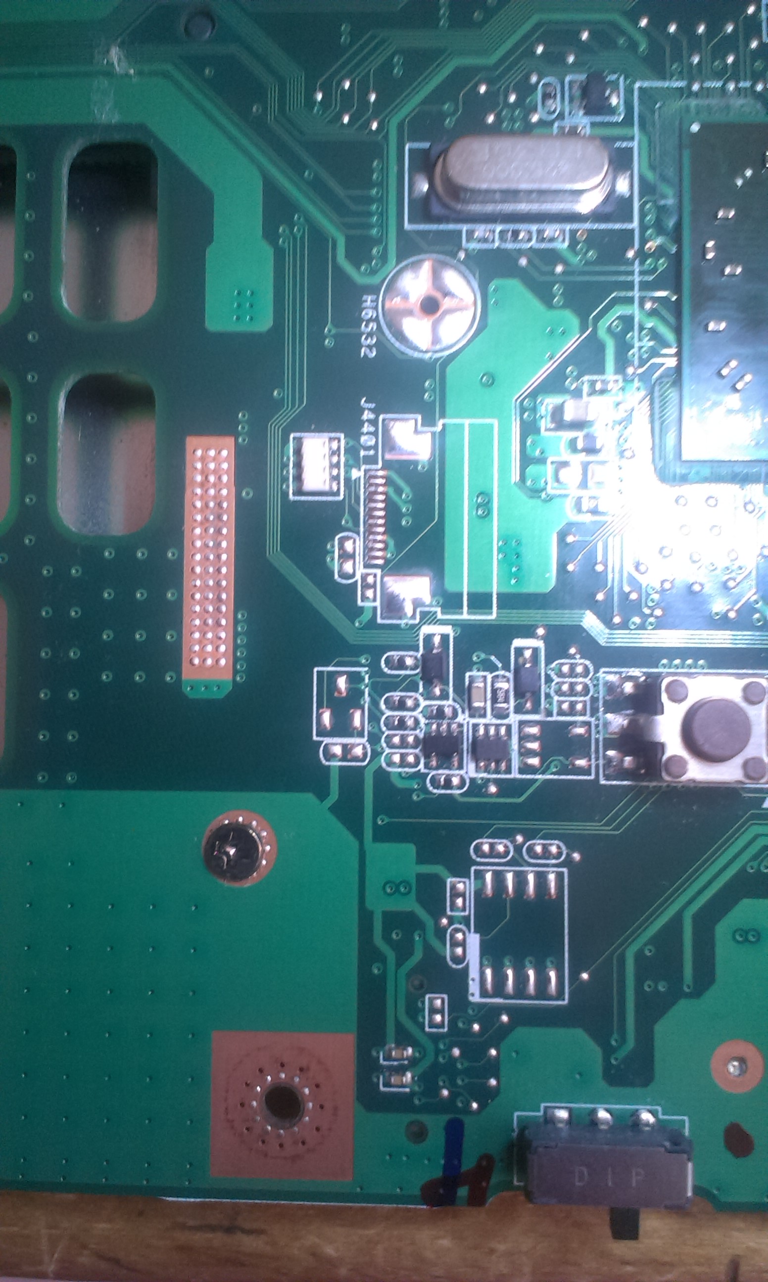

                5 image - Anybody know where i can find connector to this slot?

                  Re: bios post cards or other fault diagnostic methods
                  Steal a mini-PCIE from a dead board.

                    i mean the LPC port/picture edited/
                    went to the best local parts store but they will have it about week

                      It seams we have the same POST card. I used mine connected to LPC debug points but i get it working only when i press power on button, then i get only clk and 3,3V signals. This card works OK when connected to PCI slot only.

                            Telling the truth, i didn't manage to see any difference. Why don't you put it to wifi slot for testing? It has mini pci-e port on every laptop.

                              ofcourse i put it to minipcie port but it seems that noone board is supported.
                              ELPC port have only asus
