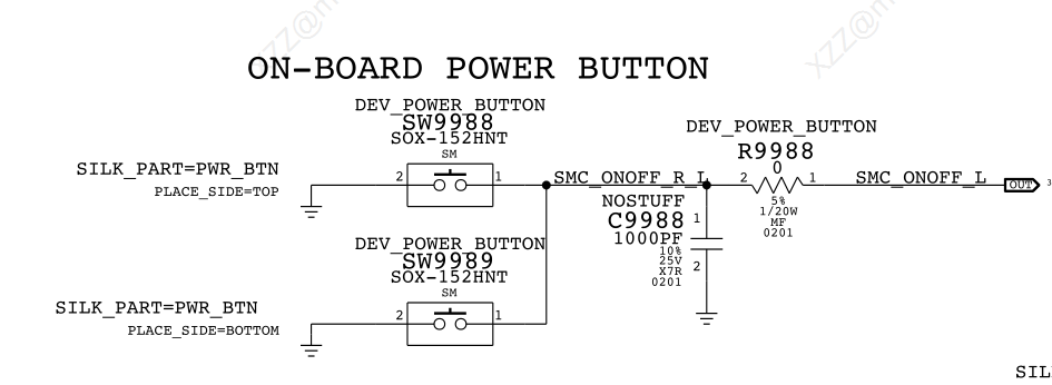

                                • mon2
                                  • Dec 2019
                                  • 14677
                                  #36
                                  Trigger button = on/off button?
                                  See attached. Locate the shorting PCB pads that are present on all macbook models. One pair of pads on one side of the board; another pair of pads on the other side.
                                  In the absence of a keyboard, you can use metal tweezers to emulate the power button. If you (carefully) use tweezers on these pcb pads, can you power the board on/off?
                                  Have you tested with an external screen as per suggesting in post #33? What was the result?
                                  • phantomEVO
                                    • Mar 2013
                                    • 509
                                    #37
                                    yes trigger button is working....but i cant try to boot with battery only, because it is dead. i've ordered another one just in case.
