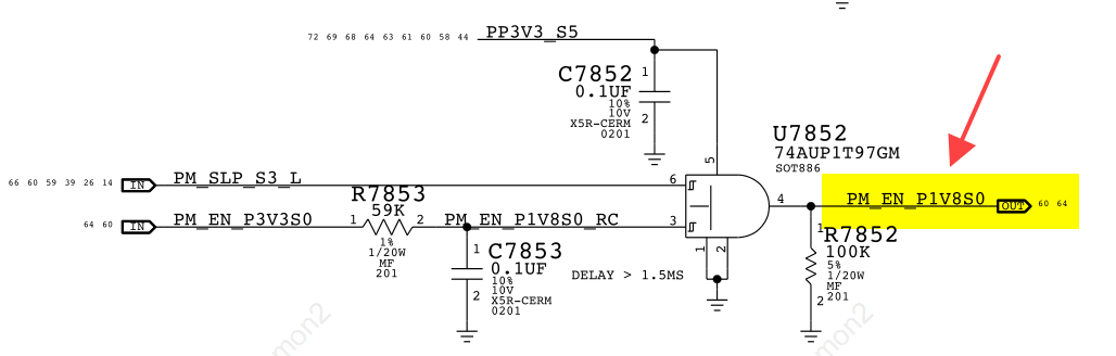

                          Ok. Confirm (without power) that the resistor @ R7072 is present on the board. Confirm the resistance of this part is ~1k ohms. Confirm that you have the same incorrect voltage @ R7072, pin #1.
                          re: your post # 7 - yes, you do have this in the design.
                          Label is PM_EN_P1V8S0.
                          Click image for larger version  Name:	PM_EN_P1V8S0.png Views:	0 Size:	55.2 KB ID:	3592434

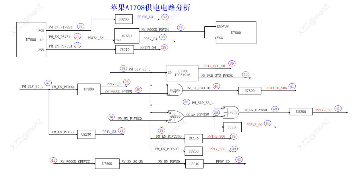

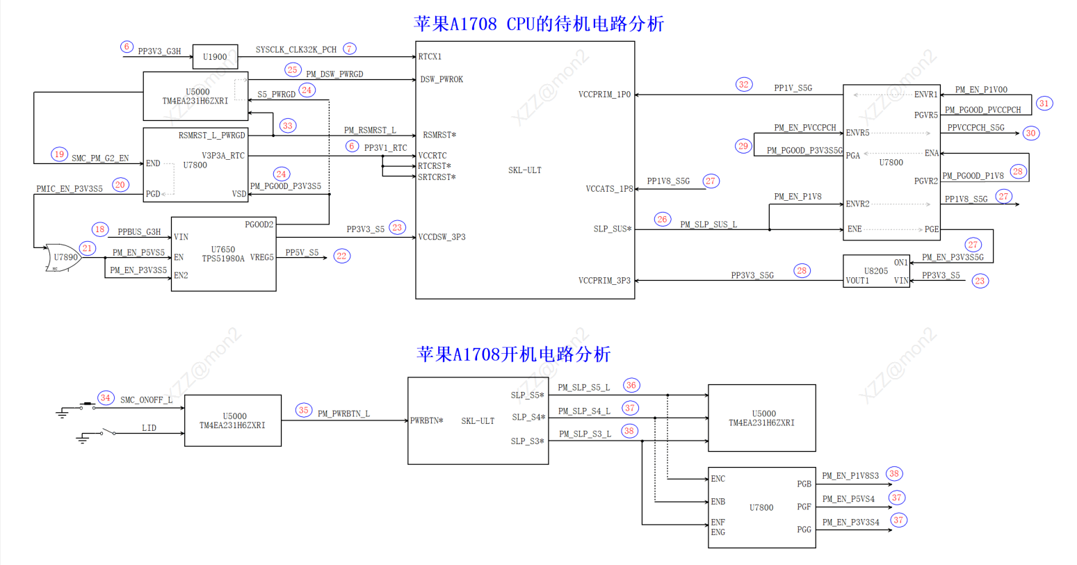

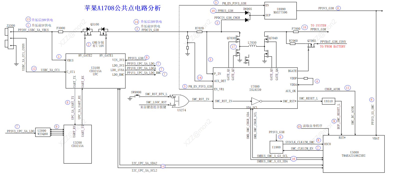

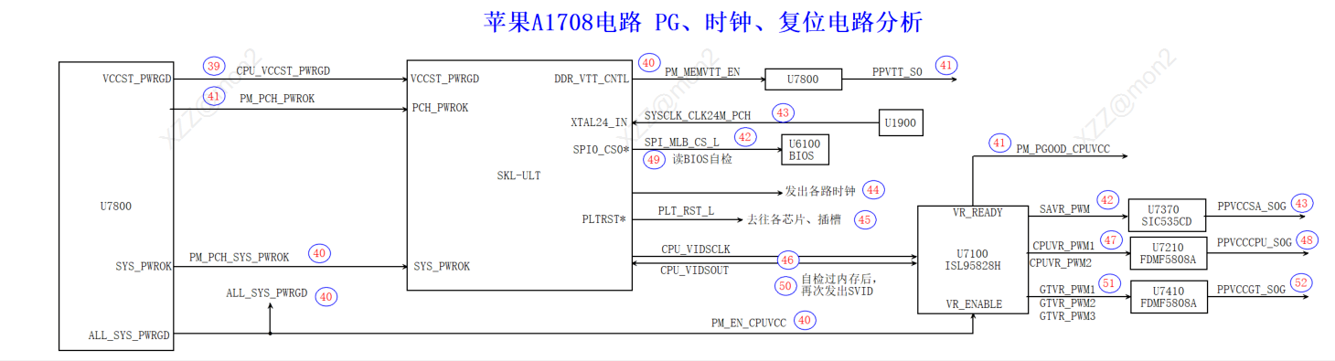

                                    The numbers inside each circle indicate the order of the sequencing performed by this board. Starting with (1) - the 5 volt rail is supplied by the power adapter, etc. You will need to review each step to determine at which point the board stops to boot. From your posted videos, the board is power cycling. You reach ~500mA and then power cycle.
                                    You can review the board with a thermal camera to determine if you have a shorted part that is forcing an excessive current draw - perhaps even a shorted capacitor.
                                    You can do the same by removing all power -> measure the resistance to ground of each power inductor. Each inductor is linked to a power rail. If there is a shorted part, the local regulator will power down that rail.
                                    Perhaps an issue with the local bios.
                                    Perhaps a missing part on a local current sense loop circuit which will force the local rail to power down again.
                                    The posted diagrams will also help.
