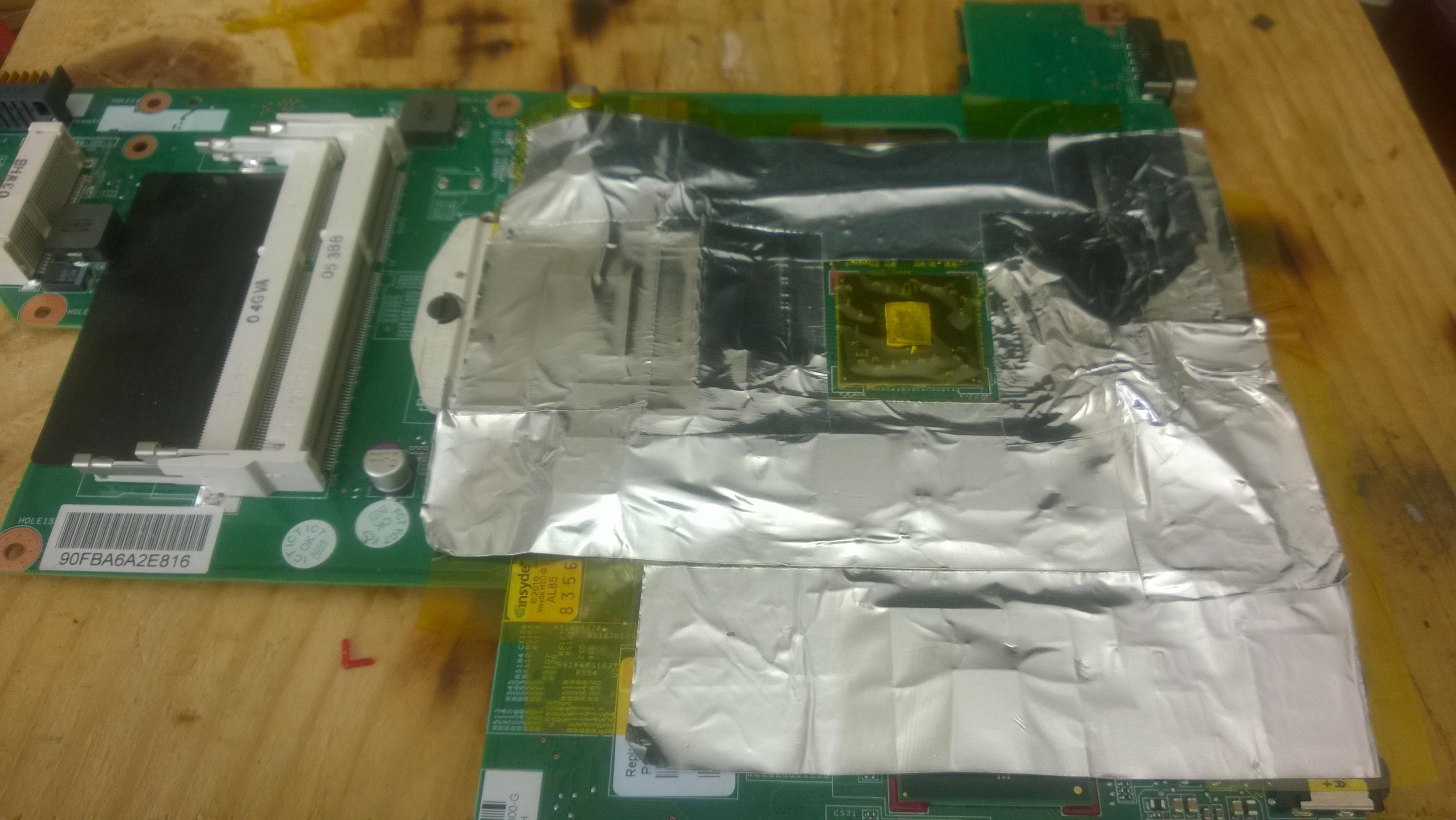

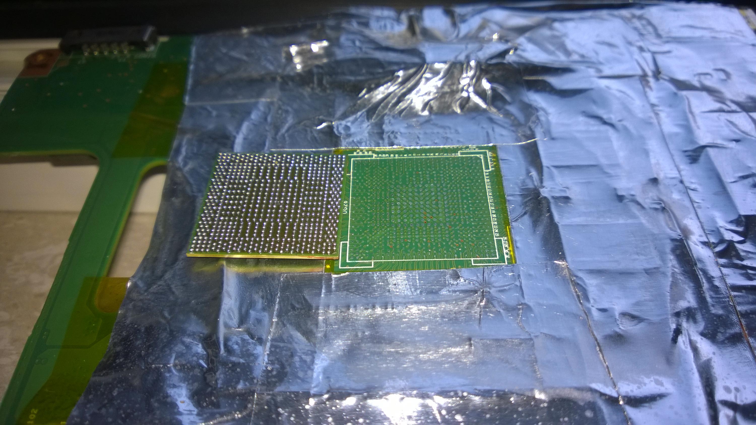

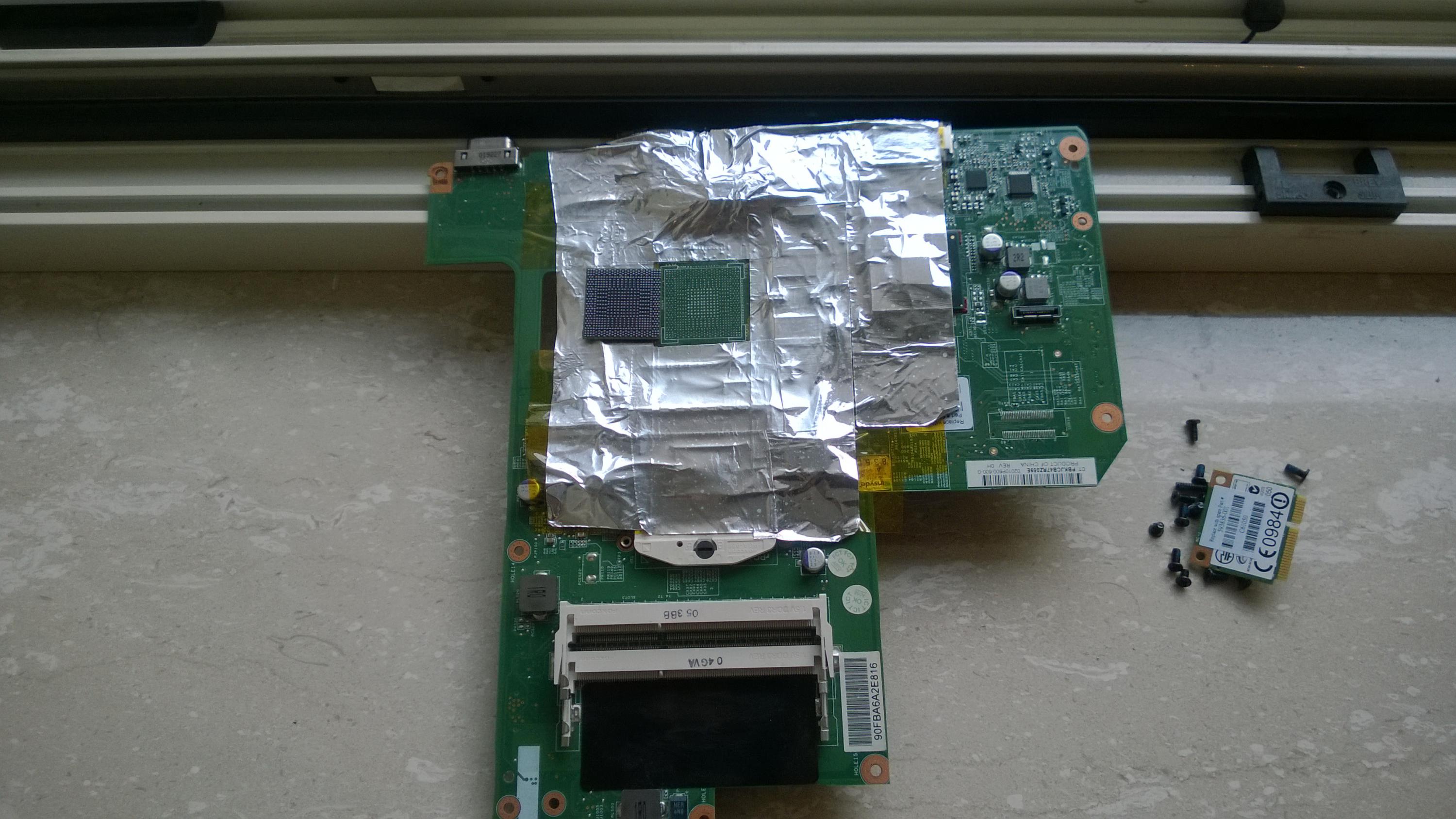

                            i did one today ( chip is 2010 )
                            note the kapton over the chip
