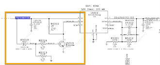

        Review U5660.
        Is the PP3V3_UPC5_LDO stable directly on the SPI flash? Also PP3V3_UPC0_LDO on UF260 stable?
        Review each resistor in the path from this flash to the PD controllers. Having 20v is a good start but perhaps the firmware is corrupt and causing this power cycling.
        U5500 - PP3V3_SW_ACE5 - 3.16V problem?
        UF400/UF500/UG400 - PP3V3_S2 - 3.16V problem?
        To me, yes. What is the exact resistance to ground on each rail? This should be ~3v3.
        Update:

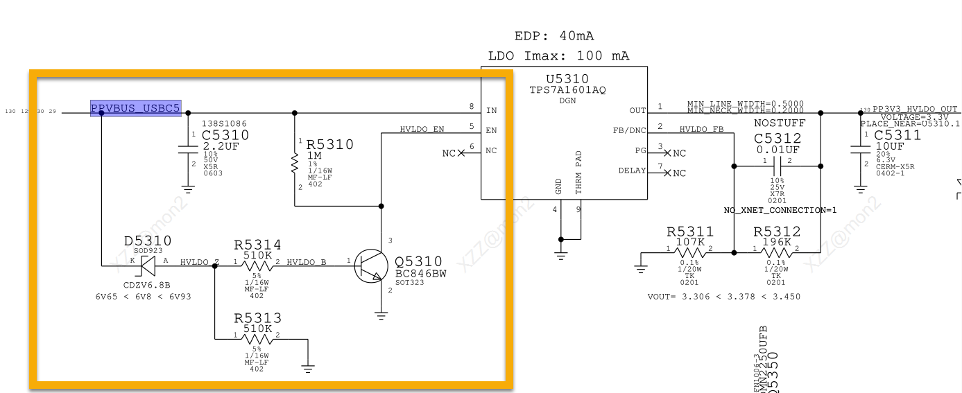

        Do you have a thermal camera? Review the device @ U5310. Also test the diode @ D5311.
        Confirm the input voltage is stable for PPVBUS_USBC5. Respectively, the enable pin for this low current LDO should be as well for HVLDO_EN.
        Finally, the output should be stable but the part is from TI so is a suspect by vendor name. This part may be defective as the power delivery controllers appear to be working since they are negotiating the 20V PD contract.

            U5310 Looks clean.
            Pin 5 of U5310 - HVLDO_EN - .075V then drop to 0.00V when the board cycles.
            D5311 is .5V on Pin 1 (Left side) and 3.16 on Pin 2 (left side)
            D5311 - Diode Mode across the chip is .113V (no power plugged into the board)
            Res to ground of Pin 1 is 110 Kohms - and Pin 2 is 22 Kohms
            Measuring PPVBUS_USBC5. at D5401 - Pin 2 is 0.00V and Pin 1 is .78-.81 similar to Pin 5 of U5310

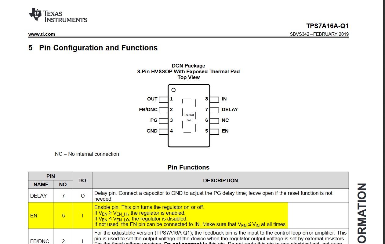

                        Something is wrong here. With these voltages, the LDO is not being enabled.
                        Is the voltage of PPVBUS_USBC5 stable? Check each and every component that are linked to this enable pin. When you have the IN voltage, the EN pin should also be a logic '1' = high to enable this LDO.
                        See attached.
                        Click image for larger version  Name:	LDO.png Views:	0 Size:	76.0 KB ID:	3571044
                        Click image for larger version  Name:	enable.png Views:	0 Size:	115.2 KB ID:	3571045

                          Measuring at C5310 for PPVBUS_USBC5
                          Powering the board with USB-C Charger (At ALL 3 locations)
                          - .08V - 0.00V cycling
                          Powering the board with MagSafe 3 @ J5401
                          - 20V then drops to 5V cycling back

                                If you use the MAGSAFE 3 adapter, what voltage do you see on the EN pin #5 of U5310? Does this pin ever go to a logic '1'?

                                      Pin 5 on U5310 when on Mag power is at 4.7V then drops when it cycles.
