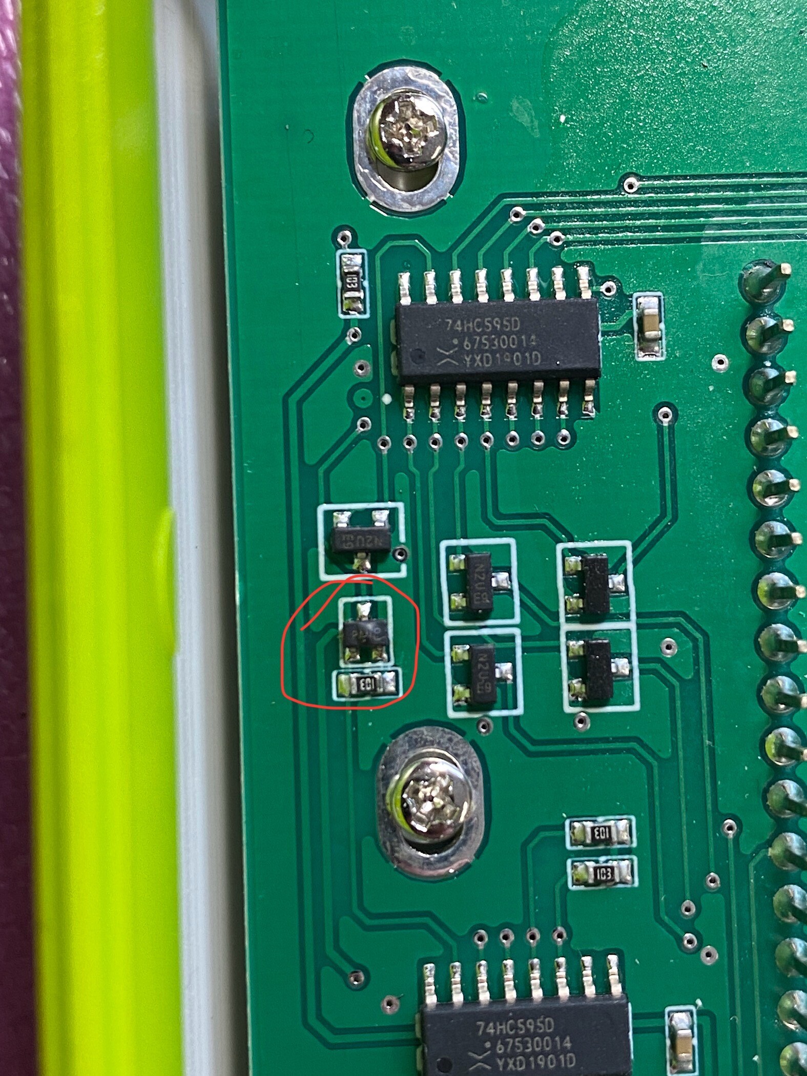

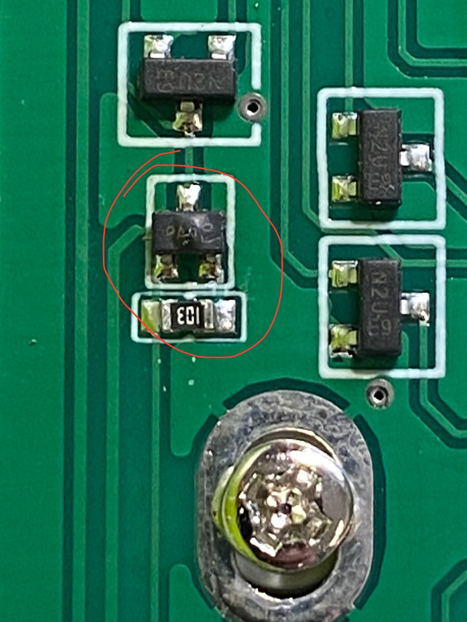

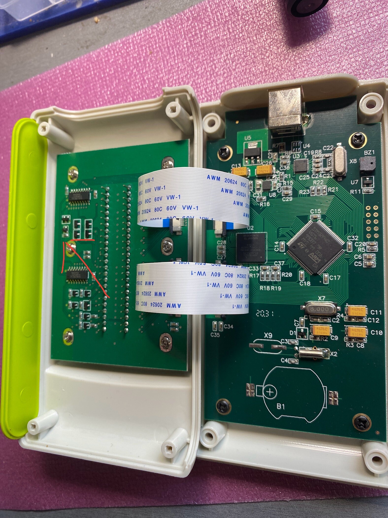

    Hello. Can anyone identify this burned component on Svod3? Thanks.

    Pour IPA (alcohol) onto the top surface and take another pic before the IPA evaporates. The liquid will magnify the SMD topside markings.
    On this note, what markings do you read on this component? Also suggest to reach out to the vendor / mfr of this tool. This part was damaged due to some reason and they will have full knowledge of the fault and bill of materials. Share what you see on this part.

        I damaged mine a few years back. These were the components I ordered at the time.
        PA1 (DMG1013UW)
        NH2 (DMN2300U)
        NG4P (TPD4E1U06DBVR)
        SVOD developers usually don't respond but you can try them in the SVOD3 forum if you come up blank.
