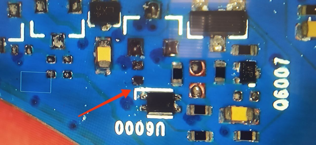

    #41
    So U6000 is the ovp device that may have triggered.
    What is the voltage to ground of the removed resistor, pin #2? Measure the voltage at the pcb pad.

      #42
      pin #2 of the resistor has 0.009 V

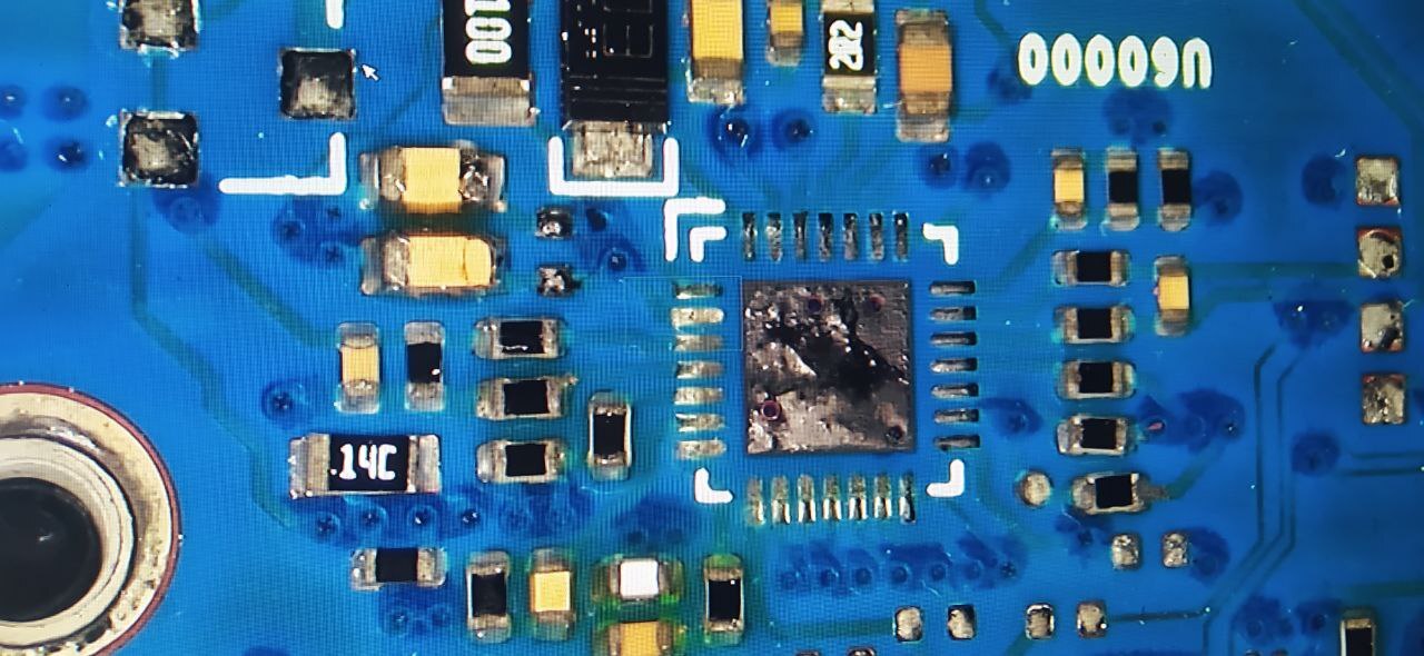

                    Originally posted by mon2
                    Unbelievable. With the current sense resistor (and this removed cap) off the board, what is the resistance between pin #1 and #2 on the charger IC?
                    10.87M ohm

                      #50
                      Test the resistance between these referenced points (PVBAT) to ACN. Do they appear as a short?

                          #52
                          Suggest to remove the charger IC off the board to confirm if there is an external leak or is it that this charger IC is linked to this mystery voltage. If the current sense resistor is removed, you should have 0v on ACN.

                            #53
                            With Charger IC and sense resistor removed from the board, i always have 4.3 volt on ACN

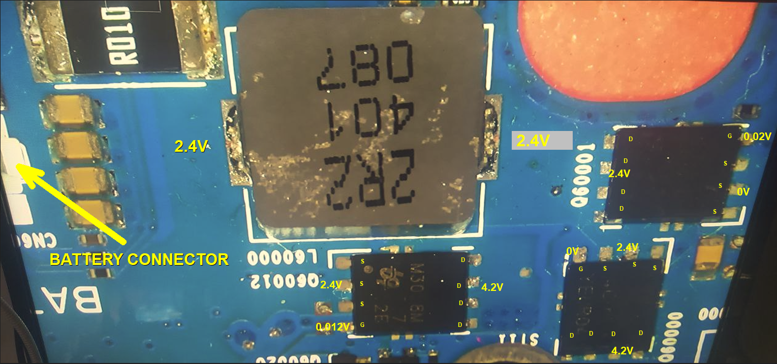

                              #54
                              Test if this voltage is present on each inductor on the board. Also test if you see this voltage on any of the mosfets linked to the battery charger. A p-channel mosfet will enable under these conditions.

                                #55
                                the voltage is absent on each inductor except the one that charges the battery. I write the voltages in a photo. I don't see any p-channel mosfets, they are all n-channel. See boardview
                                these 2.4 volts, with time (a few minutes), drop to 0.8v
                                all these values are strange since the n-channel gates are at 0V (board without sense resistor and bq24800)

                                  #56
                                  Flux and remove the 2 mosfets that are showing the 4v2 measurement. Test again. Does the 4v2 on ACN halt?
                                  PS: This board needs an exorcism.

                                    #57
                                    maybe an "avada kedavra"🤣
                                    same story.....4.3 present
                                    is it normal to have prochot# at 0v on bq? something releted to absence of original charger??
