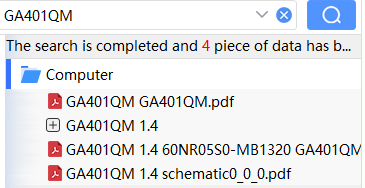

    I have the same database (paid) for schematics as you, search GA401QM page 92

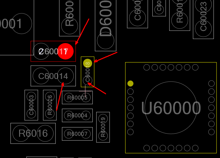

        Remove all power. Meter in resistance mode. Measure the resistance between pins # 1 and #2 on the charger IC. What is the resistance in ohms (with the current sense resistor onboard)? Measure directly on the charger IC contacts.
        • zaurus81
          • Feb 2021
          • 67
          • Italy
          0.9 Ohm (resistance between red probe and black probe 0.4 Ohm )
          • mon2
            • Dec 2019
            • 14691
            On your board, do you see any resistors between pins #1 and #2 - other than the current sense resistor? What are the markings on the current sense resistor? Is this current sense resistor the original that was onboard?
            The current sense resistor, to me, appears to be quite high @ 0.5 ohms = 500 milli-ohms (assuming there are no other resistors in this path).

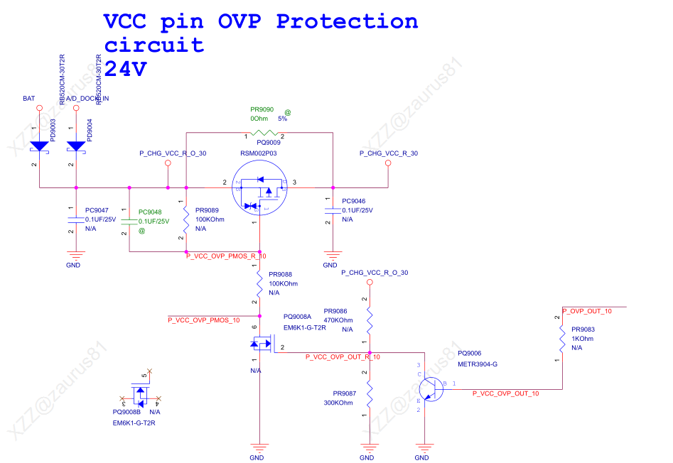

                              He found a problem on OVP voltage protection ciurcuit, which drive to ground the gates of ACFET and RBFET (ACDRV). My circuit is a little different and i dont have schematic....only boardview. Could I please use your knowledge to study the above circuit?

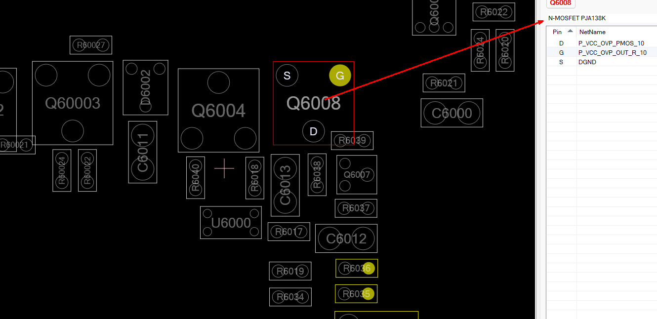

                                Flux and remove Q6008 off the logic board. Test again without this P-channel mosfet. Do not lose this part.
                                • zaurus81
                                  • Feb 2021
                                  • 67
                                  • Italy

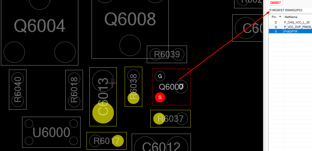

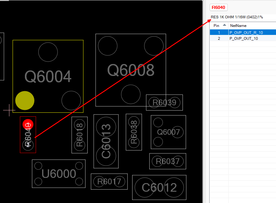

                                  #36
                                  bordview says Q6008 is an n channel.
                                  maybe it's Q6007

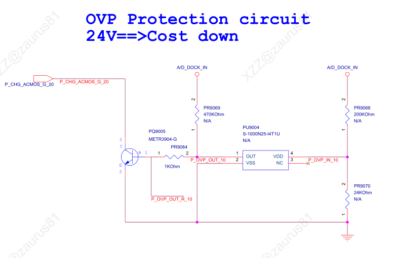

                                    Good point. Flux and remove Q6004. I have a theory, just a theory that if we flux and remove all parts off the board, this mystery voltage will disappear. For now, let us start with Q6004.

                                        Hunt for the resistor that is mated with the base pin of the removed transistor. Is the resistor value like your posted partial schematic?
                                        If yes, carefully flux and remove this resistor since it is being driven by the ovp circuit and may be may be impacting the shutdown crowbar circuit. Do not lose these parts. Each is linked to the ovp circuit (over voltage protection).

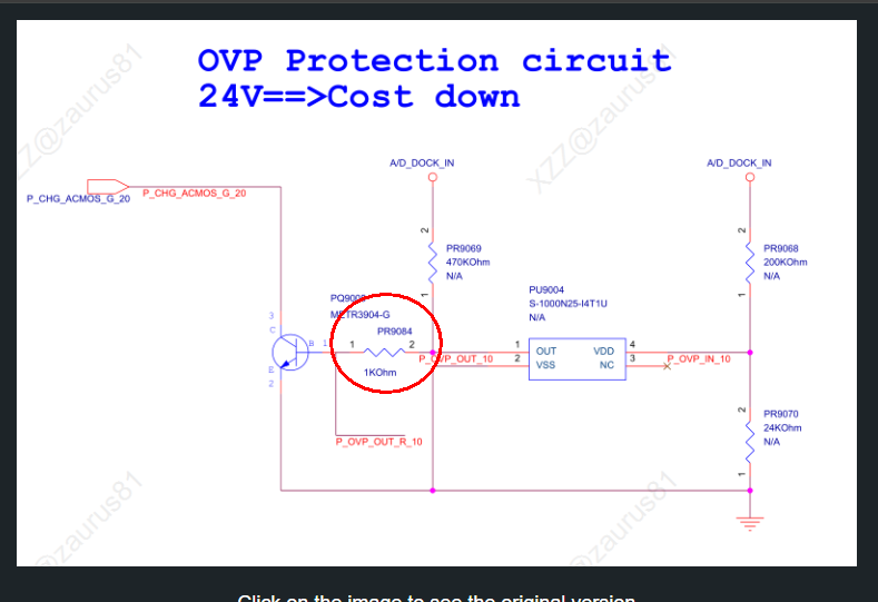

                                          Resistor (R6040) mated with the base pin of the removed transistor (Q6004) has a value of 1K (tested with multimeter), this value matches the one reported on boardview and on partial schematic.
                                          with transistor and resistor out of the board i have 4.3 volt on main power line.
