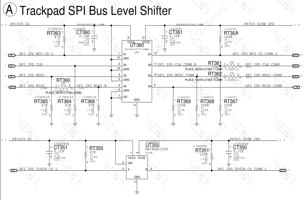

            Review the details of the level shifter used by the trackpad interface @ UT360. This part may be defective if you are measuring 0v on each SPI pin.

                Confirm the VCCA and VCCB power rails on the SPI level shifter.
                Confirm the resistance to ground of MISO and CLK of the SPI lines. You may also do the same in diode mode (red meter probe to ground; black meter probe to point to test; no power to the board).

                      Next step: replacing UT350 – I read on other forums that a short on UT360 can also damage UT320 and UT350. My measurements on UT350 show that it's working fine, but I'll probably replace it anyway, just in case. I don't expect this to fix the issue, but I'll do it as a precaution.
                      Let me know if you have any other ideas. Thanks!

                          Hi, just would like to thank you for the information, just had a A2681 with the same anomaly. UT350 was sending 3.25V, but was causing anomalies with the trackpad, after replacement trackpad has worked OK.
                          BTW PP3V3_S2SW_IPD should have about 7kohm. thats how I found the culprit.
