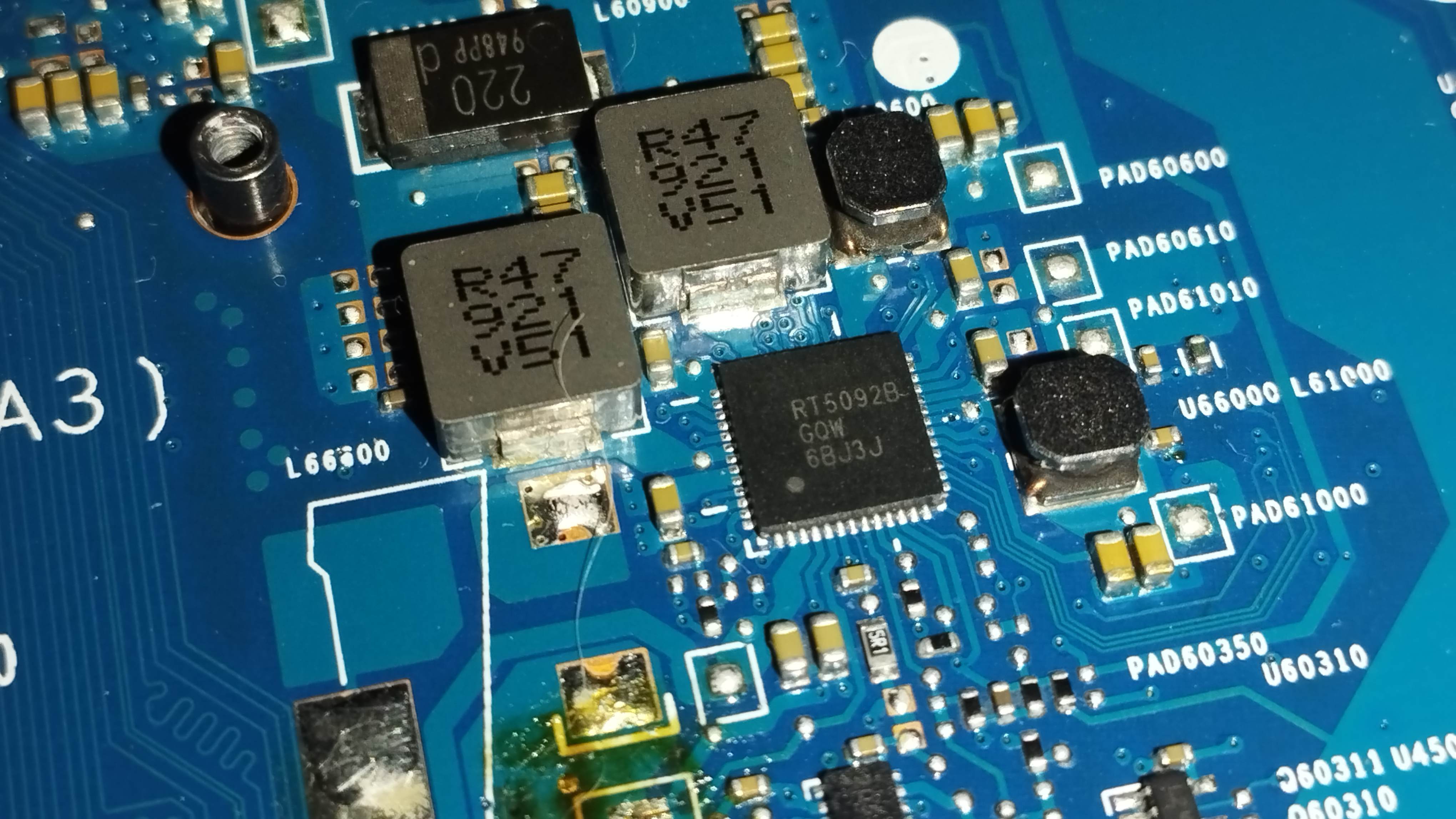

    Hi
    I have hp board hedwig 6050a2993001 which has an ic on it named RC5992B attached picture
    Anyone has a datasheet for it as it's not enabling the RAM voltage ic

    Anyone help me find the datasheet?

      For the chip with markings RT5092B?

          So far, nothing available in the public for this regulator.
          Remove all power. Measure the resistance to ground of each inductor and capacitor in this region. An excessive current draw of the power rail due to a short will force the rail to shut down. Does this chip heat up more than normal?

            Ok i will do that
            No it doesn't heat

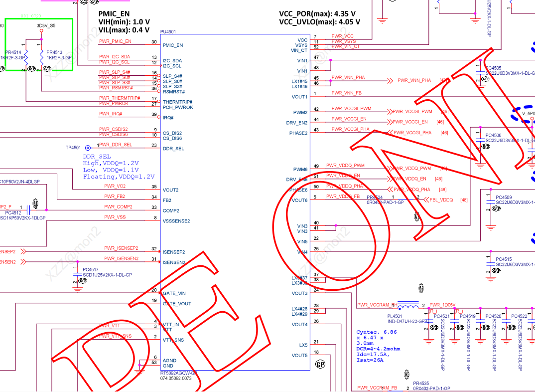

              No datasheet but it`s in the Wistron San Bernardino schematic. Which i don`t have.

                Attached.

                  Thanks a million 🌹
                  You are a life saver

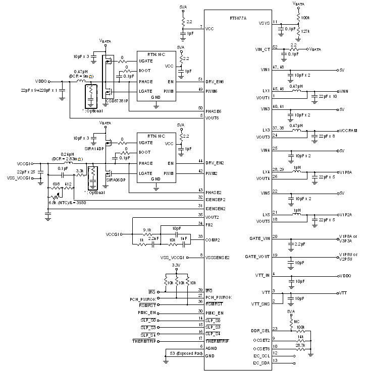

                    RT5092B = RT5077A
