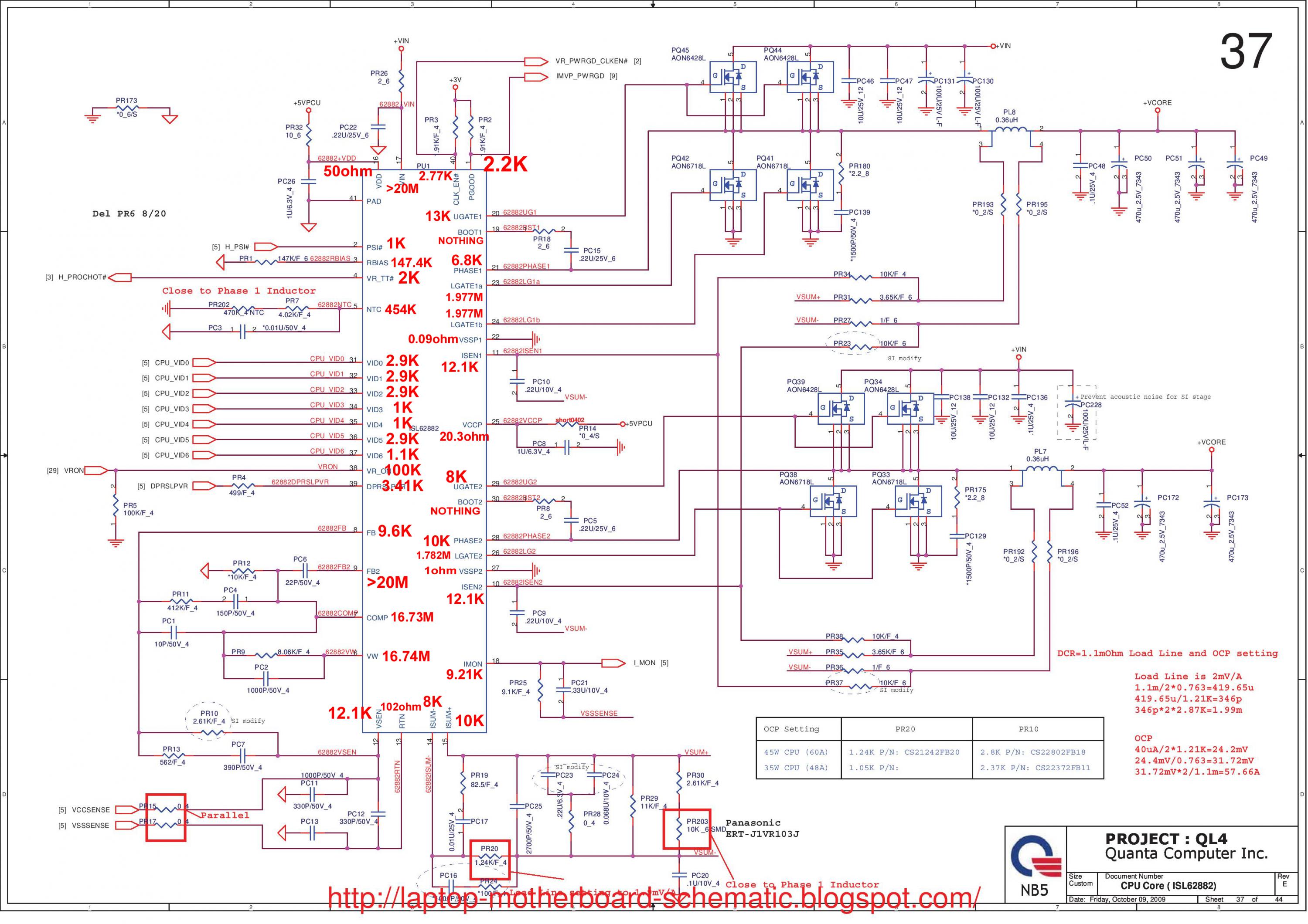

    check DPRSLPVR on pin 39 of ISL62882 why the reading is 0.1V only. PGOOD = 0.07V indicates
    a. one or more signals necessary to turn on this chip may be missing
    b. there is still a problem with the output, probably over-current, etc.
    Also, wouldn't hurt if you use proper voltage - 18.5 or 19v. Looks like 21.5v is too high and may trigger over voltage protection.

      I do not know if you are still using the 21.5v power supply but is better to use the 19v regulated power supply (as whaldsz also suggested). VCCP pin 25 (Input voltage bias for the internal gate drivers) must be 5v +- 5%. PGOOD voltage says that is in protected mode. The VID signal combination should give you an output of 0.8375v.
      Are the readings still the same on PU1 pins? What is the resistance to ground on all pins without power supply connected?

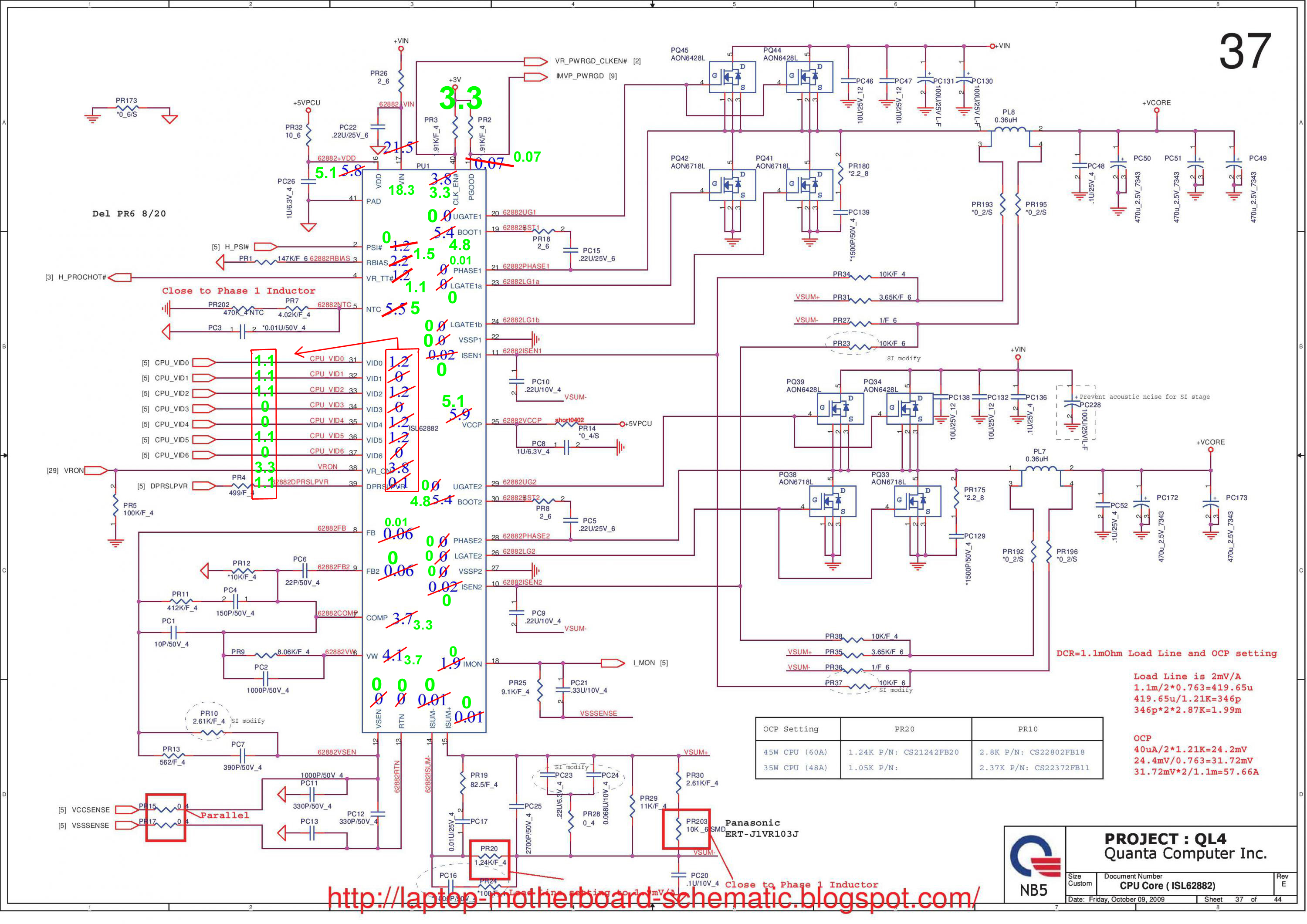

          If i told you why voltage is too high, you will not believe it..
          I gave 19V from my bench power supply and i measure again 21.5V...
          After scratching my head, i change the multimeter battery, and correct voltage showing up..19V
          So i measure again all ISL voltages and correct them with green @ attachment:
          NOTICE: this time i measured WITHOUT CPU, all previous readings in blue are WITH CPU and with +15% higher value than normal because of above multimeter problem.
          If i hook the laptop battery, charging/standby led become orange for 2-3 sec and return yellow again, as if battery is not present!
          I dont know if battery was working before..

            What about resistance?

              Re: Turbo-X Quanta QL4 VCORE missing
              Some of readings are not the exactly value because of capacitor discharging (i think) as example starts at 100K and as falling down slowing to 40K and keep falling(values are random). I write down the reading that falling slowest @ attachment
              PS. All readings are WITHOUT CPU, btw with the vid signal combination WITHOUT CPU, Vcore must be 1.0125, am i right?
                You have a short on the 5VPCU line, resistance is too low

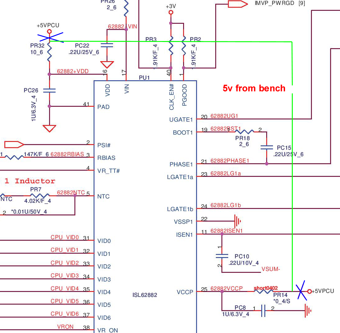

                  To check if PU1 is fine, remove PR32 and solder from PR14 and inject 5V with regulated power supply to the PU1 side.
                    VCCP its the input voltage for PU1?
                      Input voltage for the internal gate drivers.
                          You mean something like this if i understand it right?
                            Yes, supply 5v to those two pins (disconnecting the 5VPCU line - remove problem) just to confirm that PU1 is functioning properly.
                                Replace 5VPCU with 5V from bench to PR32 and PR14(scratch pcb to remove short, there is not solder joint) resistance now is 3M+, power it up and now Vcore is 0.33V.
                                PL13 is 20 Ohm and PL14 is 18K (of course without power)
                                Next step is to find why 5VPCU is shorted and fix it or we have 2 different problems now?
