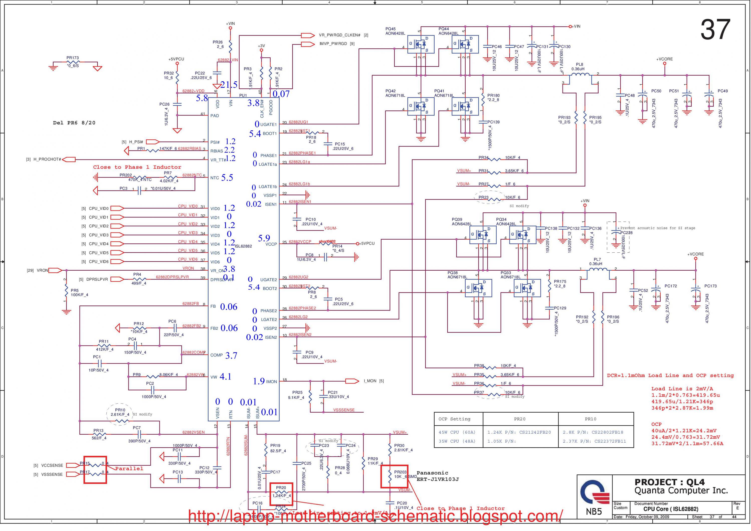

    Hello everyone
    Turbo-X laptop, same motherboard as LG R590.
    Laptop came after water felt on keyboard, turns on, fan start spinning for 1-2 seconds but nothing on screen(internal+external)
    Clean all the board with Isopropyl.
    All voltages seems ok, except VCORE voltage is 0-0.4
    GPU and CPU get hot as usual but fan wont startup again, only at boot(55 C temp after 2-3 minutes)
    I change ISL62882(CPU POWER IC), same readings(see attachment)
    Also attached schematic!
    Any ideas?

    Re: Turbo-X Quanta QL4 VCORE missing
    Give voltage on all pins of ISL62882
        Measure the voltage with power button pressed on all pins of regulator
              I mean these readings already posted at first post are with power on!
                      If you remove the processor, do you have any voltage on PL7? What is the resistance to ground on PL7 with and without processor?
                        No voltage..resistance with cpu is 0.8 Ohm, 2.0 Ohm without CPU
                          Remove pl7 and check which side has the short
                            I remove also PL8, short is at cpu side reading 10 ohm without CPU and 2.5 Ohm with CPU
                            MOSFET side reading is 180 Kohm and counting..
                              Do you have voltage on mosfets side when you remove PL7 and PL8?
                              Use the regulated power supply to inject voltage on PL7 from the CPU side. Set voltage 0.5v and 0.5A and check if anything is getting hot. If there isn't any responce, increase amps slowly and check. Do that without CPU.
                                No voltage at all!
                                BUT..
                                I found the short, it was at PC172 NEC/TOKIN capacitor inside CPU socket. I begun desolder these caps before go with "whats hot" procedure and with the first i removed, short disappear. Now resistance is 50 Kohm falling without CPU, 28 Ohm with CPU!
                                After replace, next step is to replace again ISL, do you think its already fried?
                                    Tokin replaced, now i have 0.04V at PL8, PL7 with and without CPU.
                                    PQ44, PQ45 mosfets (AON6428L) are fried..
