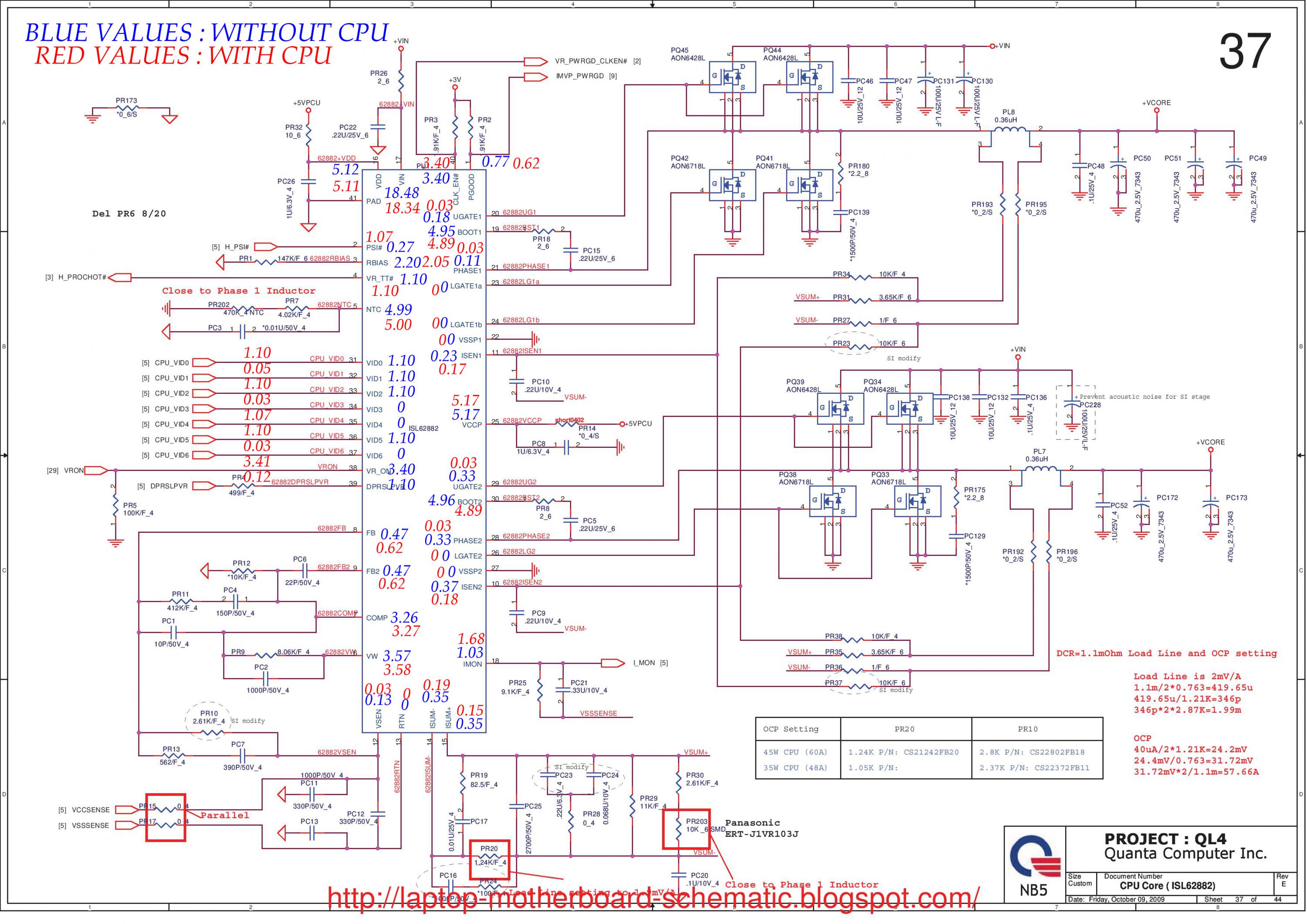

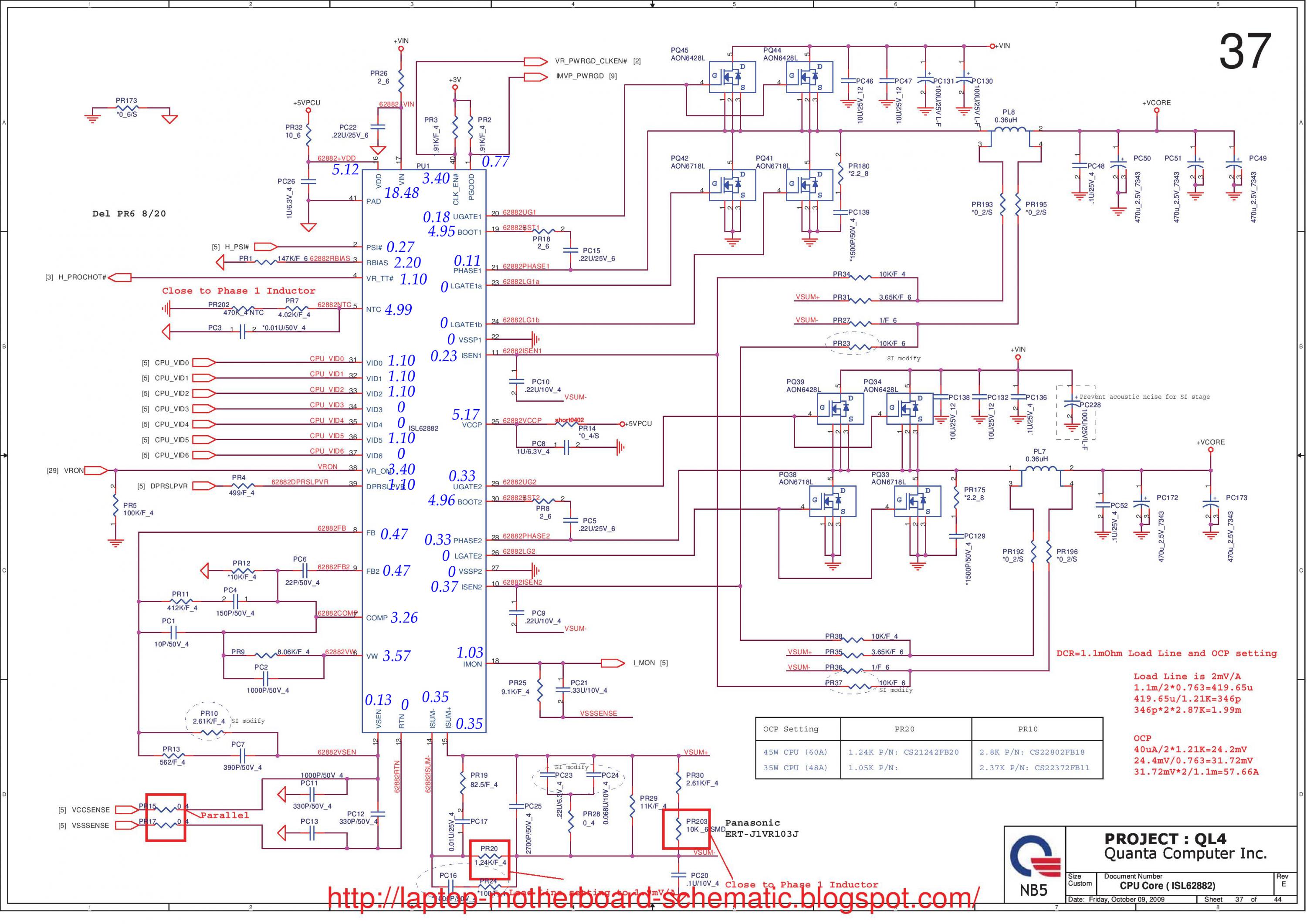

          Re: Turbo-X Quanta QL4 VCORE missing
          What are the voltages now at all pins of PU1?
            #45
            Thanks for reply Atsio,
            Voltages without CPU attached:
              #46
              What are the voltages with CPU?
                #47
                Blue values : WITHOUT CPU
                Red values : WITH CPU
                  #48
                  Finally problem solved...decide to reflow PU1 before give up and mobo is up and running ok!
                  Thanks a lot everyone for your help, especially Atsio!
