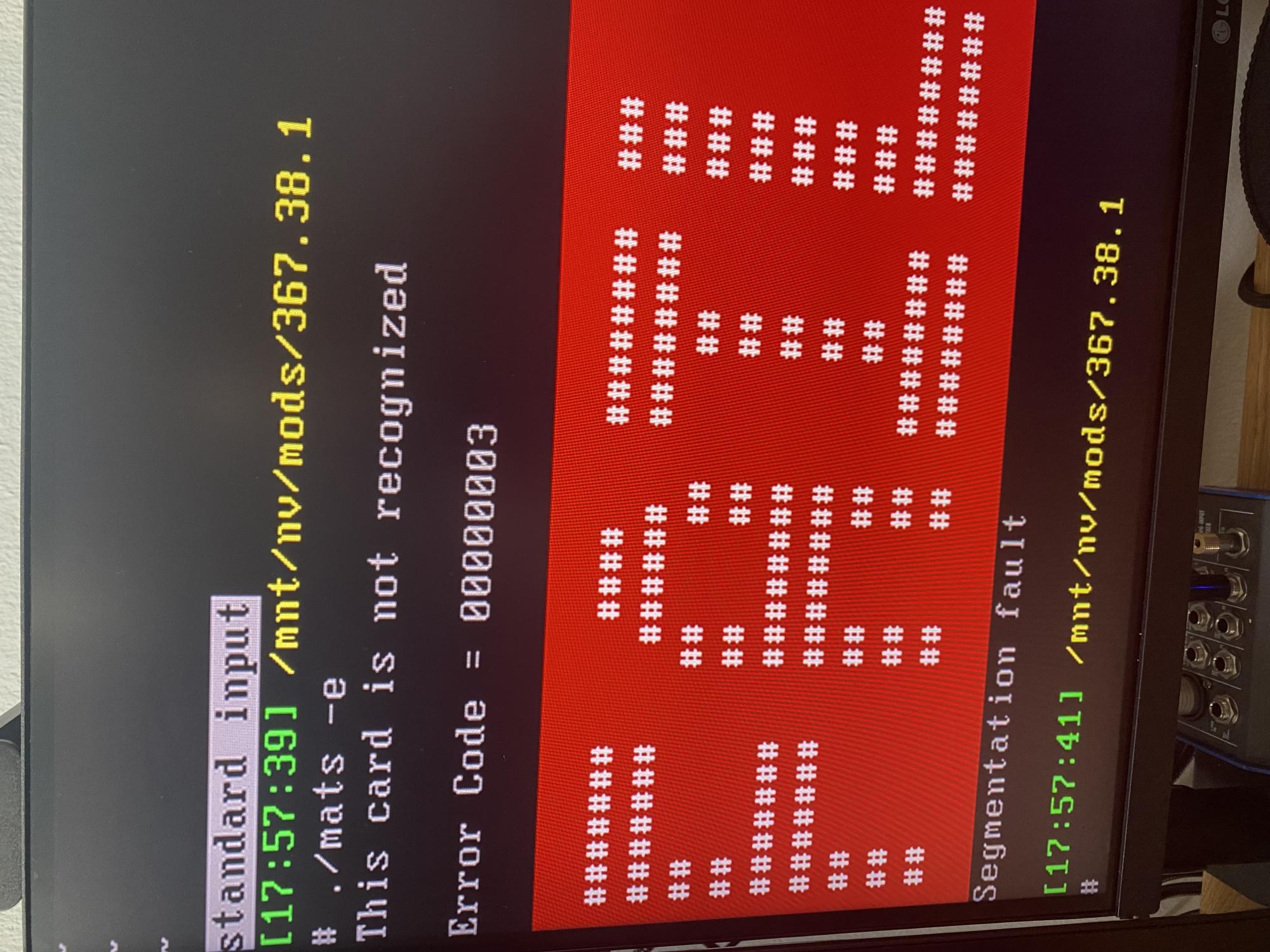

    I have an RTX 2080 ti (Zotac - triple fan) with no video output.
    So far I have measured the following:
    • PS_FBVDD_PH3_SW = 40 ohm to ground (Micron ICs) - Memory should be fine right?
    • 12V power rail present
    • 3.3V power rail present
    • 5V power rail present
    • 1.8V power rail present
    • Vcore power rail missing --> PS_NVVDD_VREF is present. (from uP9512P / U812)
    • Vmem power rail missing --> Not there because Vcore power rail is missing.
    Any idea? I have already tried to flash the BIOS chip (backup got created) - sadly no changes.
    Source: https://www.techpowerup.com/vgabios/...emSize=&since=
    • Version: 90.02.0B.00.C7
      AND
    • Version: 90.02.17.00.58
    Note: GPU chip is getting hot when PC get turned on - Won't be recognized by MATS.
    MATS result - command: ./mats -e
    command: ./mats -e 5 :less only says "standard input".
