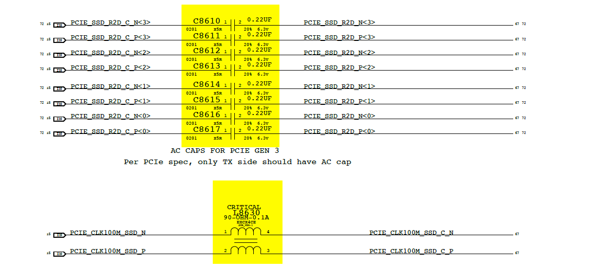

    820-00875 SSD not recognize
    Hi, the pc does not recognize my SSD, I was testing Volt and the SMC_OOB1_D2R_L, and gives 0.03v approx, and it should provide 3.3v I think, what can be the problem? maybe is the resistance (R86101) I cant test it with my multimeter too small, but I don't think that would do the V go to 0.3v, and SMC_OOB1_D2R_L has continuity with the test point. I think all other pins are okay.
    Link to schematic/boardview --> https://www.badcaps.net/forum/troubl...c-and-boarview

      is not the resistance, if not ssd is connected the resistance is100k, if yes is 8k omh

                • mon2
                  • Dec 2019
                  • 14415
                  Confirm that each of the highlighted AC caps are present on the board. Confirm the EMI filter for the PCIe clock is present on the board. Study each to be sure there is no disconnect or defective part in series with any of these lines. It takes only 1 defective part to cause this SSD to fail to be enumerated.

                      L8630 both low resistances seem fine, AC caps also seems fine
