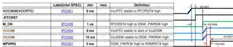

      Many thanks for the tip!
      I found the schematic you are referring to and the power sequence. I'd say that in my case it doesn't go very far
      Click image for larger version  Name:	power-sequence.png Views:	0 Size:	149.7 KB ID:	3342930
      In fact, I can see that VCC3SW goes high, but that's it. M_OK remains low.
      I'm not sure why VCC3M and VCC5M have a different color, but from the schematic I can see that M_OK goes to the EN pin of the chips taking care of the respective power rails. Therefore, I'd say that no M_OK means no VCC3M and no VCC5M.
      Moreover, while looking at the board I also noticed whomever previously worked on the board removed the BIOS chip. Is the latter needed for M_OK to go high? More in general, should the main power rails come alive even without the BIOS chip? I'll obviously find a replacement if needed, but it'd be great to understand if there's any hope to get this board working first

        You probably need it, yes. And if you are lucky, that is your only problem. Was the board bought as "non-functioning" ?
        Also, if you saw the bios chip is missing, search the board for other componentes that may be missing also.

          I doubt the missing BIOS chip could be the only problem at this point, otherwise why they would have removed it in the first place?
          I bought the laptop as untested, but the seller didn't say anything about a failed repair attempt or missing parts from the board.
          The main reason why I'm not sure if the BIOS chip has anything to do with the missing M_ON is the fact that at this stage the BIOS chip is simply not powered (i.e. 0v on its VCC pin).

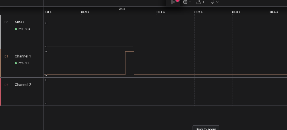

            After checking all the power rails without noticing anything completely wrong, I decided to inject 3v to bring the M_OK signal high... and the board gave a sign of life 🙂 LED lit up and power rails VCC5M, VCC3M, VCC1R05_SUS, VCC5M_PD are now on.
            As I mentioned, the BIOS chip is not present on the board but I can see that the CPU is trying to speak to it (I assume so at least). In fact, sniffing the SPI communication on the missing BIOS, I can see some initial activity as soon as the M_OK goes high then nothing much happens, but since there's no chip there I'd say it's kinda expected. But at this point the BIOS chip would get its 3v.
            Do you think I have a chance to see this board working? 🙂​
