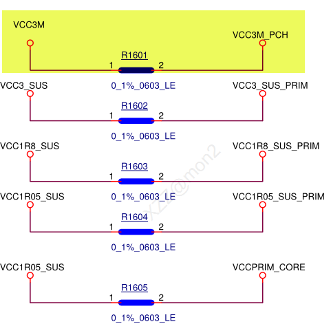

      Missing the voltage on SCL & SDA lines is of concern since these are open-drain lines and in their parked state, the lines will be floating so the pull-up voltage should have ~3v on each line but are at 0v.
      With no power to the board, confirm the resistance to ground of the pull-up voltage rail of VCC3M (created by PU0501). What is the resistance? Also of concern since this rail is also mated with the PCH.
        Thanks for pointing this out. Indeed, the VCC3M rail is absent at the moment. PU0501 is one of those that wait for the enable signal M_ON from the ThinkEngine. In fact, if I inject 3v on the M_ON line the VCC3M rail comes up regularly.
        Resistance to ground on the inductor PL0501 starts around 900kohm when I start measuring and then it goes down until it stabilizes at 40kohm

                    As you suggested, I also measured the resistance to ground on all the power rails indicated on page 16 (PCH POWER):
                    Label Measure Label Measure
                    VCC3M_PCH 40Kohm VCCDSW_1P05 5.7Kohm
                    VCC3_SUS_PRIM 26Kohm RTCVCC 747Kohm
                    VCC1R8_SUS_PRIM 53Kohm VCCRTCEXT 414Kohm
                    VCC1R05_SUS_PRIM 51Kohm VCC1R05_SUS_XTAL 52Kohm
                    VCCPRIM_CORE 51Kohm VCC1R05_SUS_AMP 51Kohm
                    VCCDPHY_1P24 39Kohm
