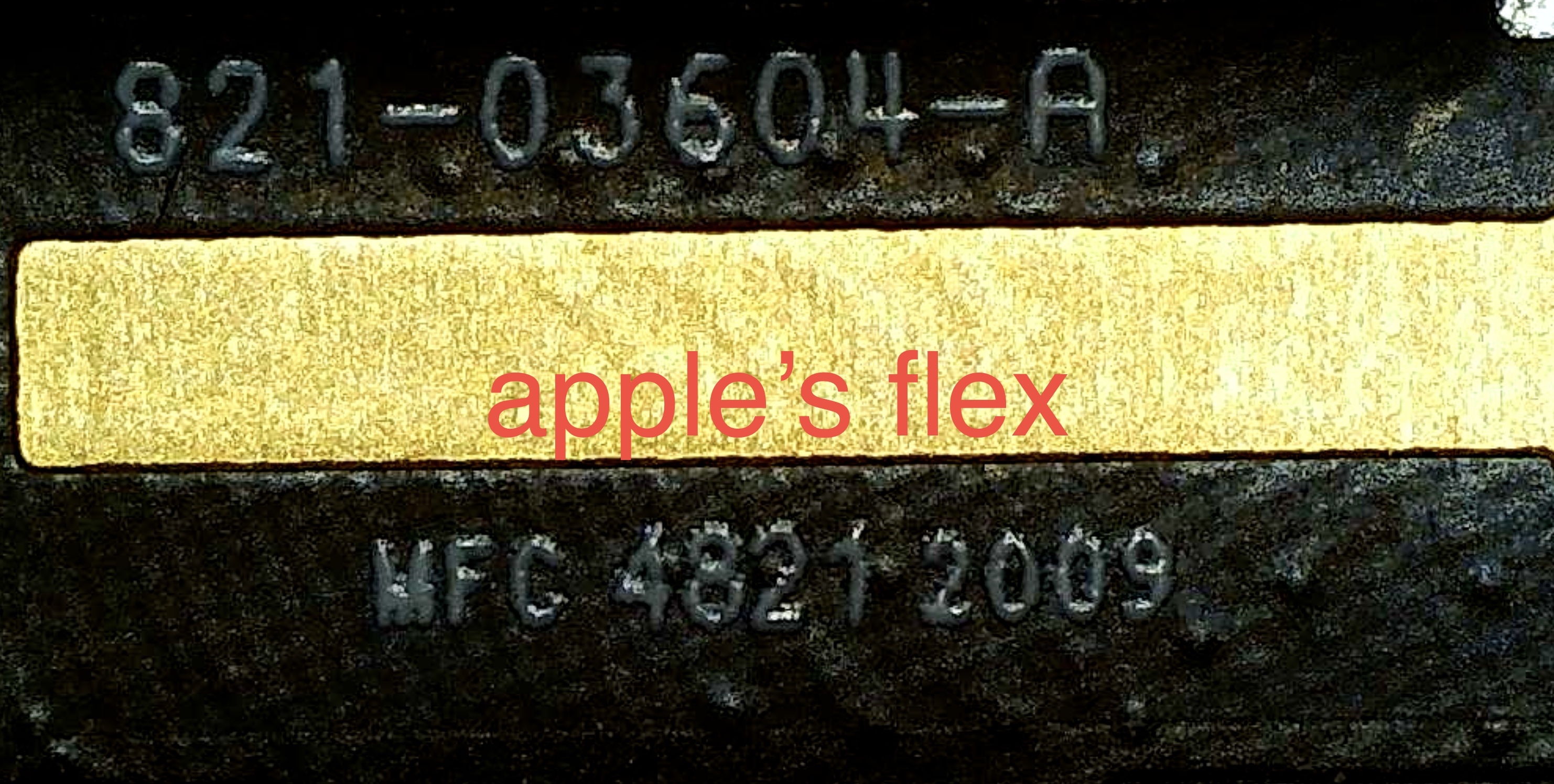

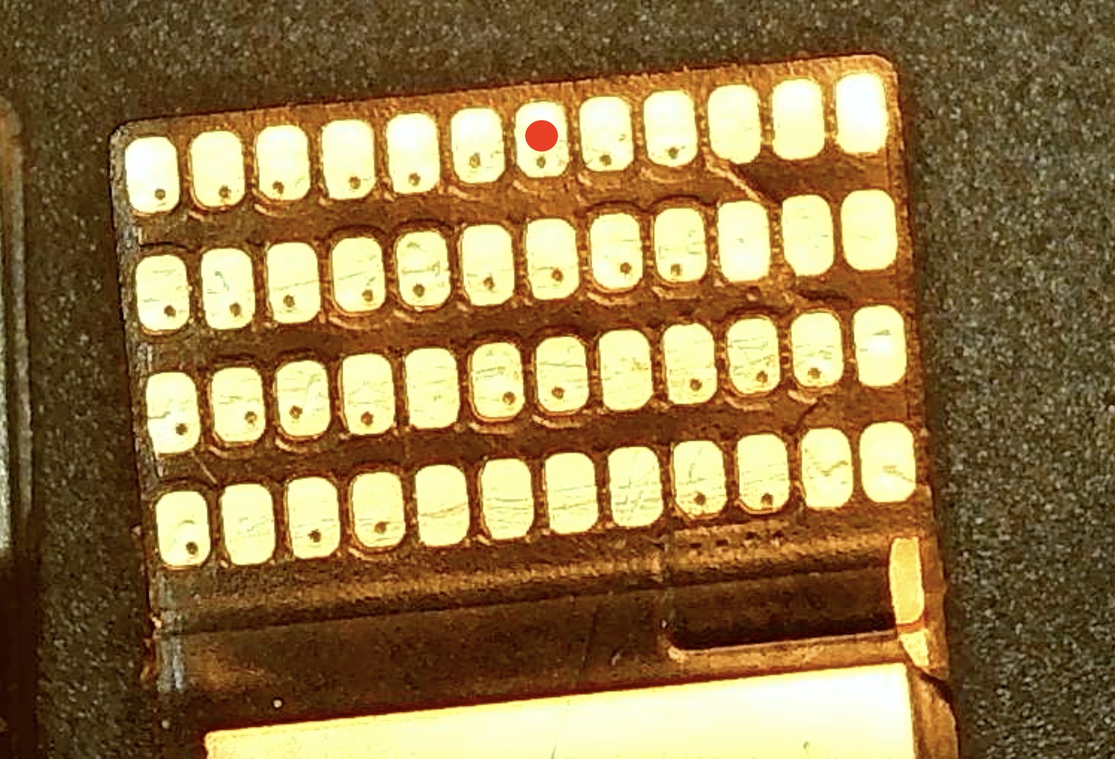

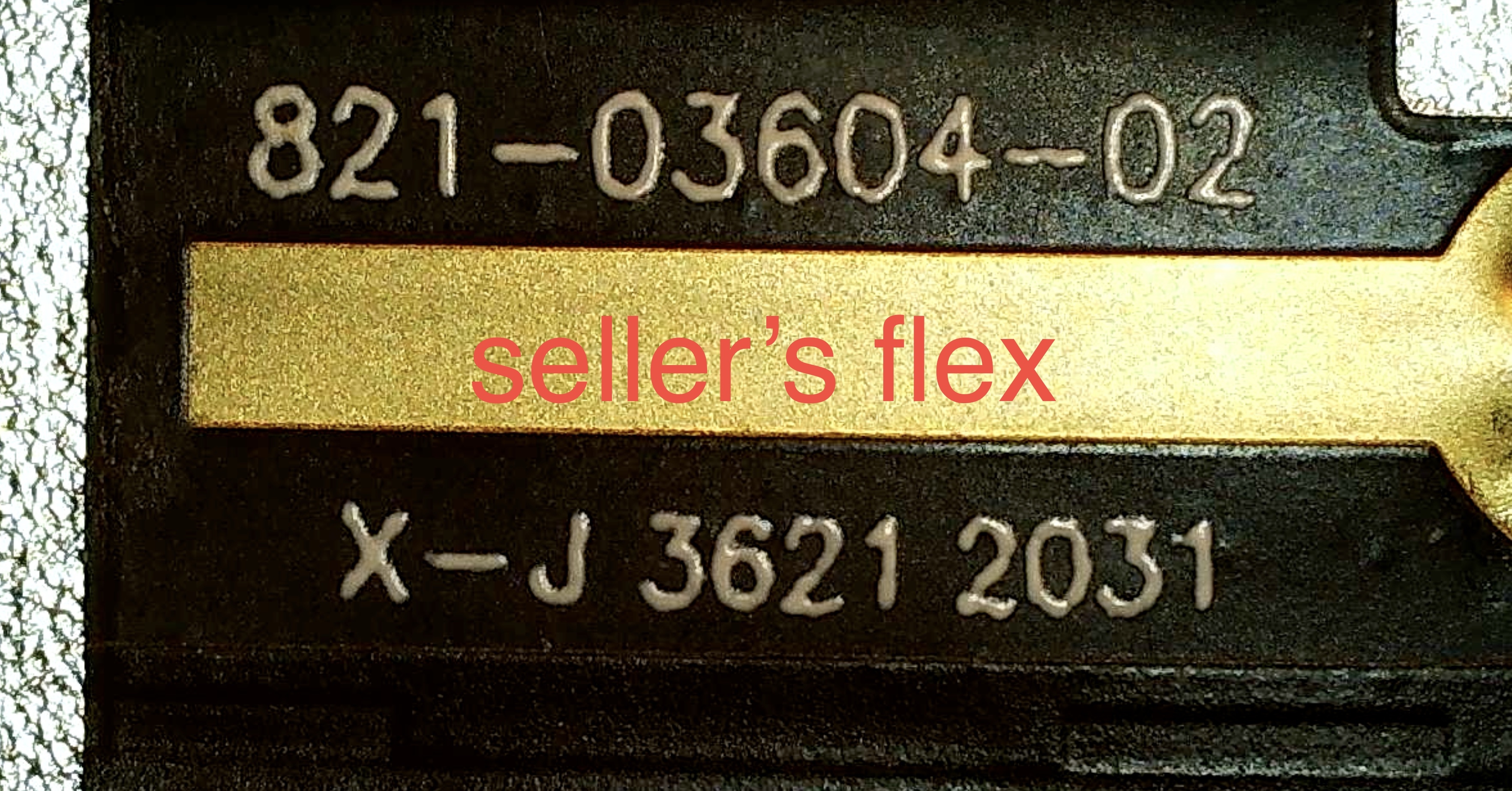

        Originally posted by a316
        found seller's flex has spi_tcon_clk_conn shorted to ground, on JP600 side. apple's flex has 4,5Om same pin to ground, flex disconnected
        my fault about apple's flex - spi_tcon_clk_conn has infinite resistance to ground
        but on seller-s flex -it is clearly shorted to ground. it is 4-th pin from left. =pin 28 and pin 30 both beeps on seller's flex, pin30 only beeps on apple's flex
        flex is DISCONNECTED when measuring

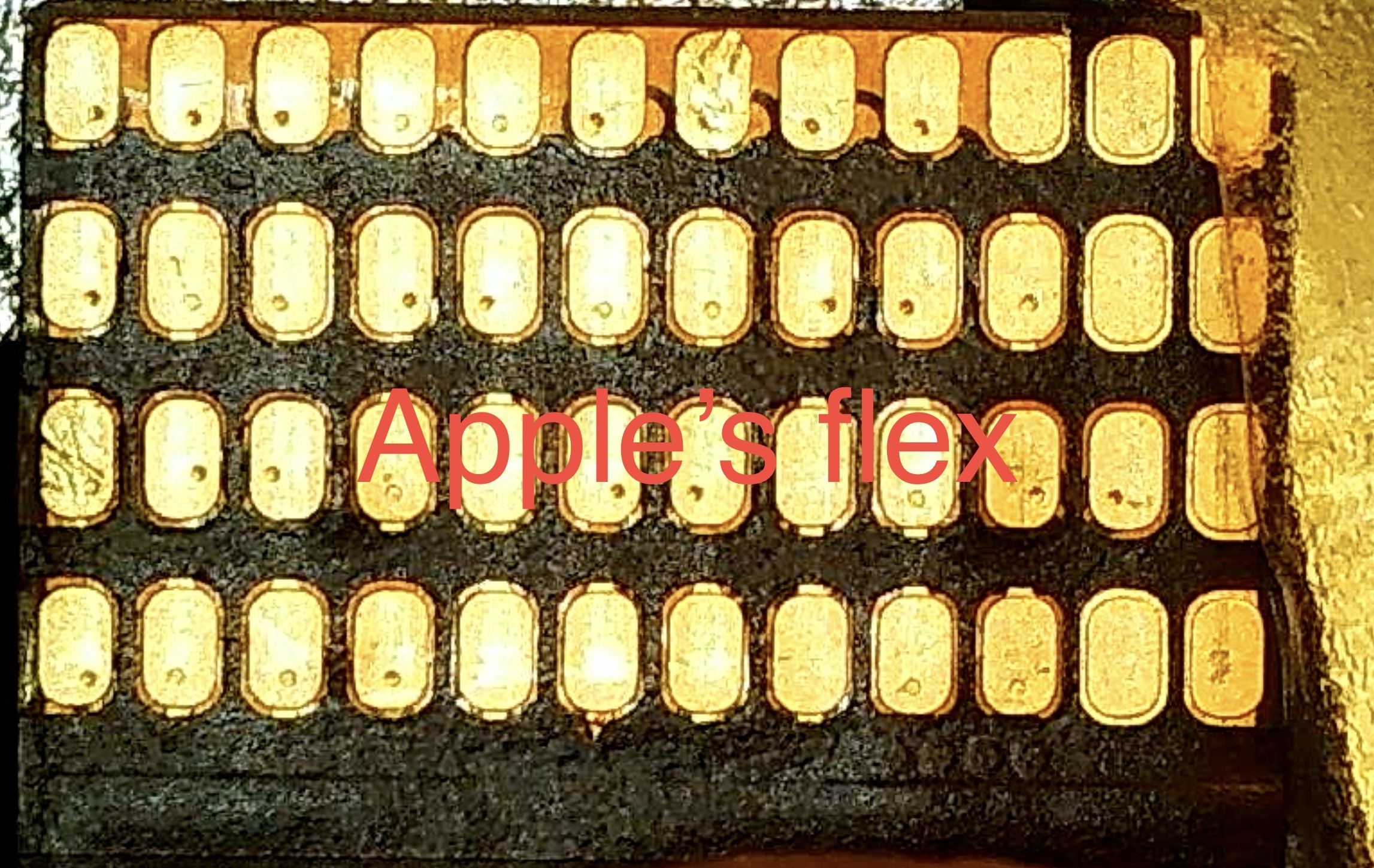

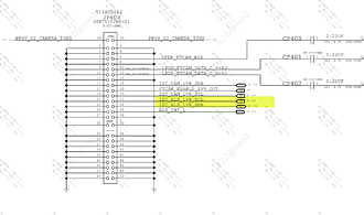

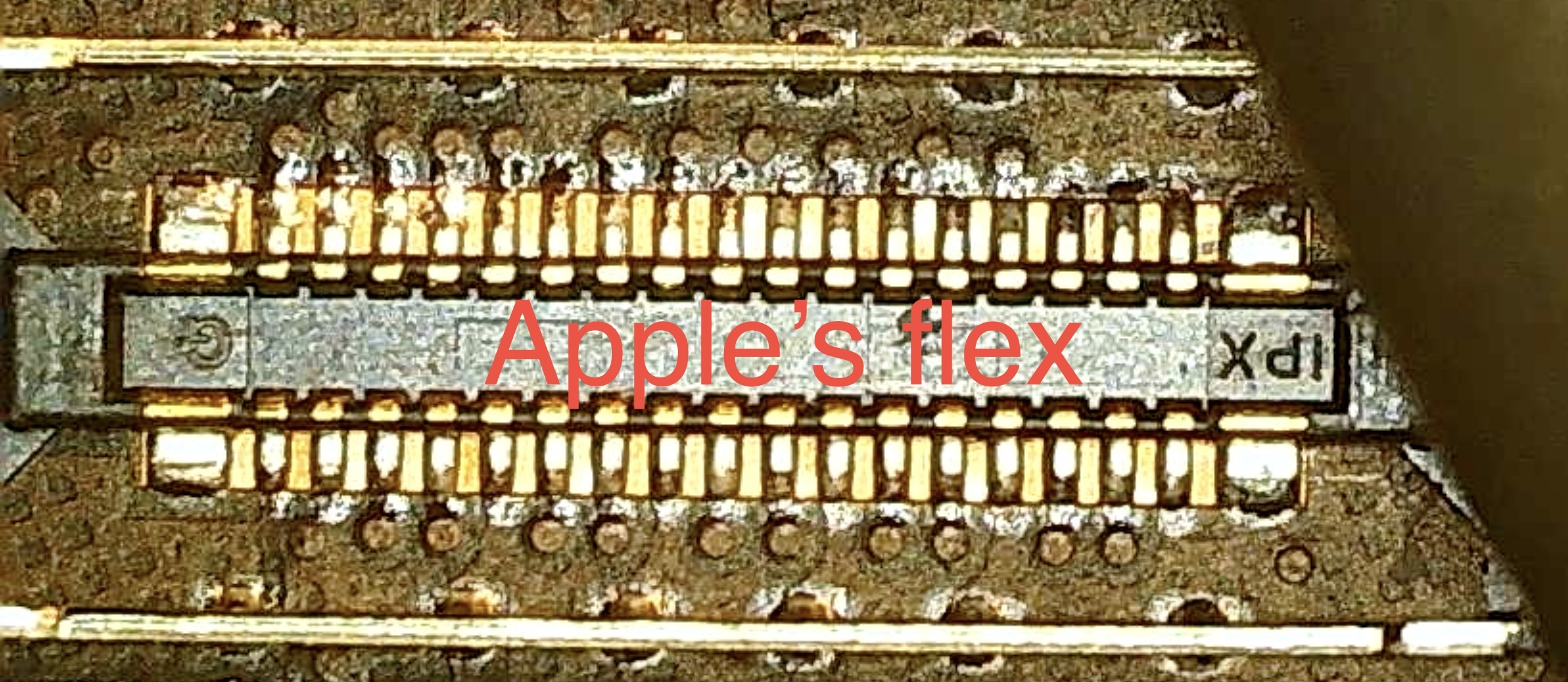

          see picture 1 - this pin (marked black line) is shorted to ground on seller's flex
          picture 2 - this pin on seller's flex (red color) has 1.5 Om resistance to ground
            it is like not flex, it likes has some parts inside
            let me know if this helps
            ps. spi_tcon_clk_conn connected to M1, be careful

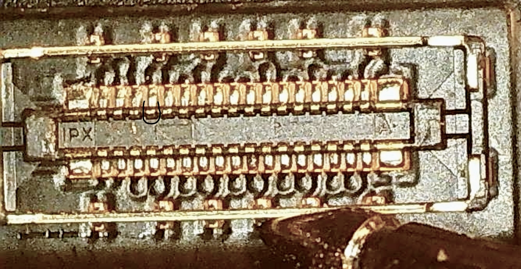

              glass, up to 100 celsius, see photo I attached with screwdriver points there

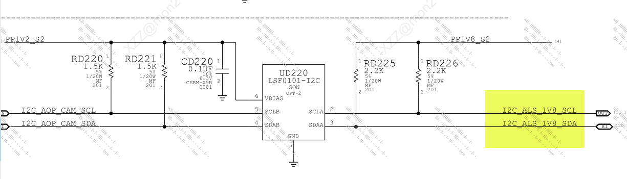

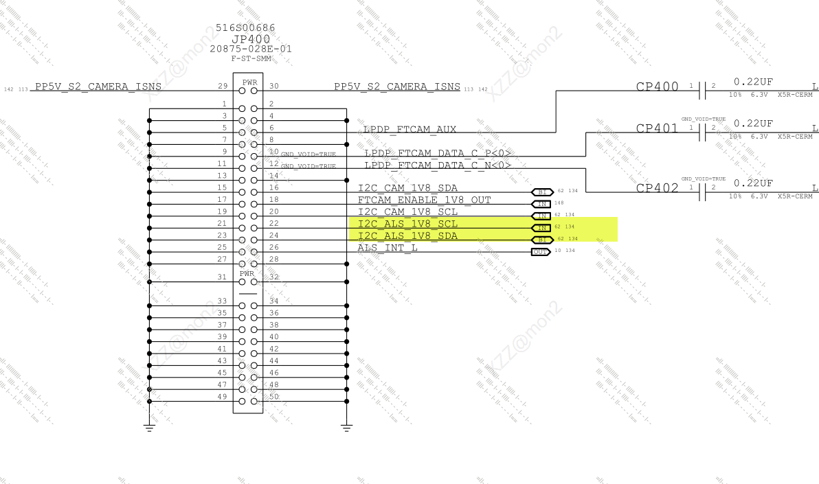

                              True tone is linked to the ALS (ambient light sensor) which is separate from the camera. There is a local level shifter involved in this communication path onboard. Do review this level shifter if the ALS is a suspect.
