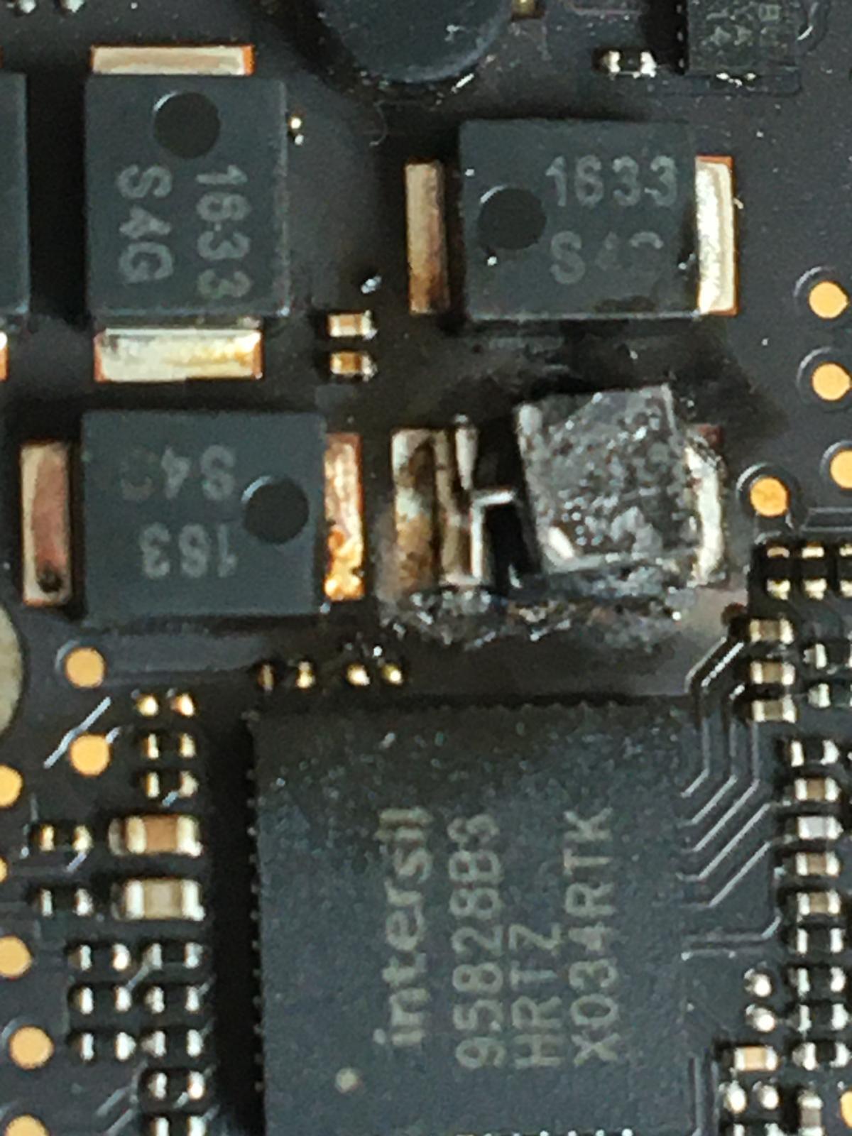

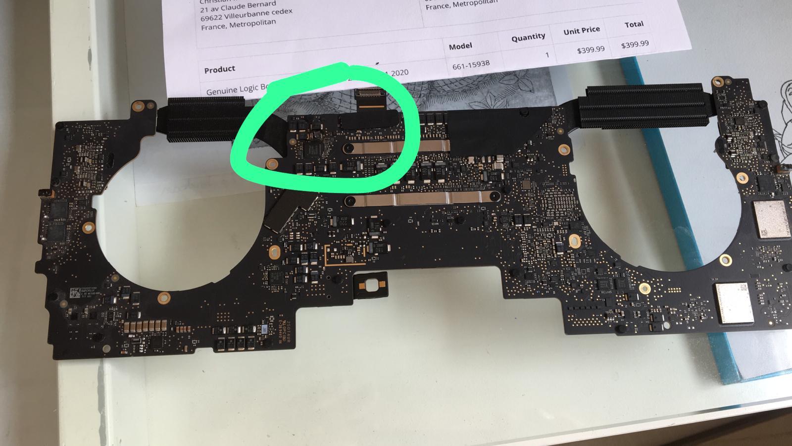

    Hi there, I had a MacBook Pro 13" 2020 A2251 at work, and it suddenly stopped working without having being bad to it (I ride my bike everyday though). I replaced the motherboard so now it works again, but with other data. I would like to repair the 661-15938 motherboard. I spotted where it burned, I saw that there is a post where there are the 820-01949 pdf and bvr but I don't know what to do with it. I tried to install OpenBoardView because it seems like it's what I should use to have a look at the schematic view of my motherboard. But I failed:

    But surely some people on this platform can tell me what this item is and whether I have a chance to be able to soldier a new one back? Thanks! Best regards, Kristion

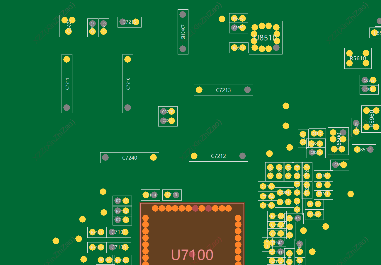

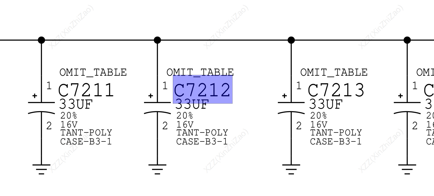

    See attached.
    Appears to be C7212.
    Click image for larger version  Name:	C7212.png Views:	0 Size:	83.2 KB ID:	3328751

              Wow, mon2 Thanks heap, you are great! So it is indeed a badcap! 33μF. Do you know where I can find this kind of cap, I mean with this (very small) kind?

                  TAJB336K016RNJ KYOCERA AVX | Capacitors | DigiKey

                      You There is a polarity to this capacitor so be sure to review the datasheet and also the placement of the part you are replacing. Confirm that ground pad is mating to the ground pad of this capacitor. YT will also have many videos on capacitor replacement. Suggest to practice on a donor board that you can pickup off EBay. Watch YT videos from Louis Rossmann and also Alex (Northridge Repair).
