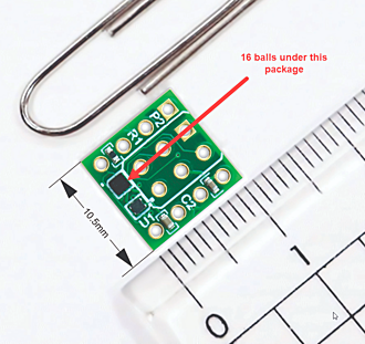

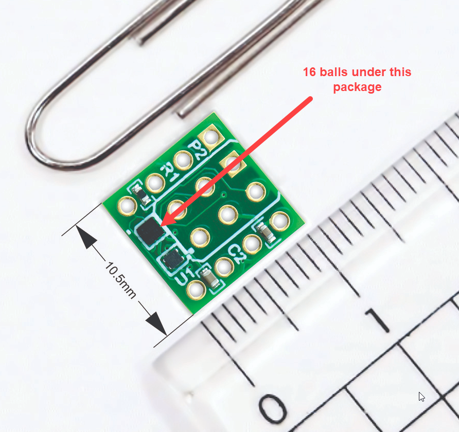

                                      mon2., thank you very much, got all the bins. Now please inform me one thing., should I just put in all 4 new CD3217B12 on this MacBook Pro A2251 Logic board 820-01949-A & program U3060 & UB260??? & I read that a univeral programmer can be used to program these chips & what ID should I use for these chips or it will automatically detect the identity of the chips by itself?? Thanks dear
                                      • mon2
                                        • Dec 2019
                                        • 14713
                                        Personally cringe and my family jewels run for the hills if dealing with any BGA rework so suggest to leave the CD3217 controllers alone at this time. Although, yesterday managed to rework a 1.4*1.4mm FPGA with 16 balls (WLCSP package) to remove a few shorts. Worked out fine. It is the world's smallest FPGA device = Lattice ICE40UL1K (physically). It is a new product we designed for DIY developers.
                                        Yes, the referenced FLASH devices are correct and believe the downloaded dumps should offer the binaries for these targets. Suggest to make a backup of the original devices using your tools. Be sure your programmer can support the target voltage of 3v3 for the flash.
                                        The part # is in the schematic = W25Q80DVUXIE = Winbond. Ideally your programming tool will support Winbond -> search for W25Q80. Based on the schematic labels, the flash device is operating in standard SPI mode (not QSPI = Quad SPI mode).
                                        Summary - test only the external flash dumps.
