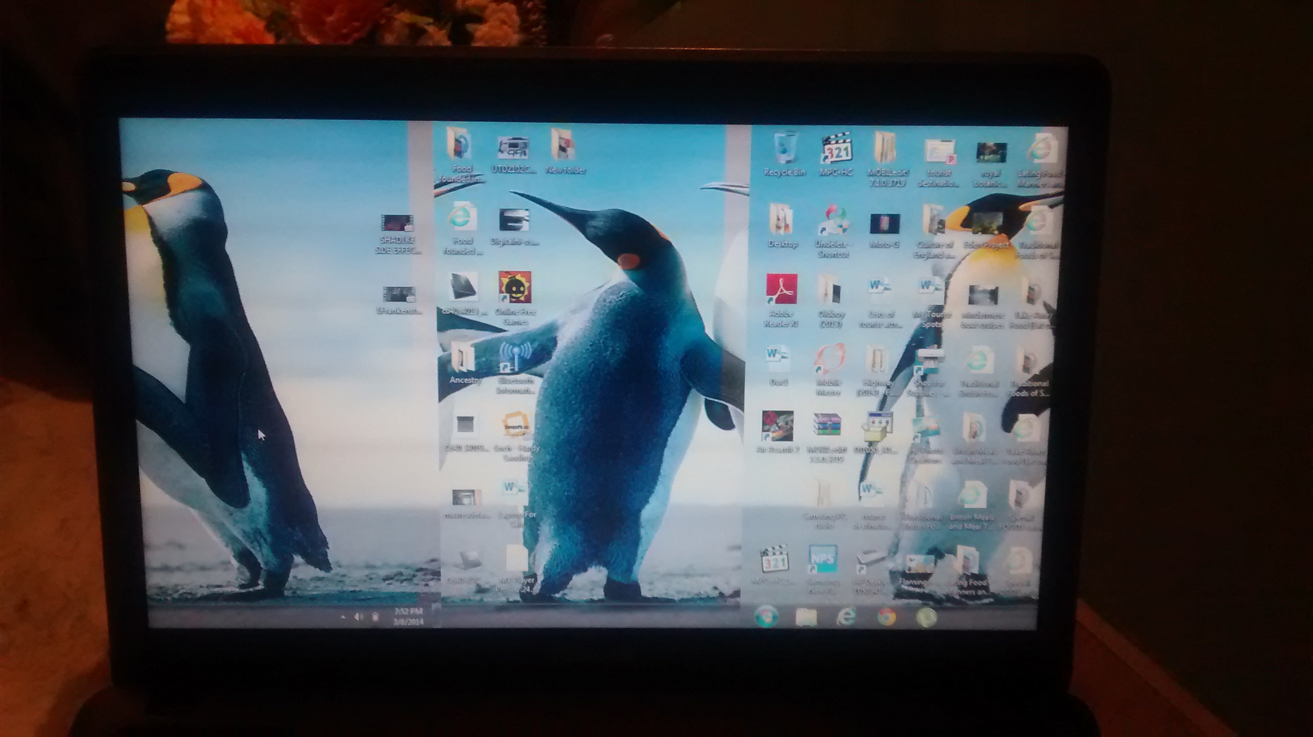

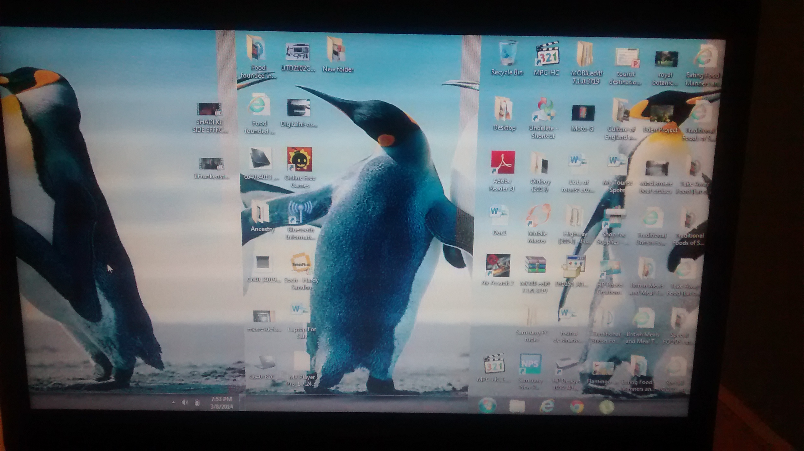

    I am getting this weird screen on my toshiba c640 laptop. Before I go ahead with the dismantle procedure I would like to know what to check so that I don't miss anything.
    P.S. I have not tried anything yet, on software or hardware part.
    thanks.

    have you tried with external monitor ?
    • spleenharvester
      • Mar 2010
      • 894
      Re: weird screen
      Try with external monitor. That looks like an LVDS problem to me. GPU is possible though.

        i see gpu is intel... hard one to broke...

          My guess is panel or lvds cable.

            I have tried an external source and it seems to be working fine.Can cable also be the reason? What next?

              Re: weird screen
              Remove the screen, make sure battery is removed.
              Carefully peel of the adhesive tape from the LVDS cable connector behind the screen, pull the cable out, then reinsert back. Try on, and see you get any difference.
              No difference, if possible get a known working condition LED panel, fit it up.
              Mostly this is related to panel it self. Faulty panel. But try the above, sometimes the connector do get oxidized and cause erratic issues.
              Since you get perfect picture on external monitor, likeliness problem isn't the Intel chip. As dellxps15 said, this chip is hard to breakdown.

                  Re: weird screen
                  Replace the screen, a new cable will not help.
