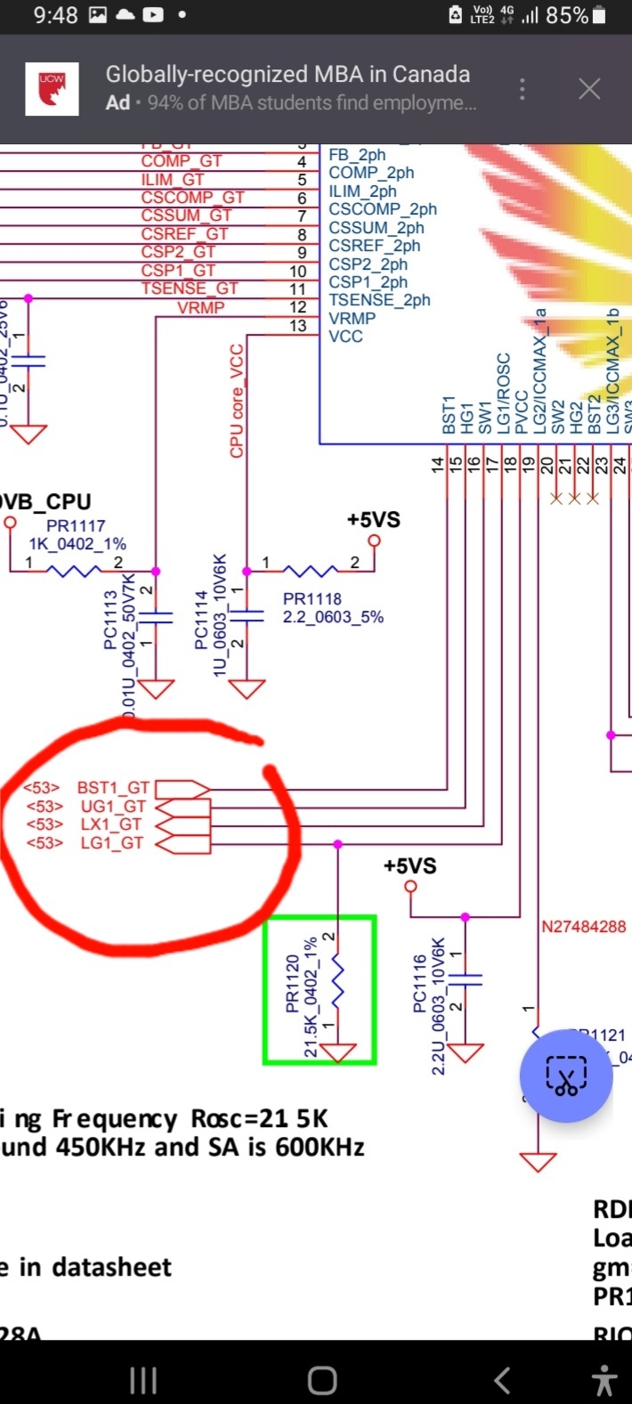

    Hi.My laptop is hp i3 7gen with LA-D707P MB. NO VCC_GT voltage is created .all other voltages are ok.VRN_ON#,PCH_PWON# are OK.mosfets are ok VCC_GT Core impedance is 6.OHMS.
    No signal to PU1101 of UG1_GT, LG1_GT see the picture. Will replacing PU1101 chip fix it..? Thanks in advance.

    Hi that is no problem the power comes up when cpu needed example by loading windows etc. Problem is elsewhere. What is the problem with the laptop?

      Hi power on but no display. This is not normal. VCC_GT should come on right..? .it has on board graphics .thanks.

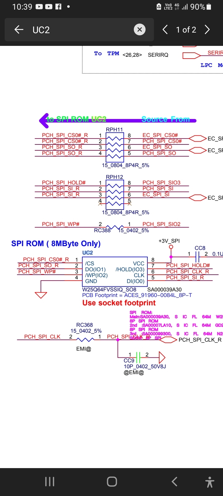

        Hi. My laptop has no display. My motherboard is HP LA-D707P. All voltages are ok .I checked the bios pins with a oscilloscope but see no clock signals .but see only 3.3V . I did flashed the bios 2 times.even used new chip.
        Now please educate me which direction I must go. ?
