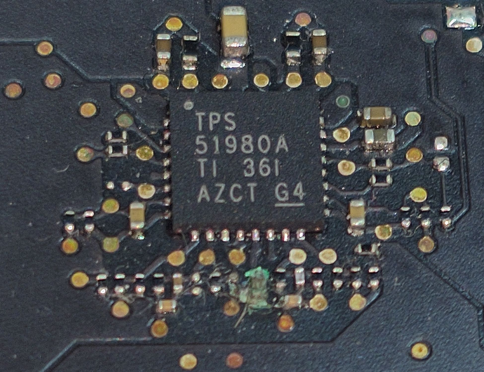

          What does the area around Y5110 look like?
          Also, is U5110 nice and clean?

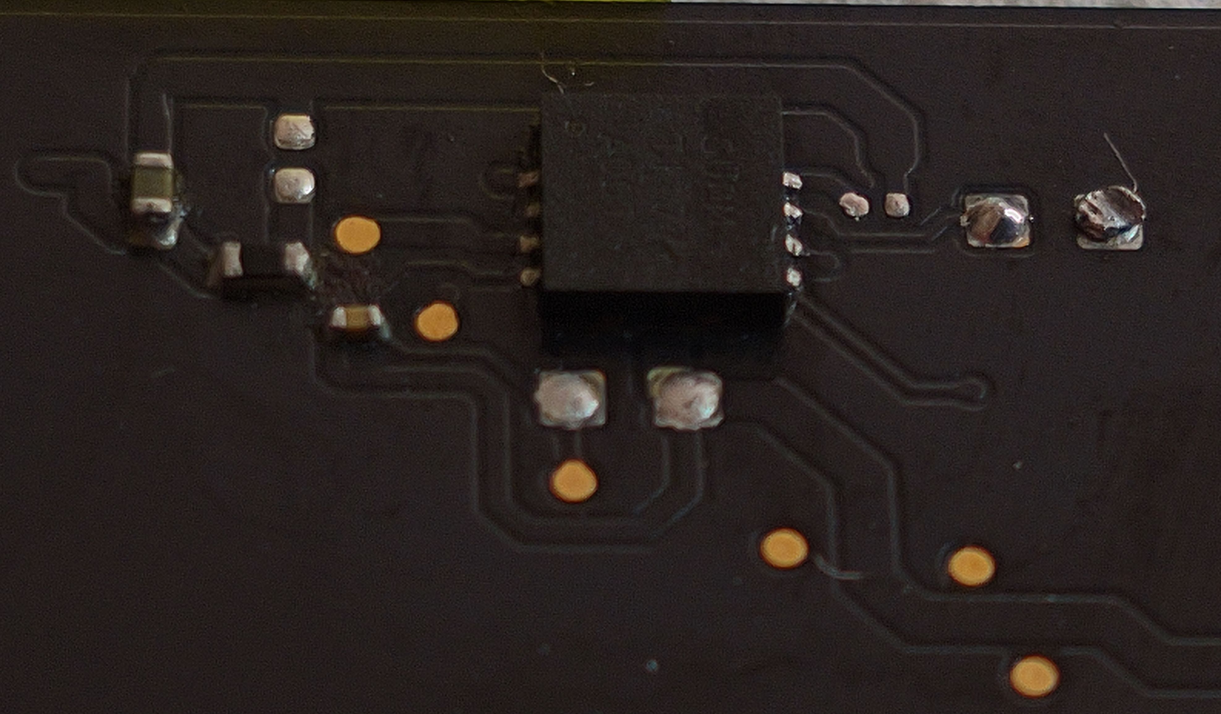

            Only missing C5126.

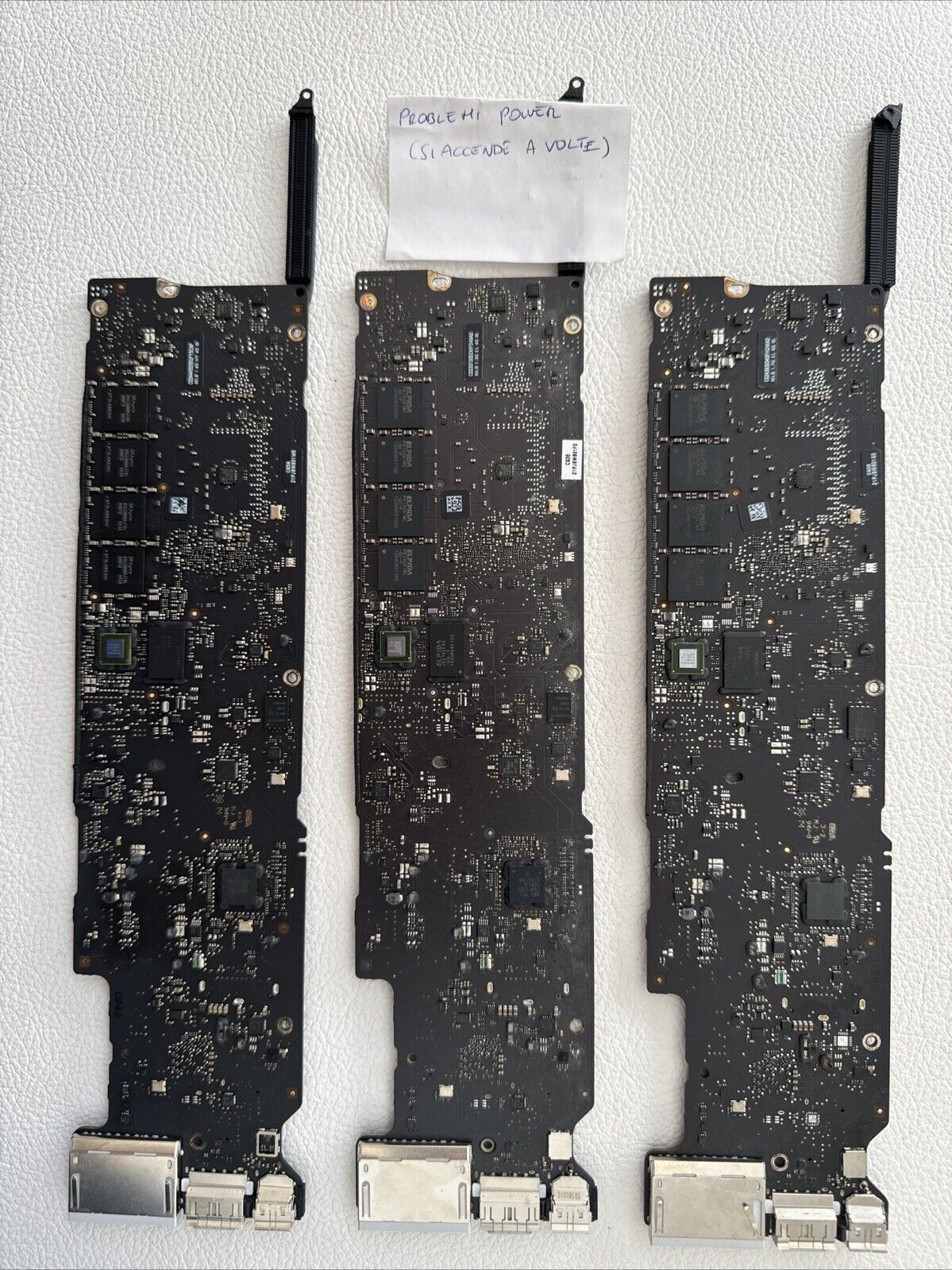

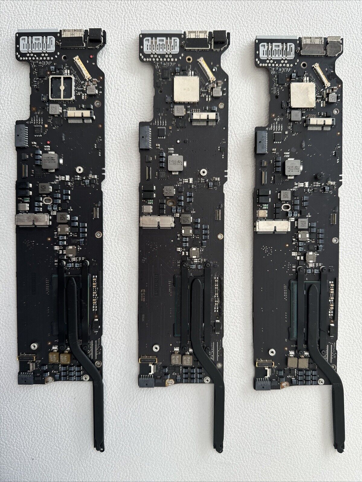

                              Luckily the board I'm attempting to repair already has 8 GB. As for the boards I bought, 2 have 4 GB and 1 has 8 GB according to the pictures:
ID:	3304415 Click image for larger version
                              1. MLB 1.4G HY 4G
                              2. MLB 1.3G EL 4G
                              3. MLB 1.7G EL 8G
                              The sticker on the board at the middle says "POWER PROBLEMS (TURNS ON SOMETIMES)".

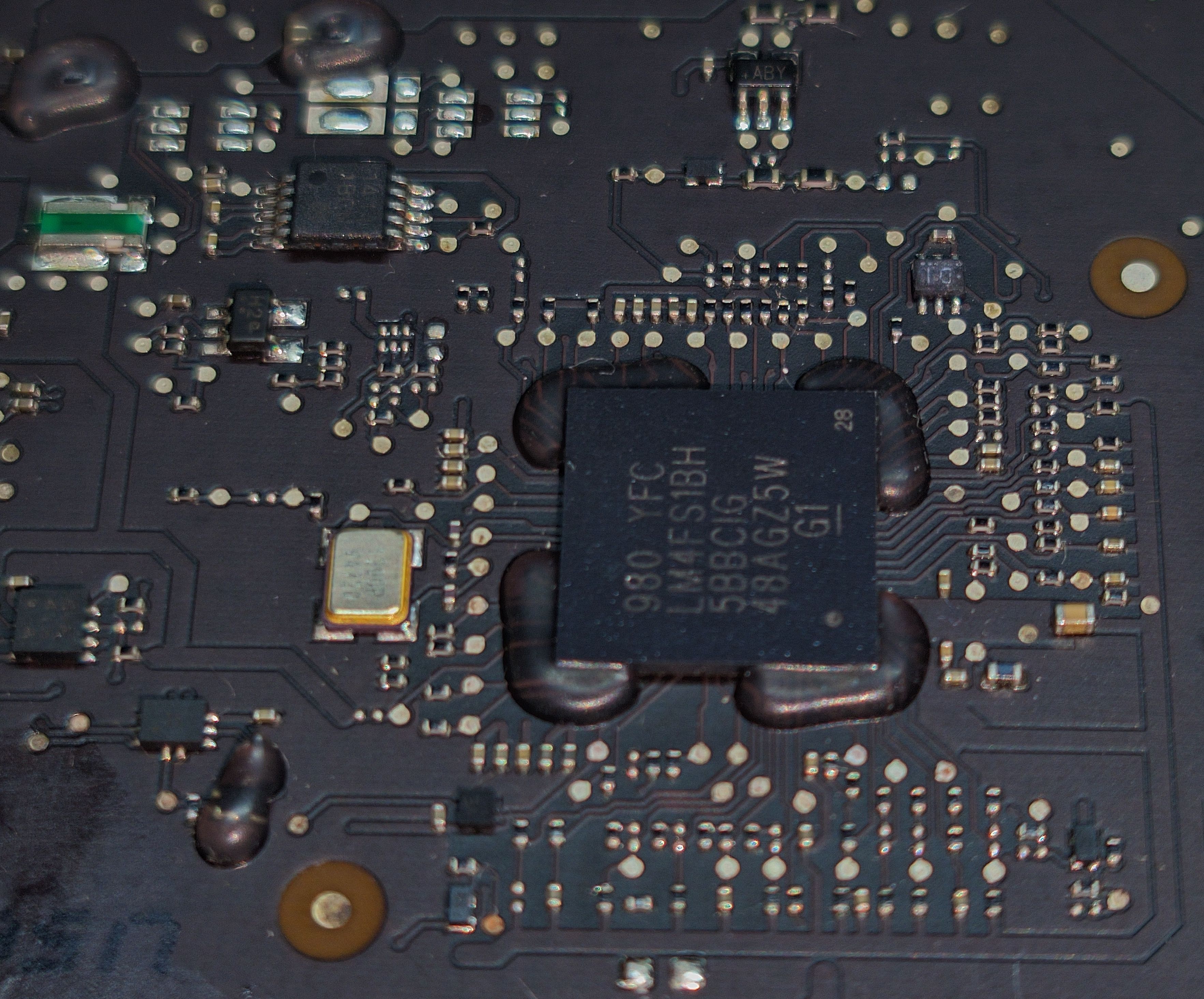

                                I apologize for the delay, it's been a busy month.

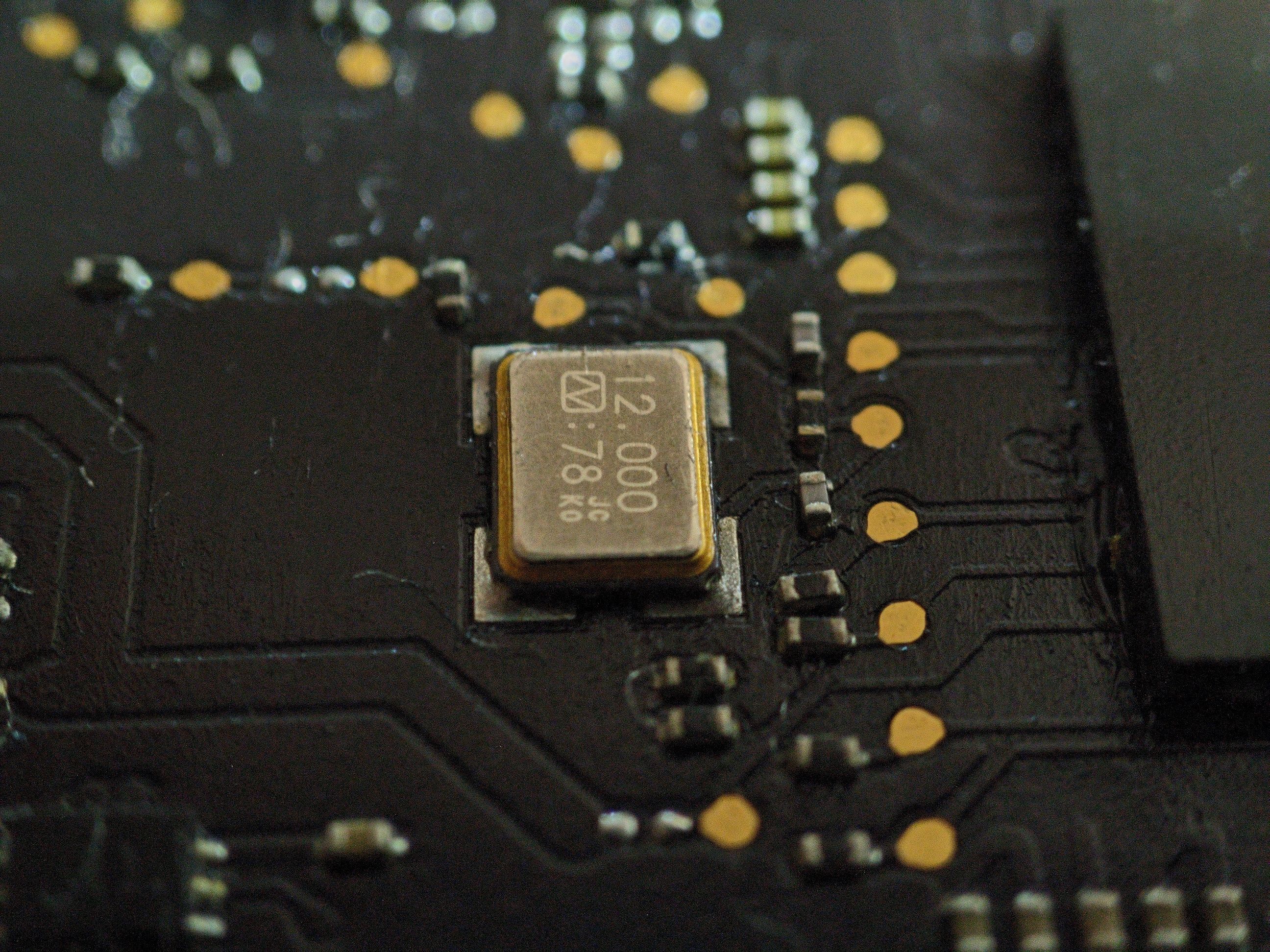

                                Can you believe all three motherboards came with missing SMC_XTAL and SMC_XTAL_R​? Let me elaborate...

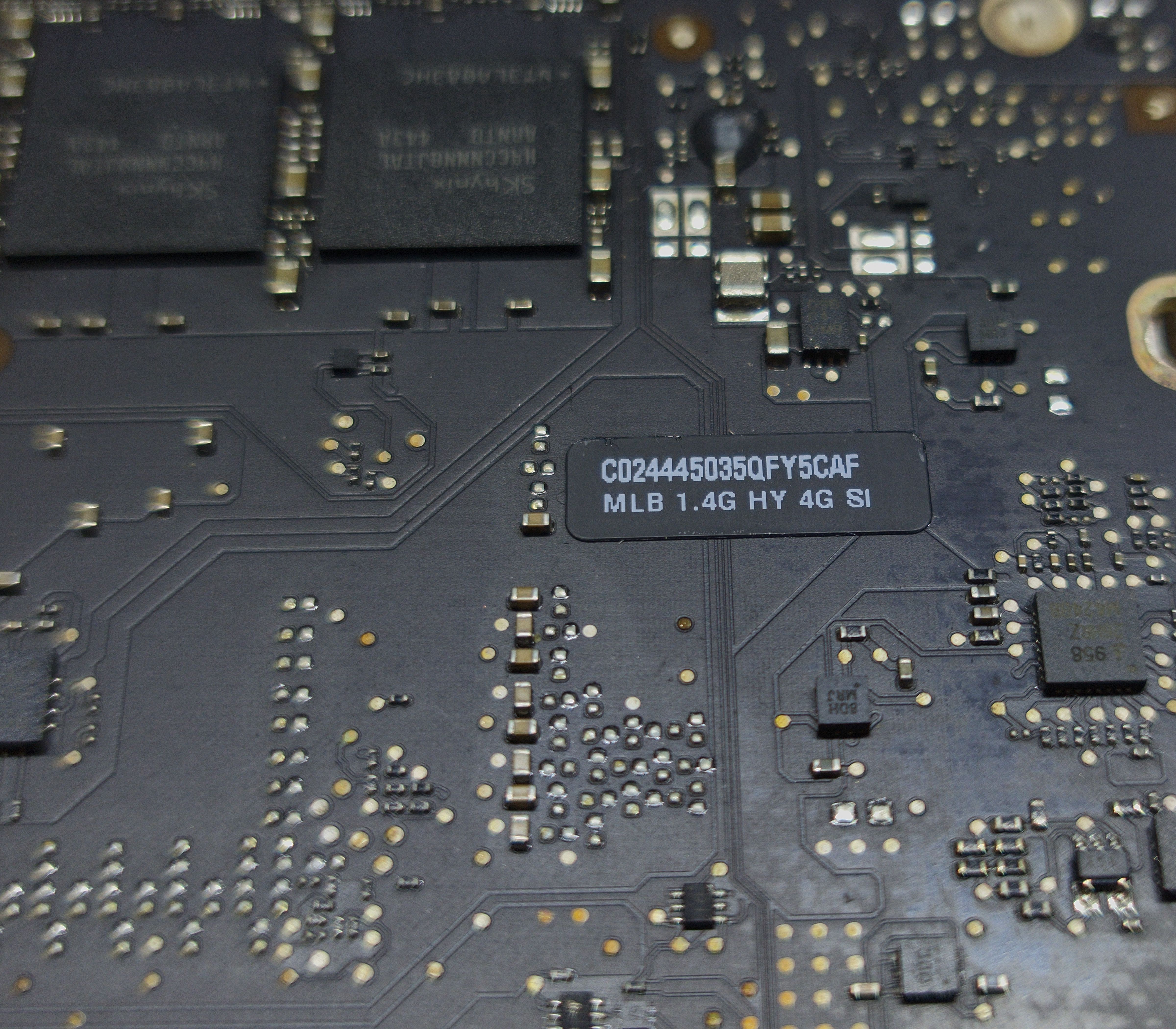

                                MLB 1.4G HY 4G
                                Very clean board, no visible corrosion.
ID:	3321529 Click image for larger version
                                Reflowed the SMC, no luck.

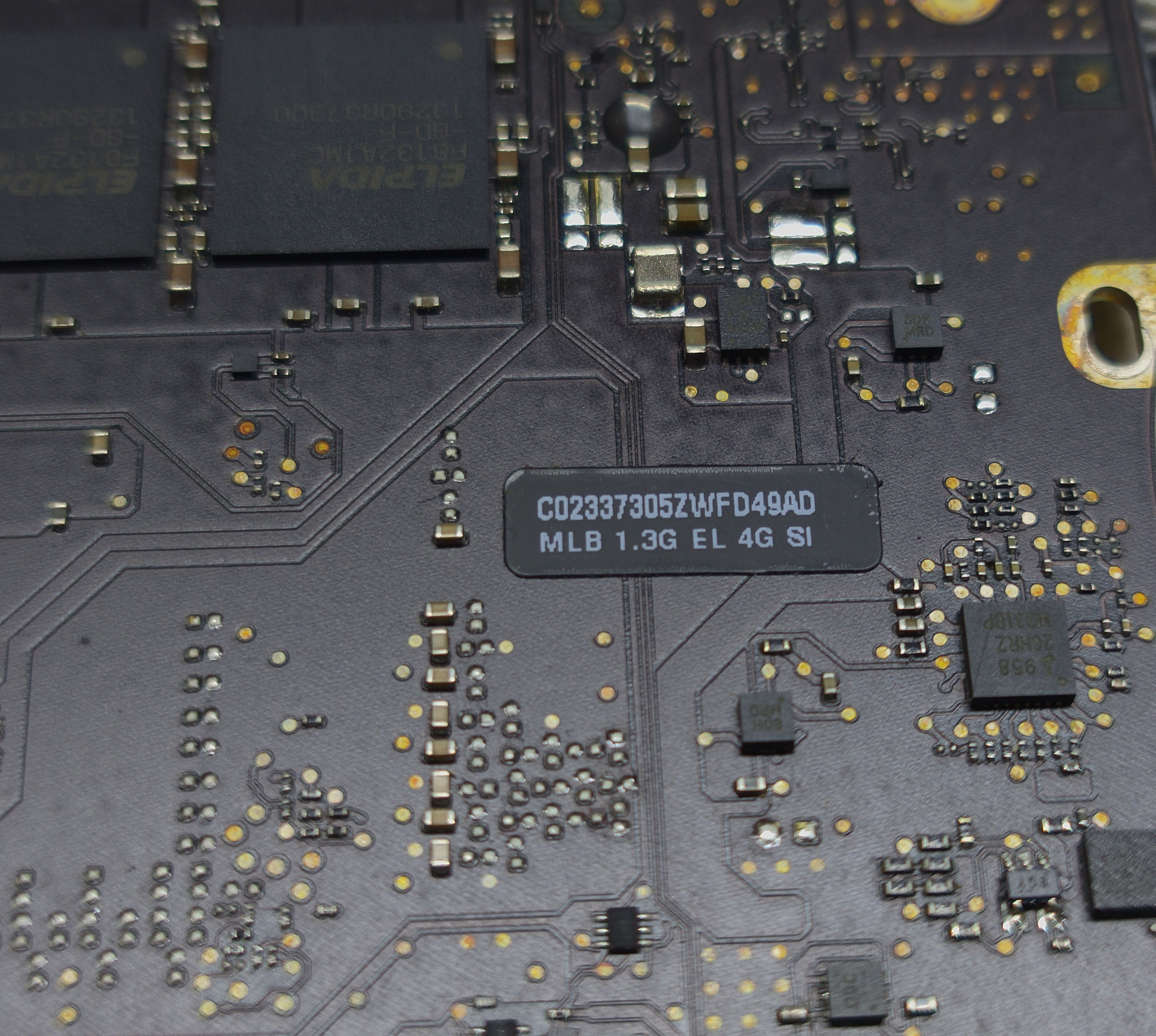

                                MLB 1.3G EL 4G
                                Visible corrosion and a hint ("turns on sometimes"). Attempted several times to turn it on, without success.
ID:	3321532 Click image for larger version
ID:	3321531 Click image for larger version
                                Cleaned the corrosion, reflowed the affected areas (SMC included) and the board seemed to work fine. Until it suddenly didn't want to turn on again a few hours later.
                                I didn't investigate further because the board is fully installed in the machine right now.

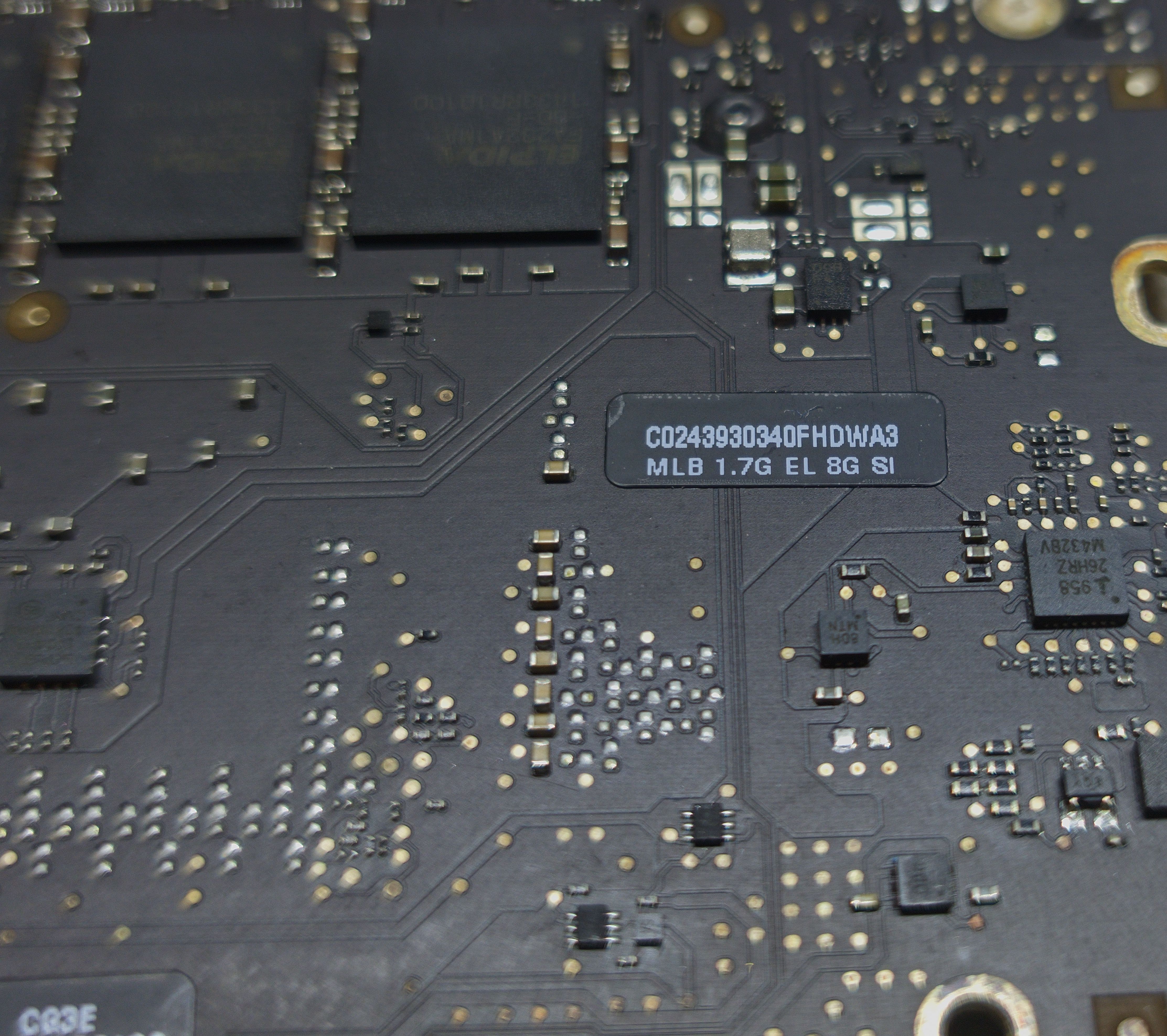

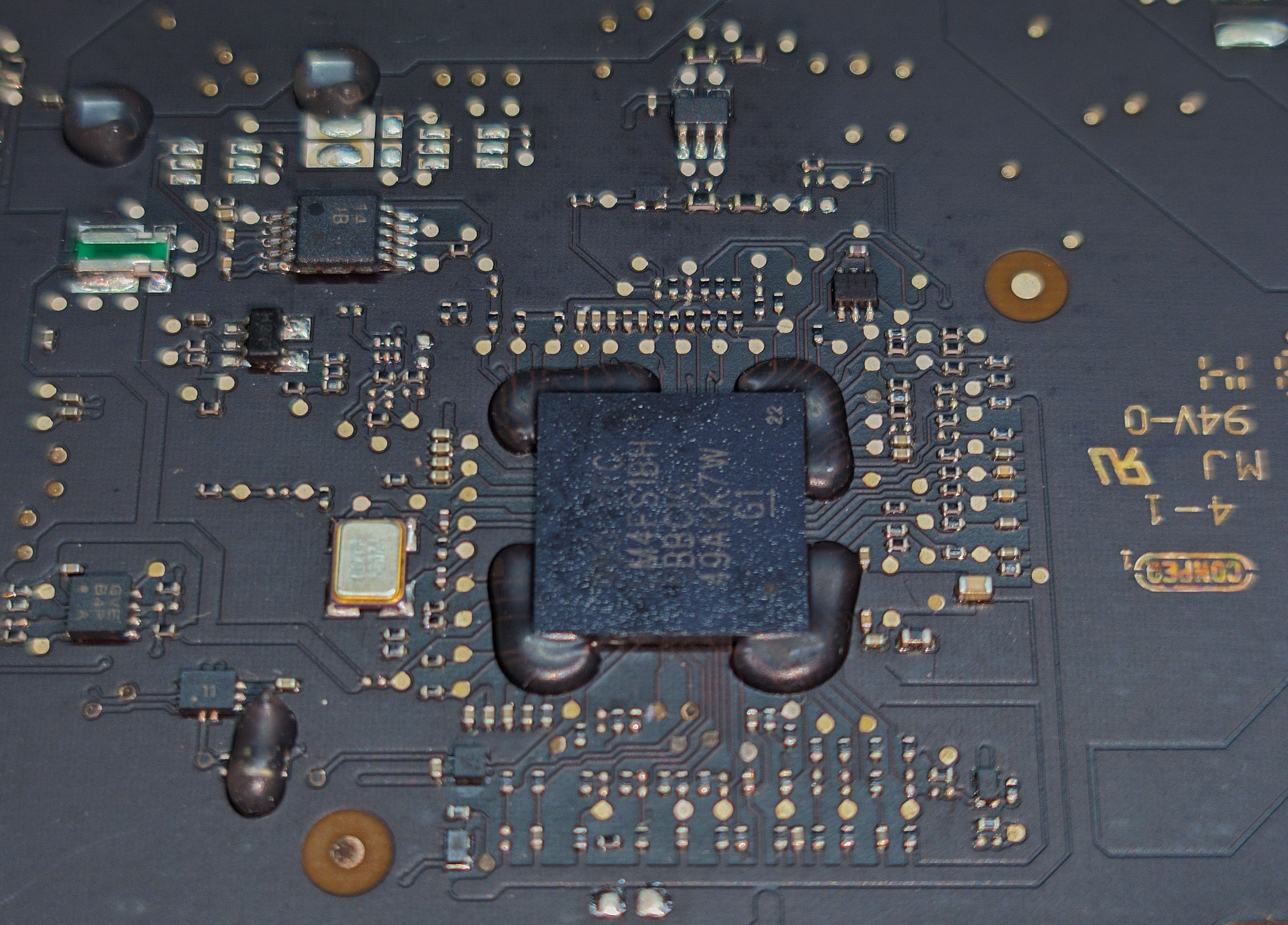

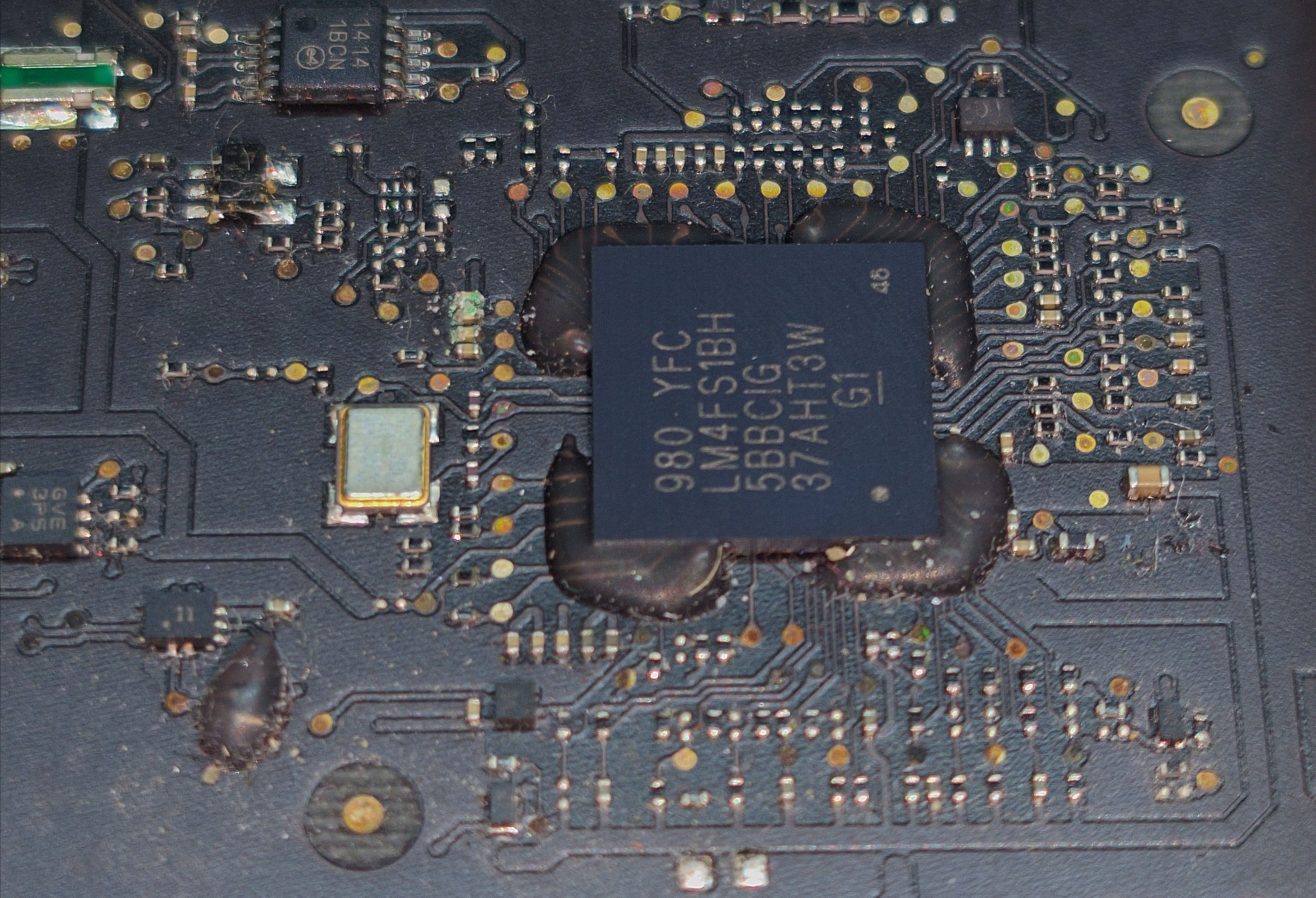

                                MLB 1.7G EL 8G
                                Clean board, no visible corrosion. However, there is a large darker area on the top.
ID:	3321535 Click image for larger version
ID:	3321534 Click image for larger version
                                Reflowed the SMC and the board turned on, but on a second attempt it was dead again. Turns out it only works if I heat up the SMC area a little bit beforehand.
                                This leads me to think the chip itself is defective, because the balls underneath don't get melted unless I set my hot air station to ~370°C. In short: it's not a reflow.
                                Basically, I'm not confident in taking any of the 3 chips to install on the 820-00165-A...

                                    #37
                                    Are those photo's prior to reflow of the SMC? Edge bonding needs to be removed before reflow and 370 degrees is way too low for these boards (in fact I only use that temp to remove the SMC edge bonding). They have a large ground plane that sucks up a lot of heat. Once you remove the edge bonding, you need to eyeball each corner under a microscope to make sure that all the bonding is gone. I use one of the Qianli underfill removal tools to pick at each corner while using some hot air.
                                    Working out what temp is best depends on your hot air station and your nozzle diameter. For example, I use 460 degrees with an air flow of 50 on my Quick TR1300 station with a 10mm nozzle for SMC's. Get the board up to temp first, then apply some flux, then go back in and do the reflow. Flux should be sucked in under the chip, and you should be able to nudge the chip in a corner and see it snap back. That's a proper SMC reflow.
                                    With Magsafe, there are a few issues that can stop a board booting. With some aftermarket chargers, the 165 boards will not boot without a working battery. This is because PM_BATLOW_L is held low. Genuine Magsafe 2 chargers don't have this issue. So with the one wire circuit, no charger light shouldn't stop the board booting with a genuine charger, however it will prevent the battery from being charged.
