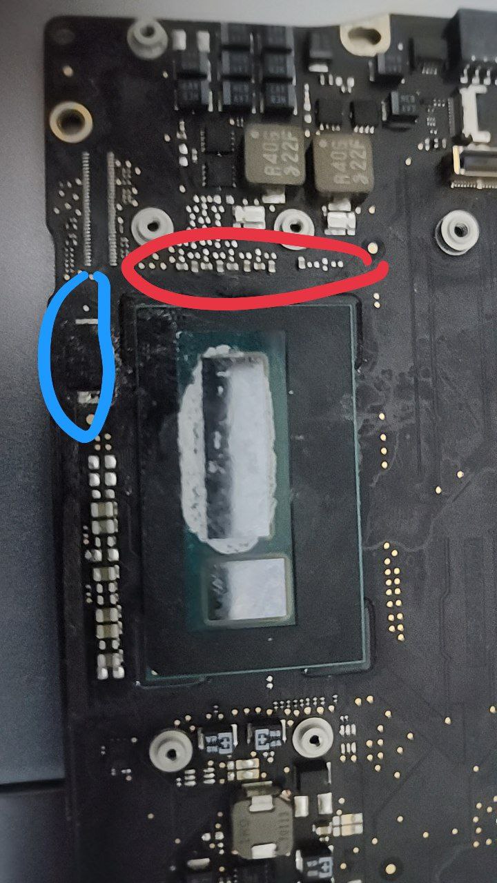

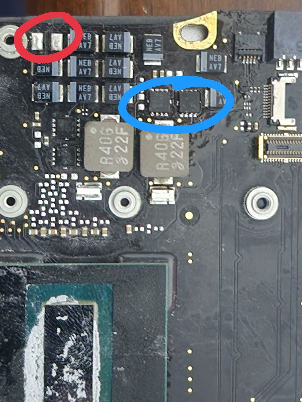

    Hi there i have a Macbook Air A1466 board number 820-00165-A. No power, and has Orange light when plug in to charger. SMC is working and the Fuse is good. Found a Short and removed. But still there is short on mosfet. The short leading to Capacitors near Processor.
    - 2 Mosfet Near The Processor Is Shorted. (Already Tried Injecting 1V, draining 0.07A) Unable to shop the shorted area. Marked Blue.
    - Already Checked Big Capacitor below the processor. (Good Capacitor) Marked Blue.
    - Found a short and solved the issue. ( Red marked Big Cap)
    Anyone have solution or method to check please let me know. Thanks.

    Low voltage rails will be with a low resistance.
    Is the power adapter the original?
    Do you see a green magsafe light when the adapter is connected?
    What is the voltage to ground of ppbus_g3h ?
    Confirm the voltage to ground of the 3v42 rail.

      adapter is in orange light, ppbus_g3h present and 3v42 rail is present

          Follow the power sequence as what you have provided is not really helpful from an advice point of view.
          https://logi.wiki/index.php/G3_to_S3..._and_Broadwell
          Vcore on MBA is usually around 10 ohms or so. PCH should be around 150 ohms or so at ambient temperature.

                thanks. current status of the unit just GREEN LIGHT then ORANGE LIGHT. with missing "PM_SLP_S5_L = 3.3V" VOLTAGE. board had corrosion on U8180. i already replaced U8180 and lines were okay around U8180.
