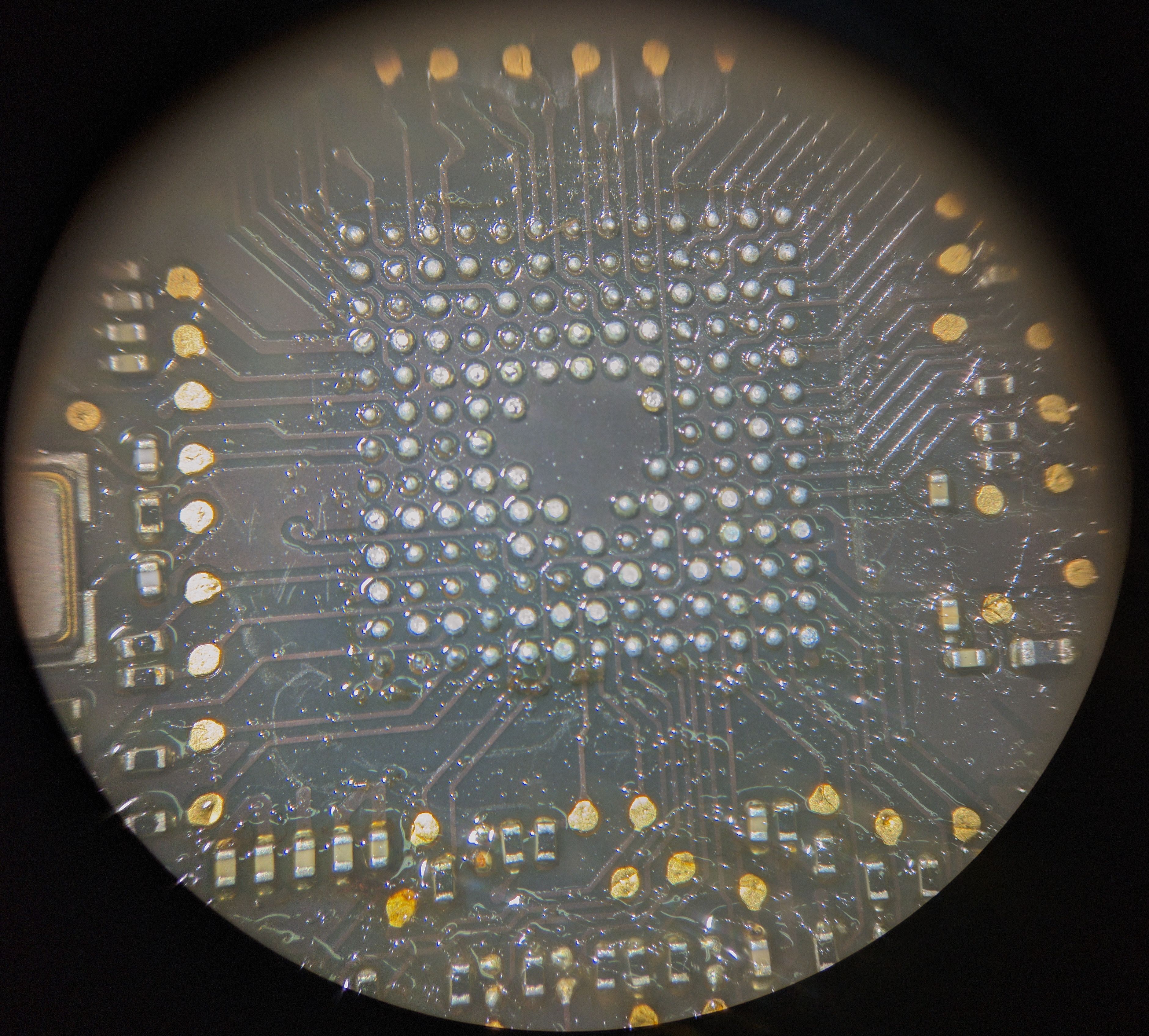

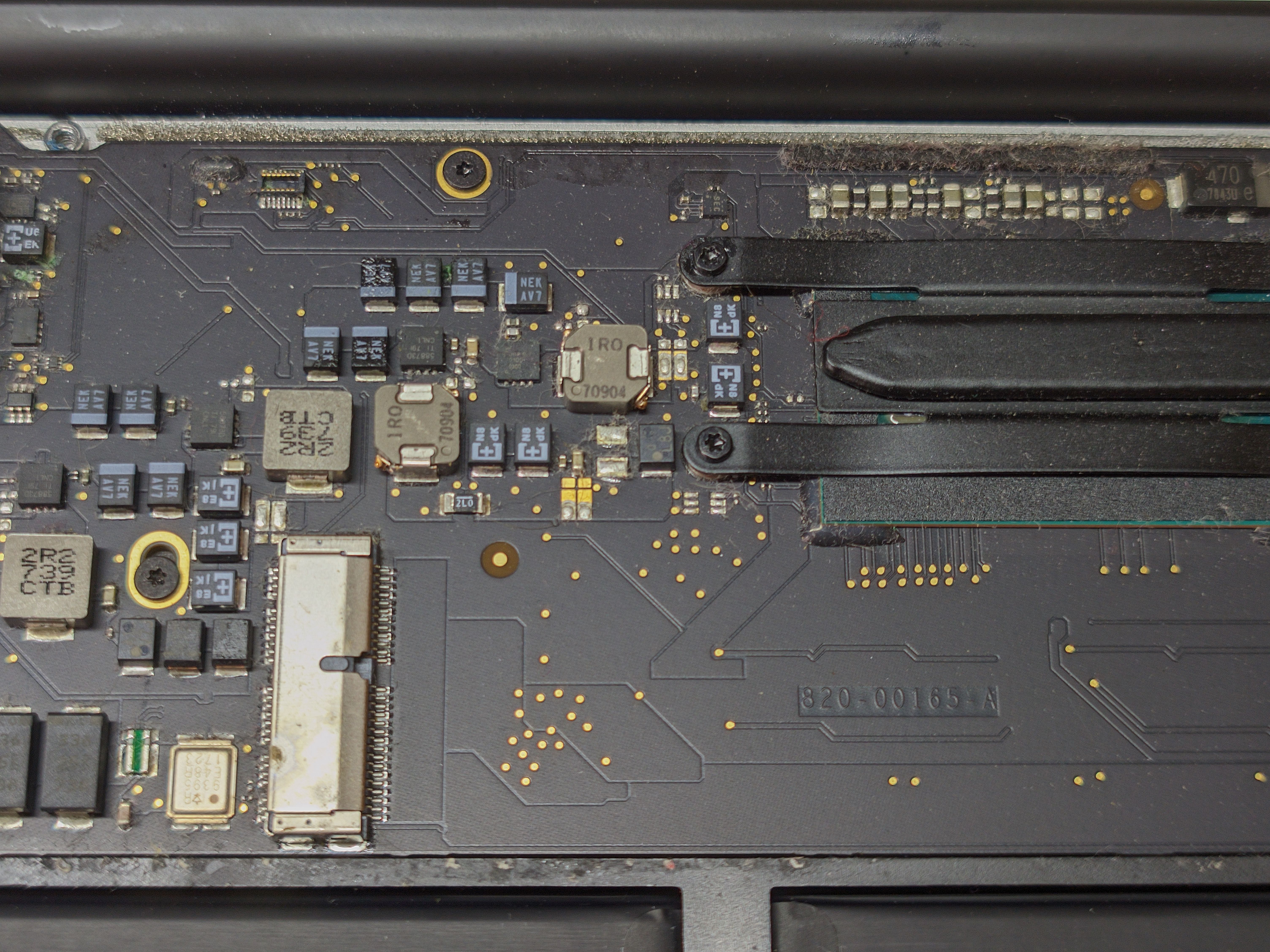

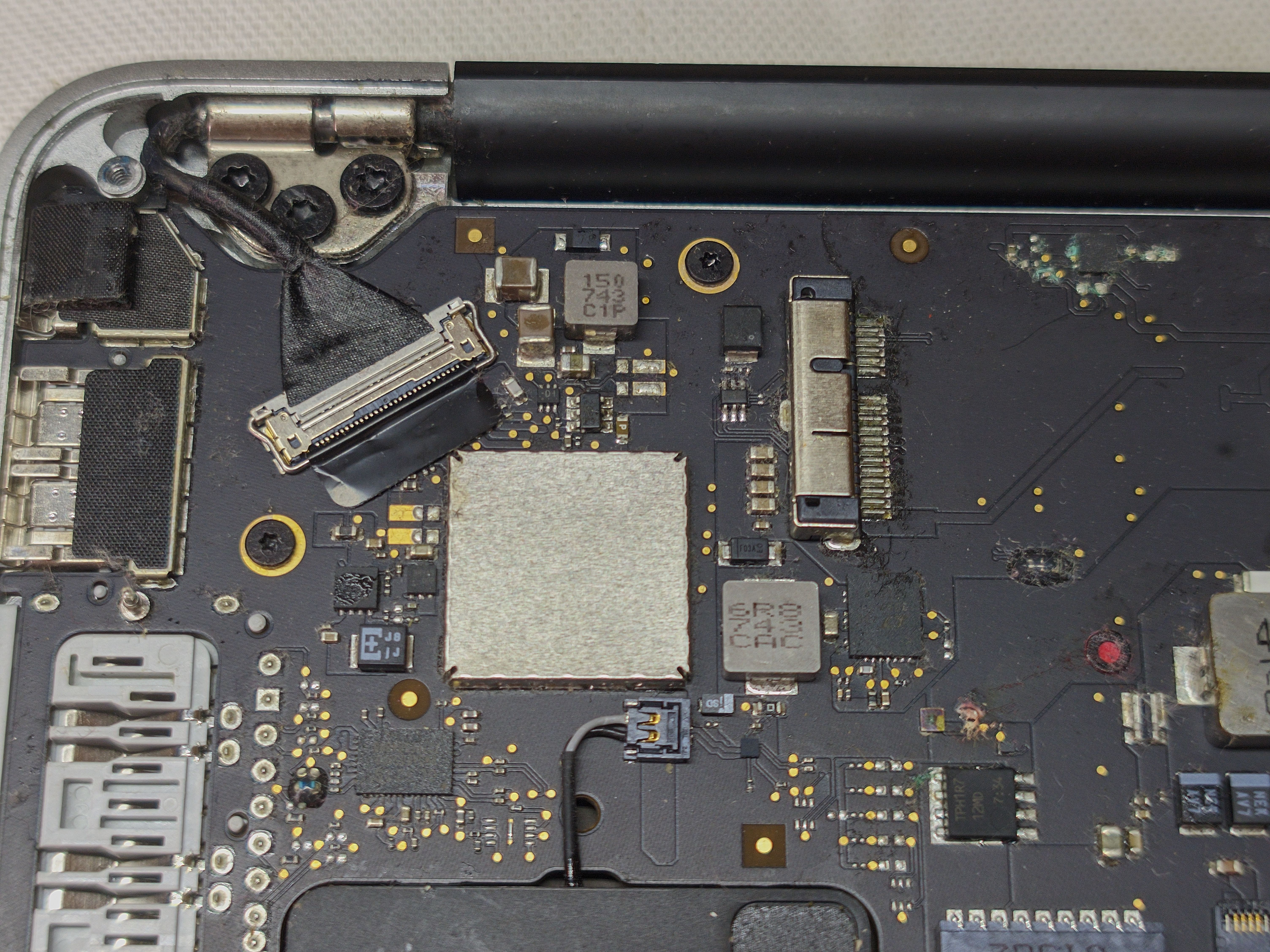

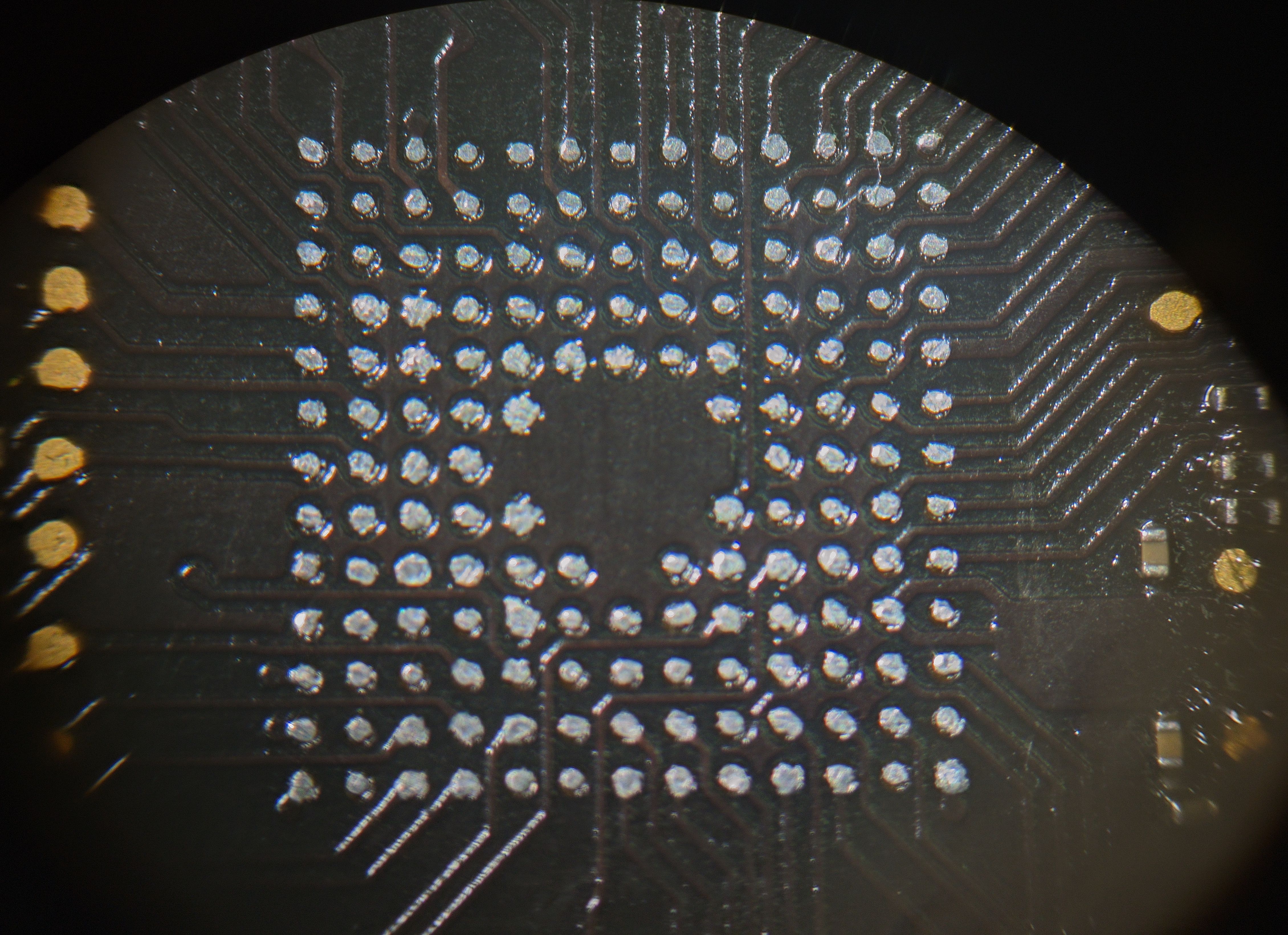

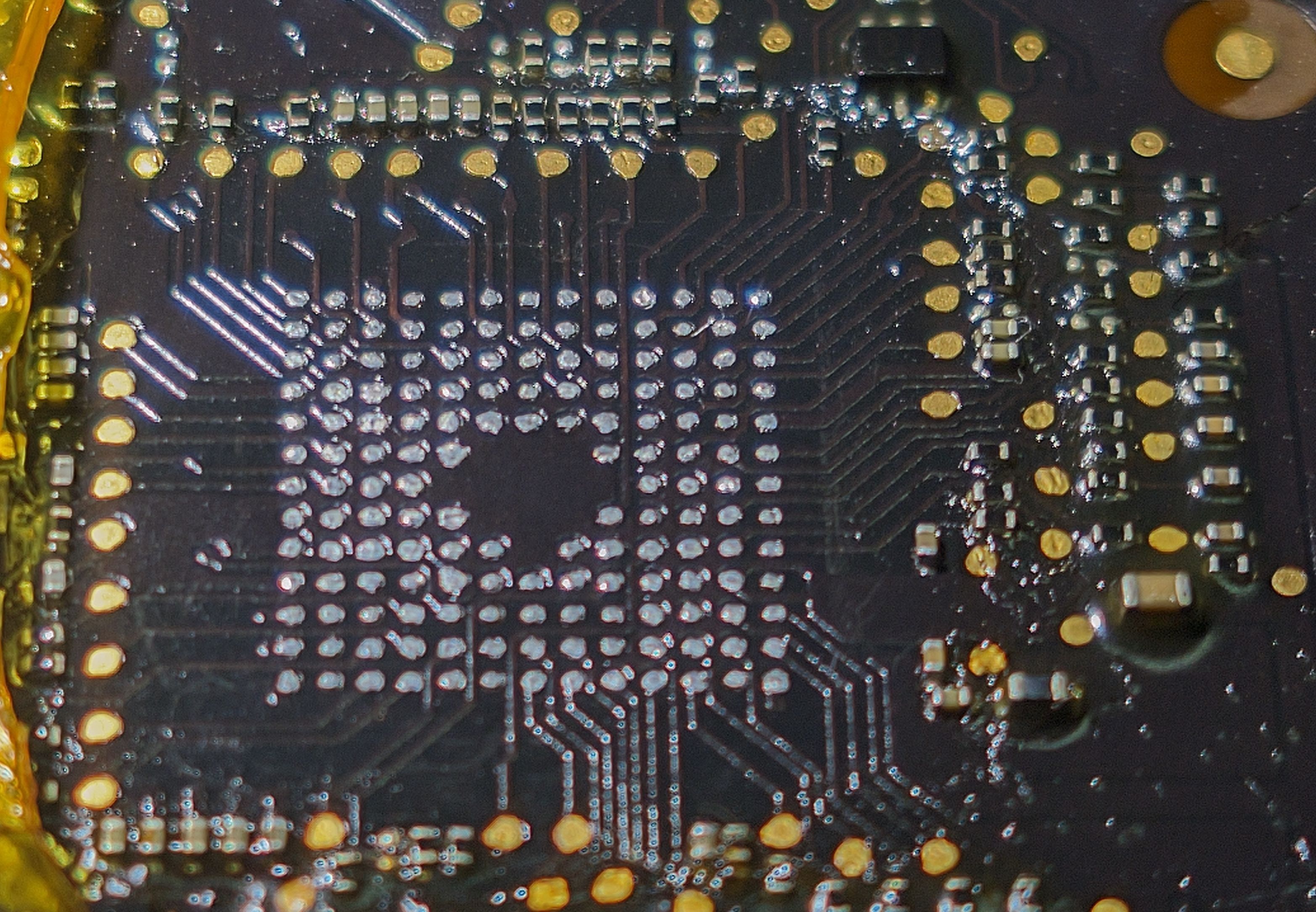

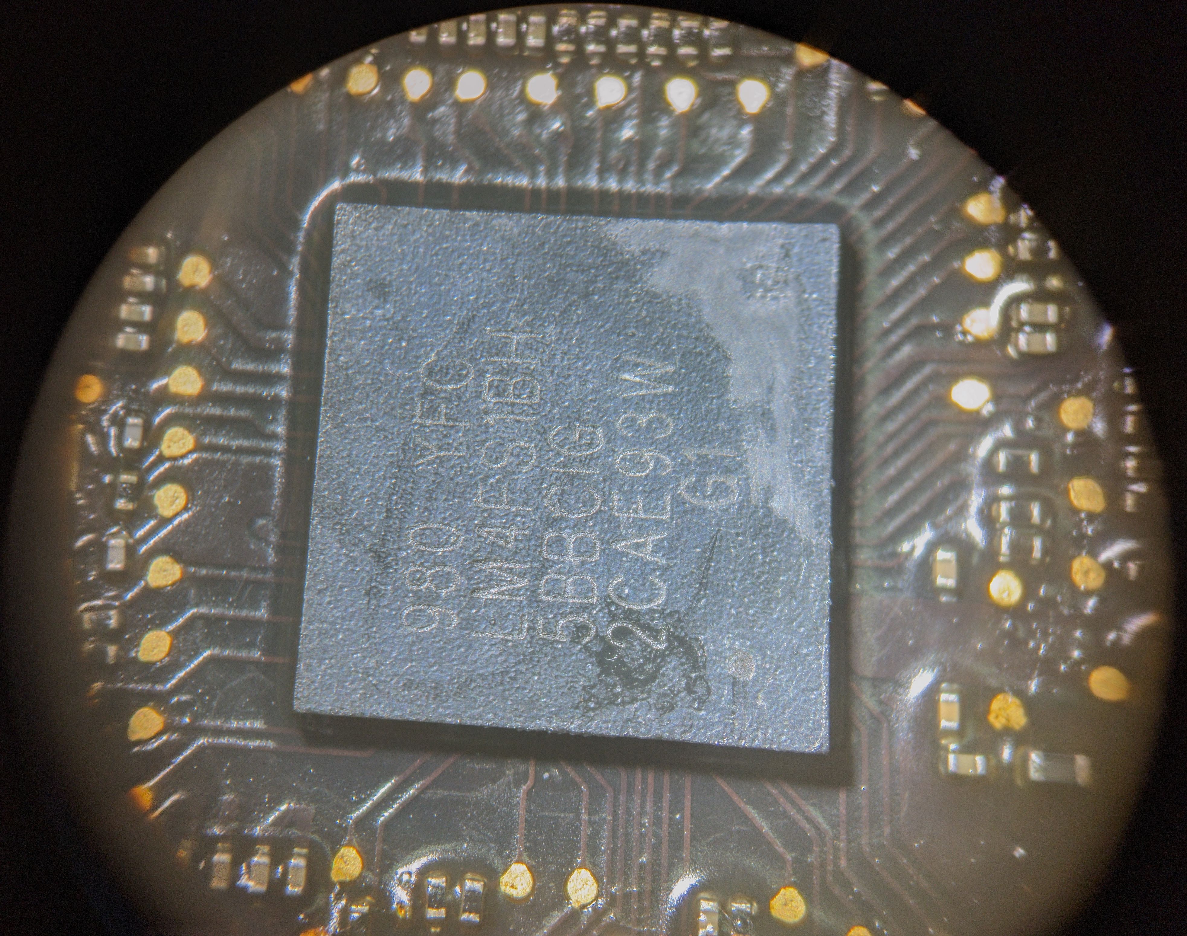

    I was brought the computer as it showed no sign of life. Upon opening it I immediately noticed liquid damage in at least one critical spot.
ID:	3293648 Click image for larger version
ID:	3293649 Click image for larger version
    I got rid of J6100 and cleaned/reflowed the other spots. C5126 was broken and as a result it's now missing from the board (should I replace it before investigating further?).
    I didn't take a picture of the bottom as there was nothing to see in particular aside from mild corrosion on R5100, which I cleaned and I also made sure that it measures ~100kΩ.​
    As far as I can tell, everything appears to be in order except for SMC_MANUAL_RST_L being ~0.8V and SMC_RESET_L being ~3.0V. The power adapter is original and I'm sure that it works, but unfortunately I don't have another DC board to test.
    However, if I understood the power-up sequence correctly, there is either a problem on U5000 or U5110 depending on which of the two signals is supposed to be pulled up first.
    Thanks in advance.

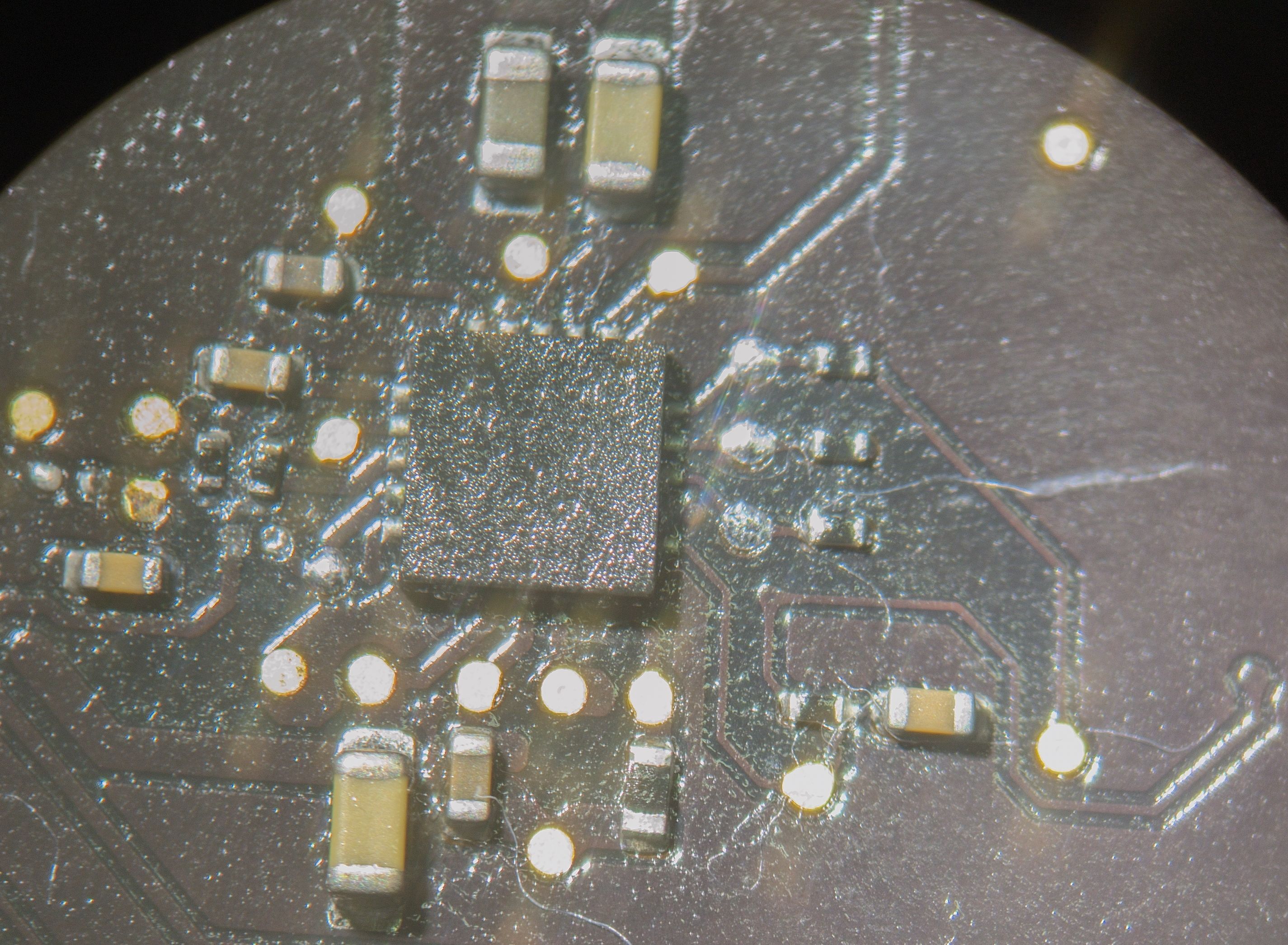

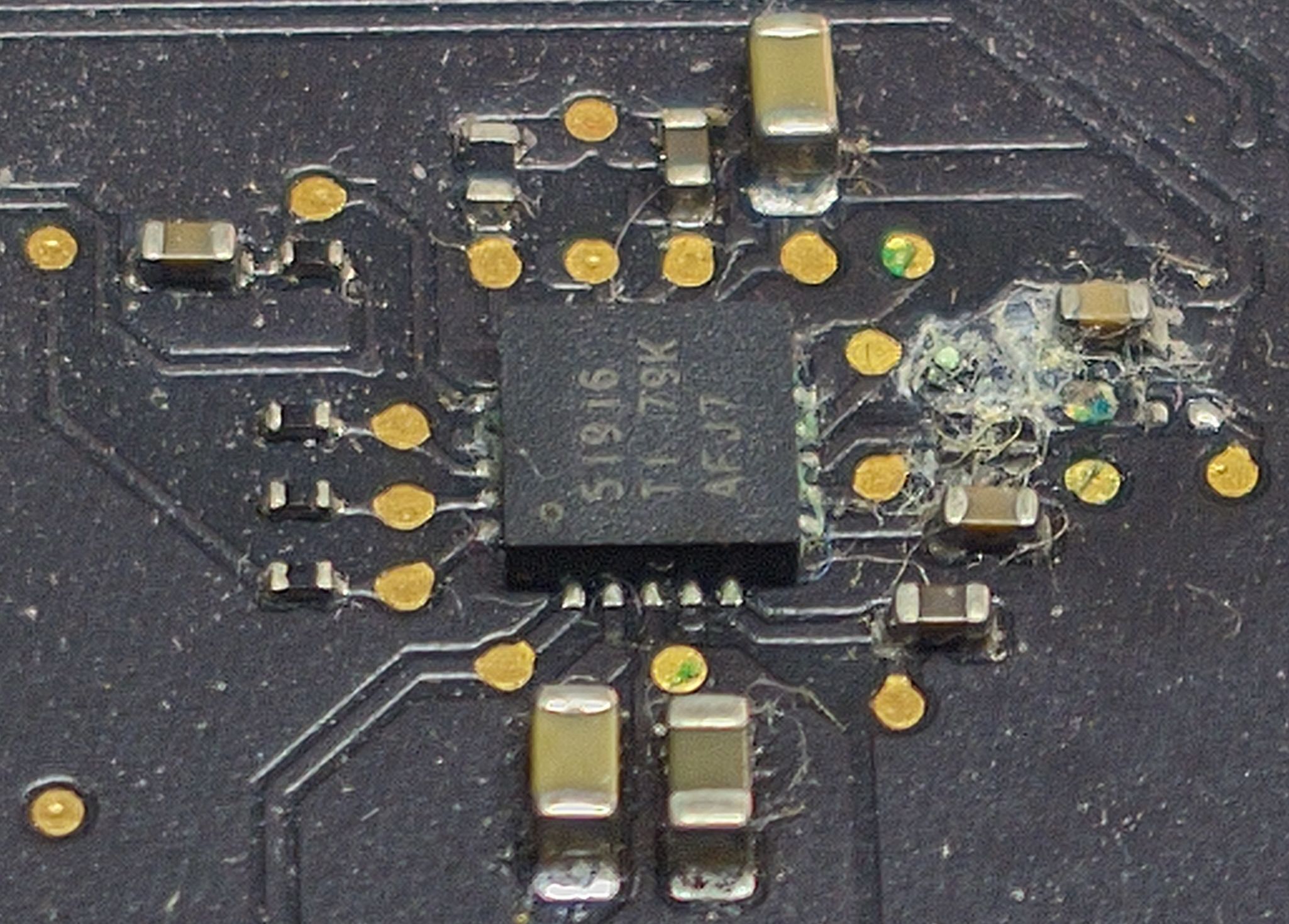

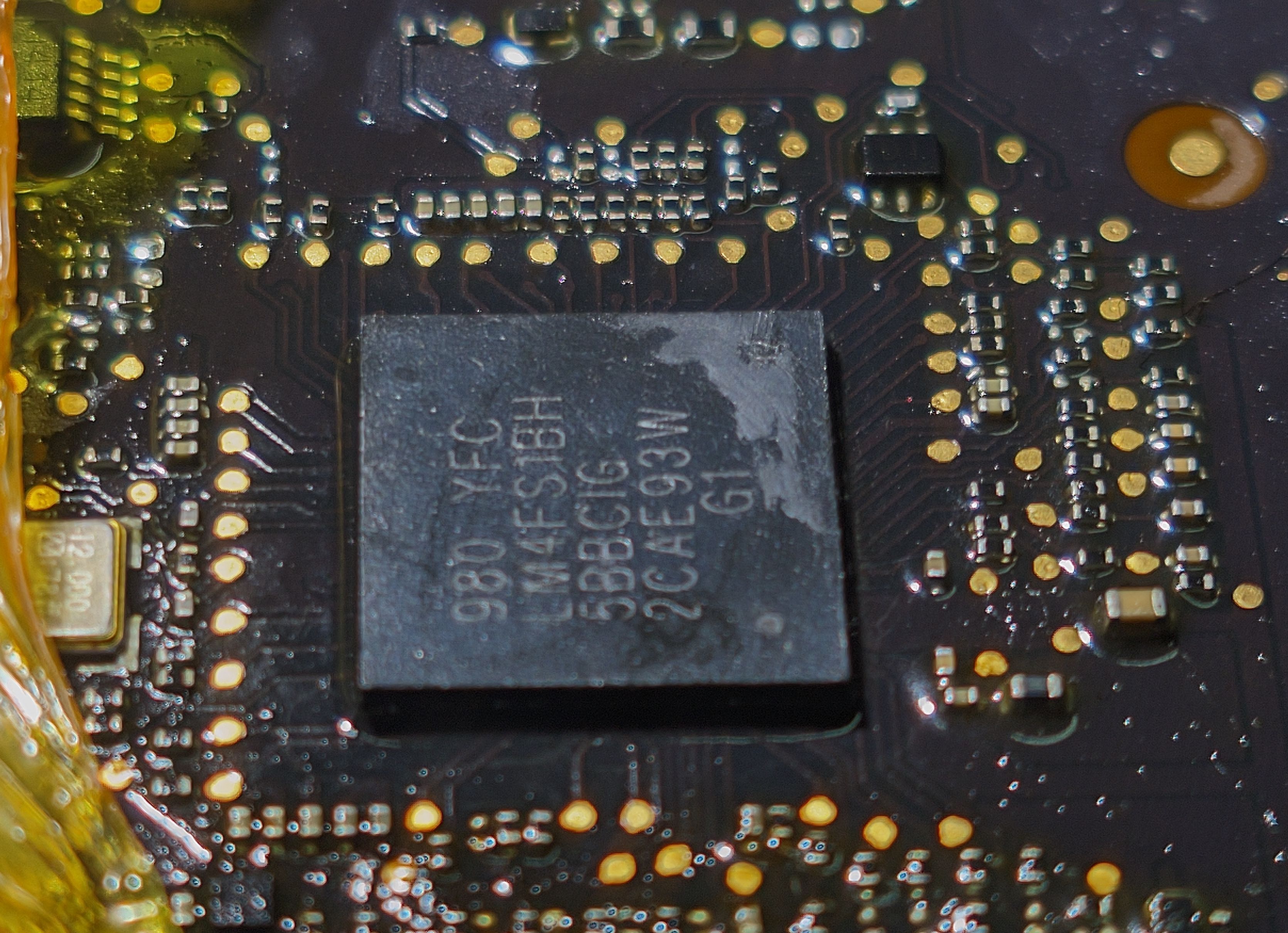

          While inspecting the SMC side I spotted some corrosion around U7400:
          Click image for larger version  Name:	4.jpg Views:	0 Size:	393.8 KB ID:	3293999
          But the U5000 area looks good.
          PPBUS_G3H: 8.65V
          C5001: 3.428V
          PP3V3_S5_AVREF_SMC: 3.322V
          PP1V2_S5_SMC_VDDC: 1.224V
          SMC_EXTAL: ~0.060V
          SMC_XTAL: 0.000V

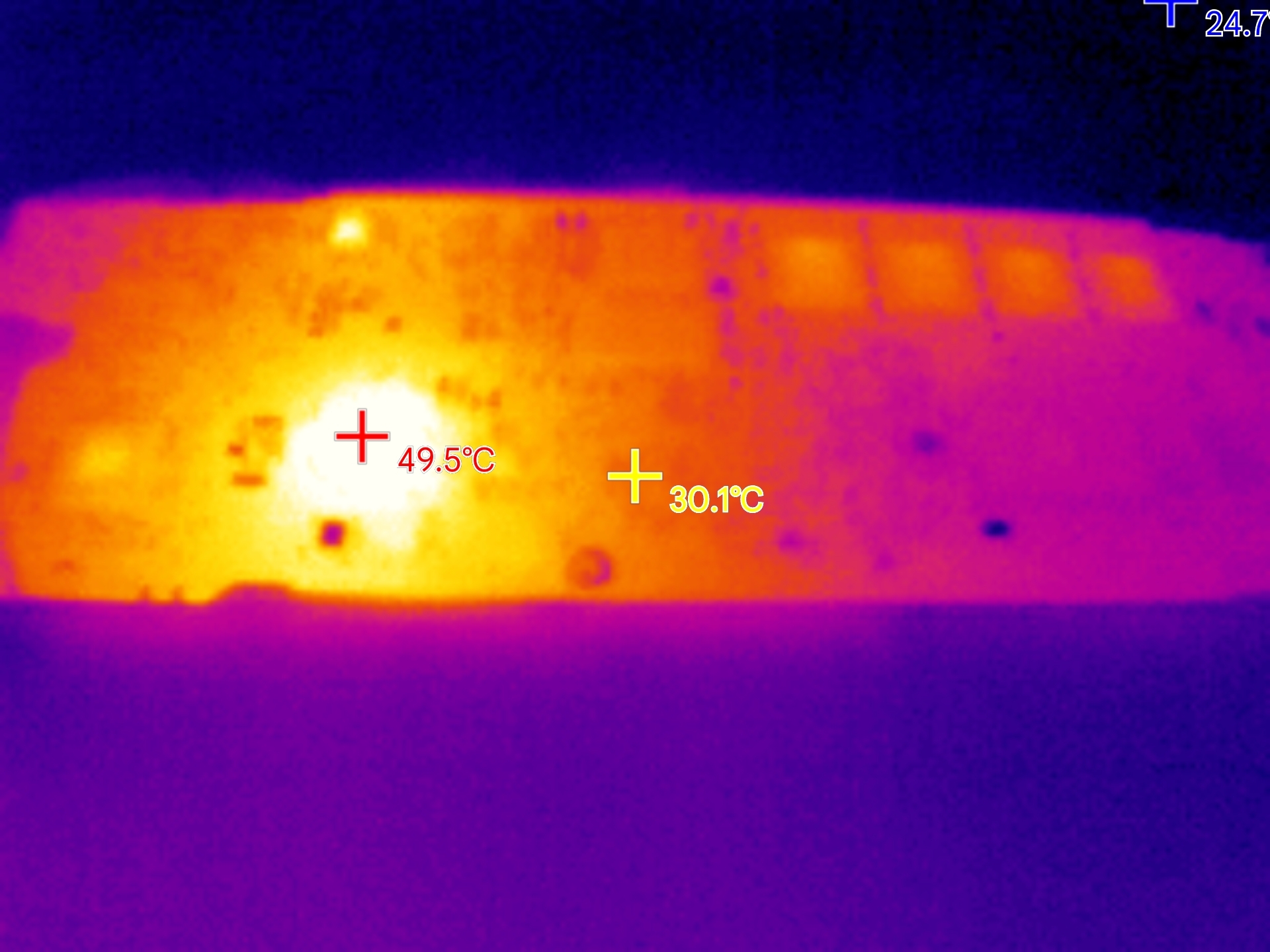

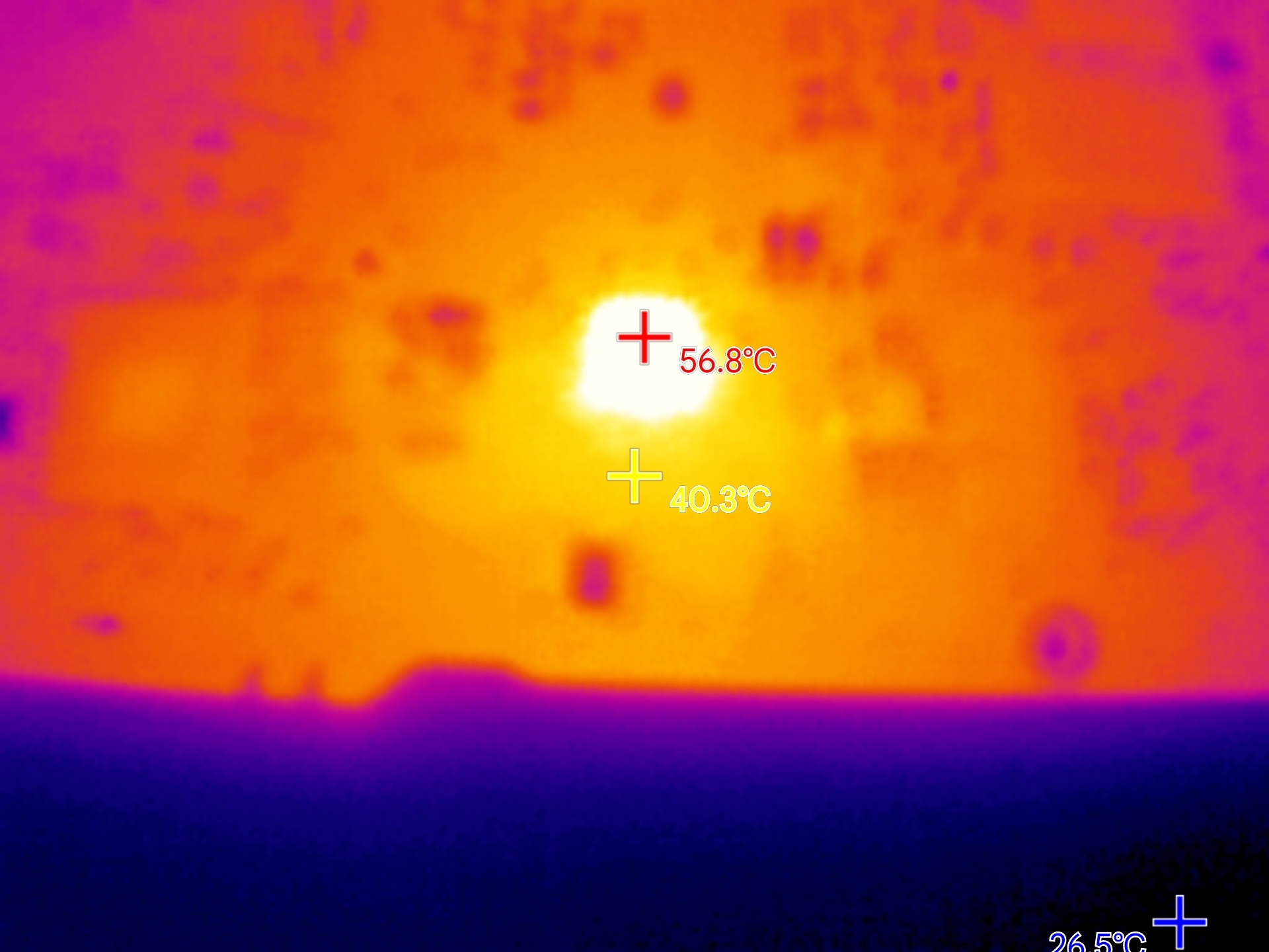

          I took a look with my thermal camera and the SMC looks quite hot (~57°). Is it expected or a sign of malfunction?

          • mon2
            • Dec 2019
            • 14662
            Was the swamp juice around U7400 cleaned up with IPA?
            The SMC, to me, is way too hot. Wait on other comments but I would at least consider to flux and reflow the component. Perhaps similar issues underneath the component. The SMC is available only from other donor boards.
            • davidebeatrici
              • Dec 2020
              • 128
              • Italy
              The U7400 area is the only spot I haven't cleaned yet as I only noticed it while reporting back here. I will take care of that while reflowing U5000 later today.

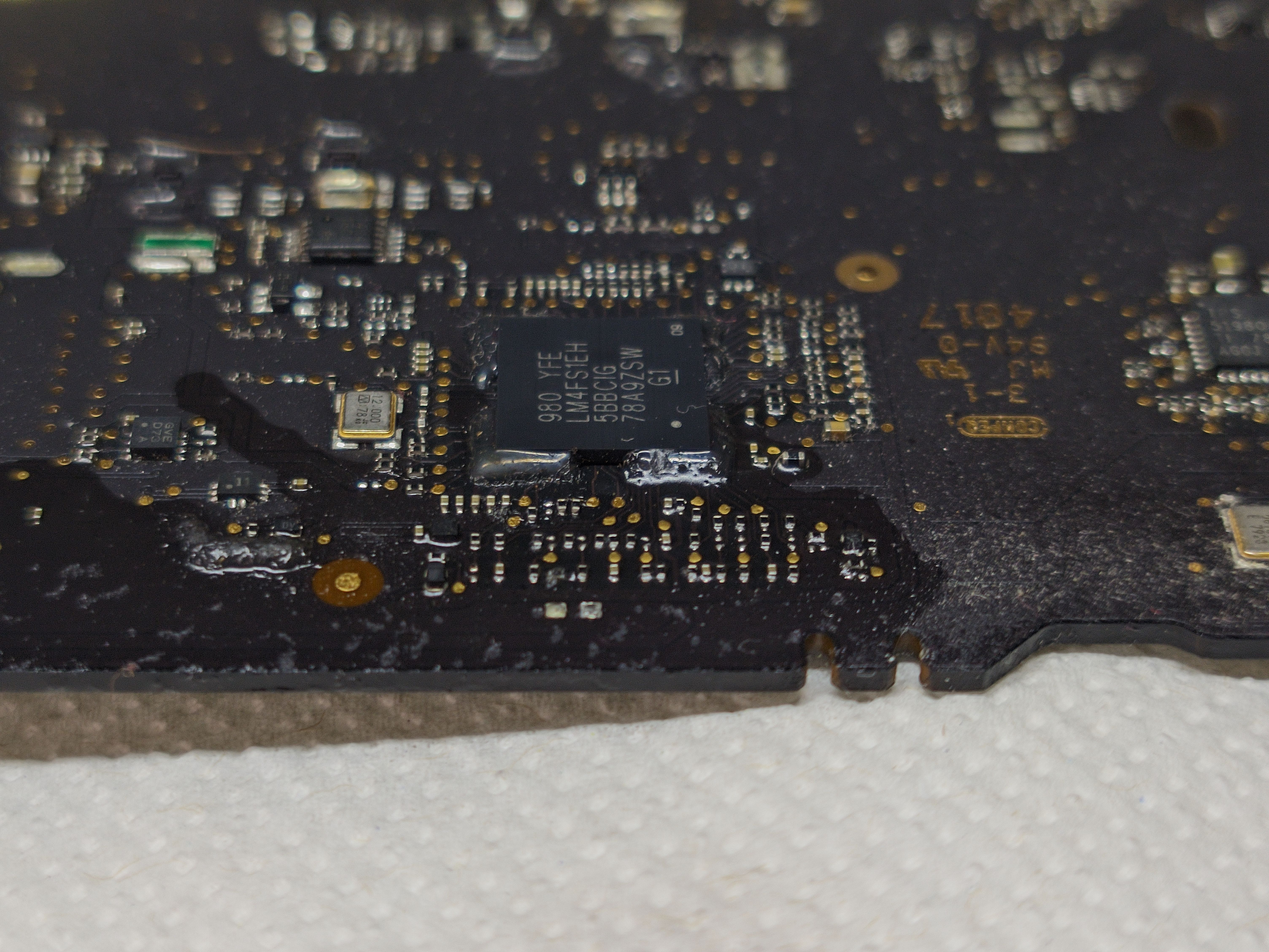

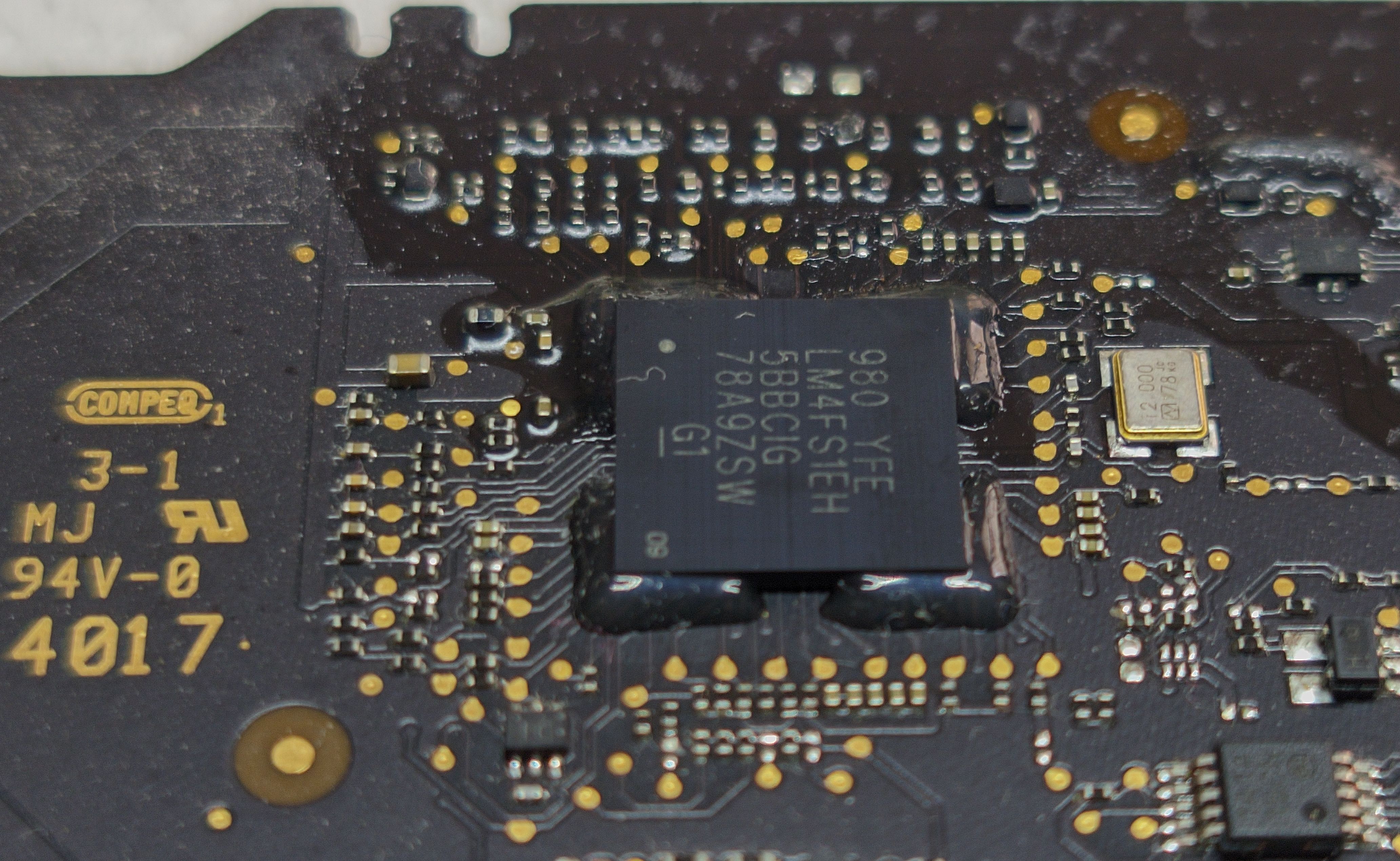

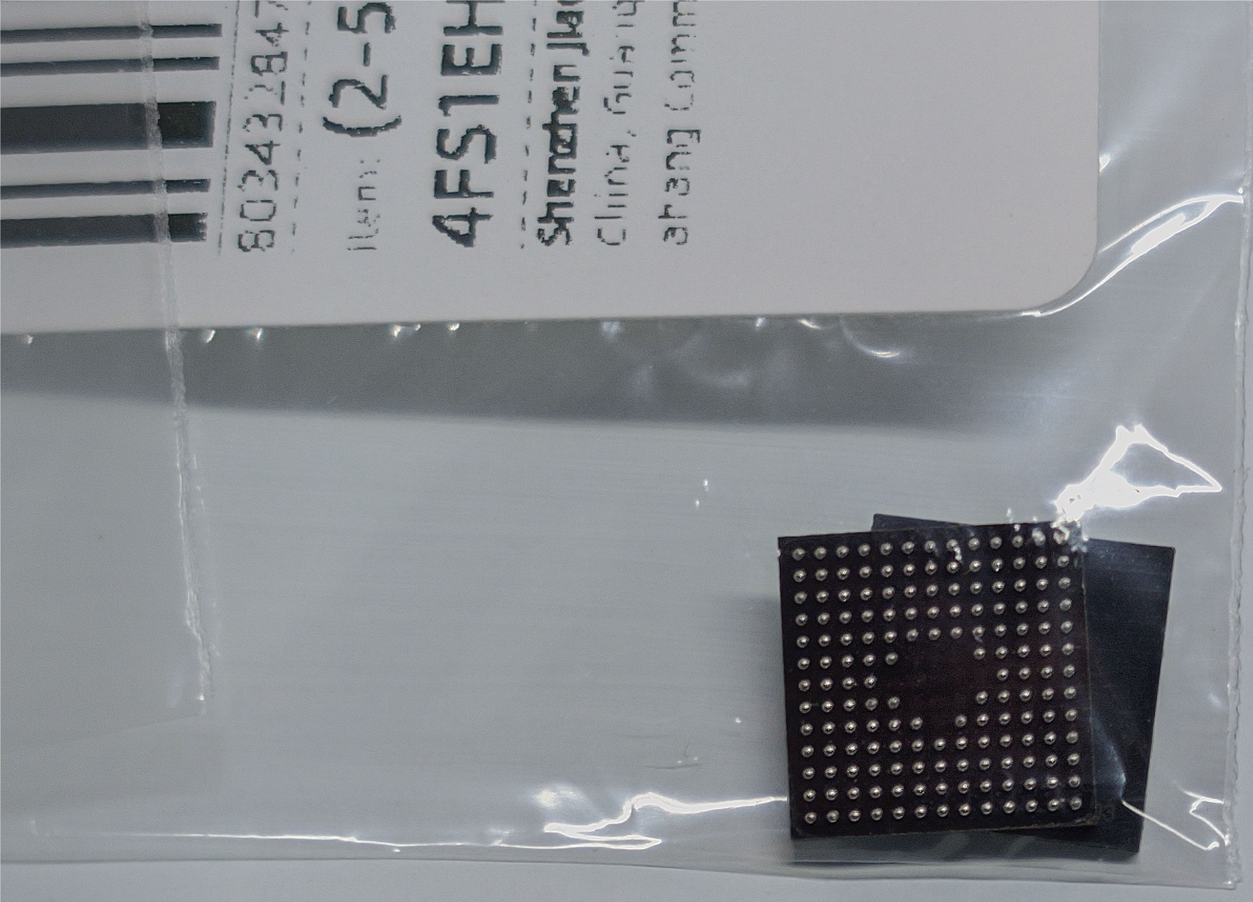

                Bias for Xtal should be 1V. SMC is likely dead. You can swap from a 820-3437 board and reprogram it for 820-00165.
                • davidebeatrici
                  • Dec 2020
                  • 128
                  • Italy
                  How's the reprogramming process? Because I can easily find the chip for sale at a good price online, if it's allowed I can leave links here.
ID:	3294085 Click image for larger version
                  • reformatt
                    • Feb 2020
                    • 1495
                    Donor board is best from eBay etc. Donor boards from China are a lottery, the SMC's pads are often corroded and need scraping, retinning with flux/paste prior to reballing.
                    Use Muerto's SMC tool from GitHub.
                    https://github.com/MuertoGB/SMCTool/releases/tag/v1.0.7

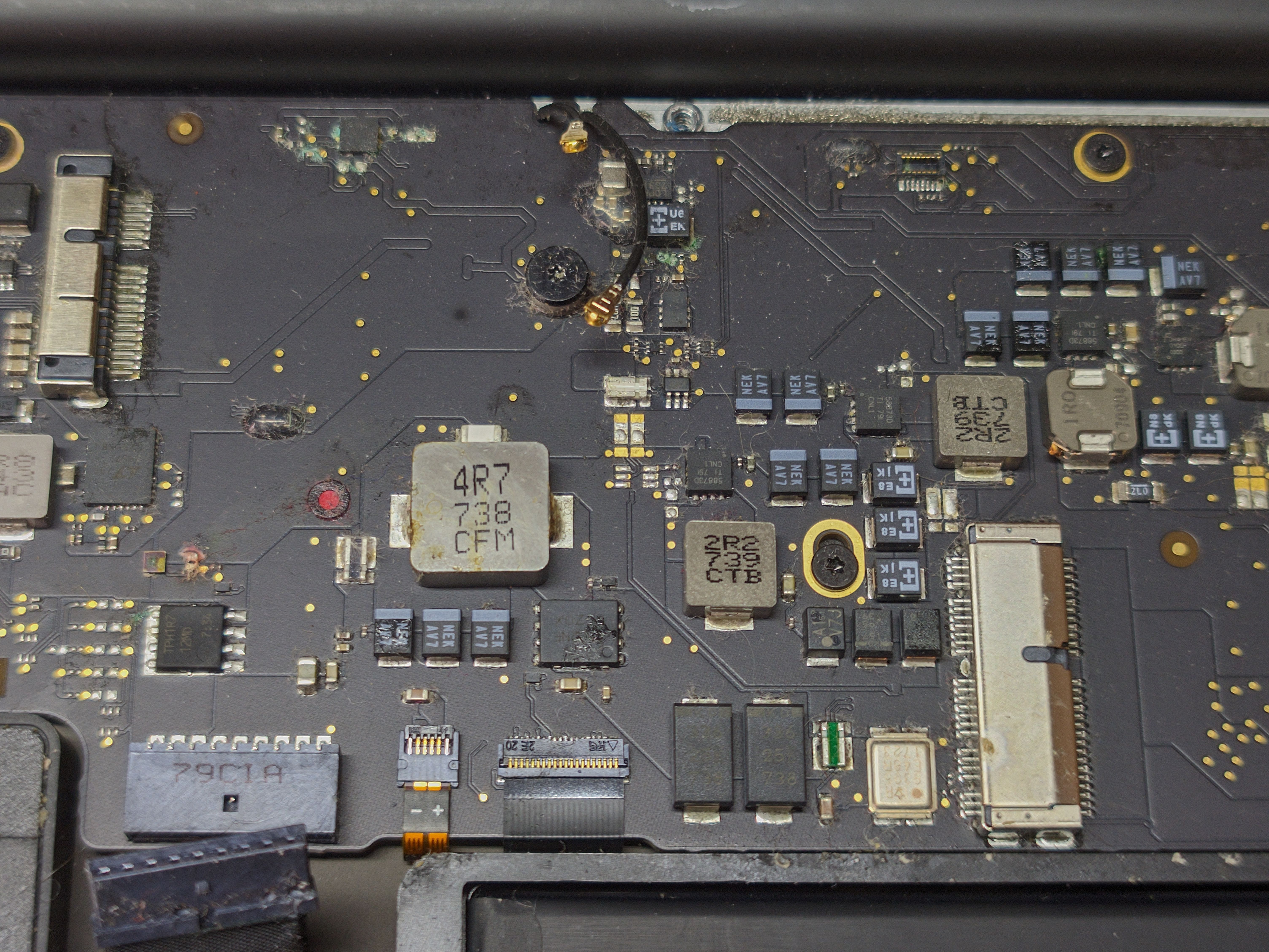

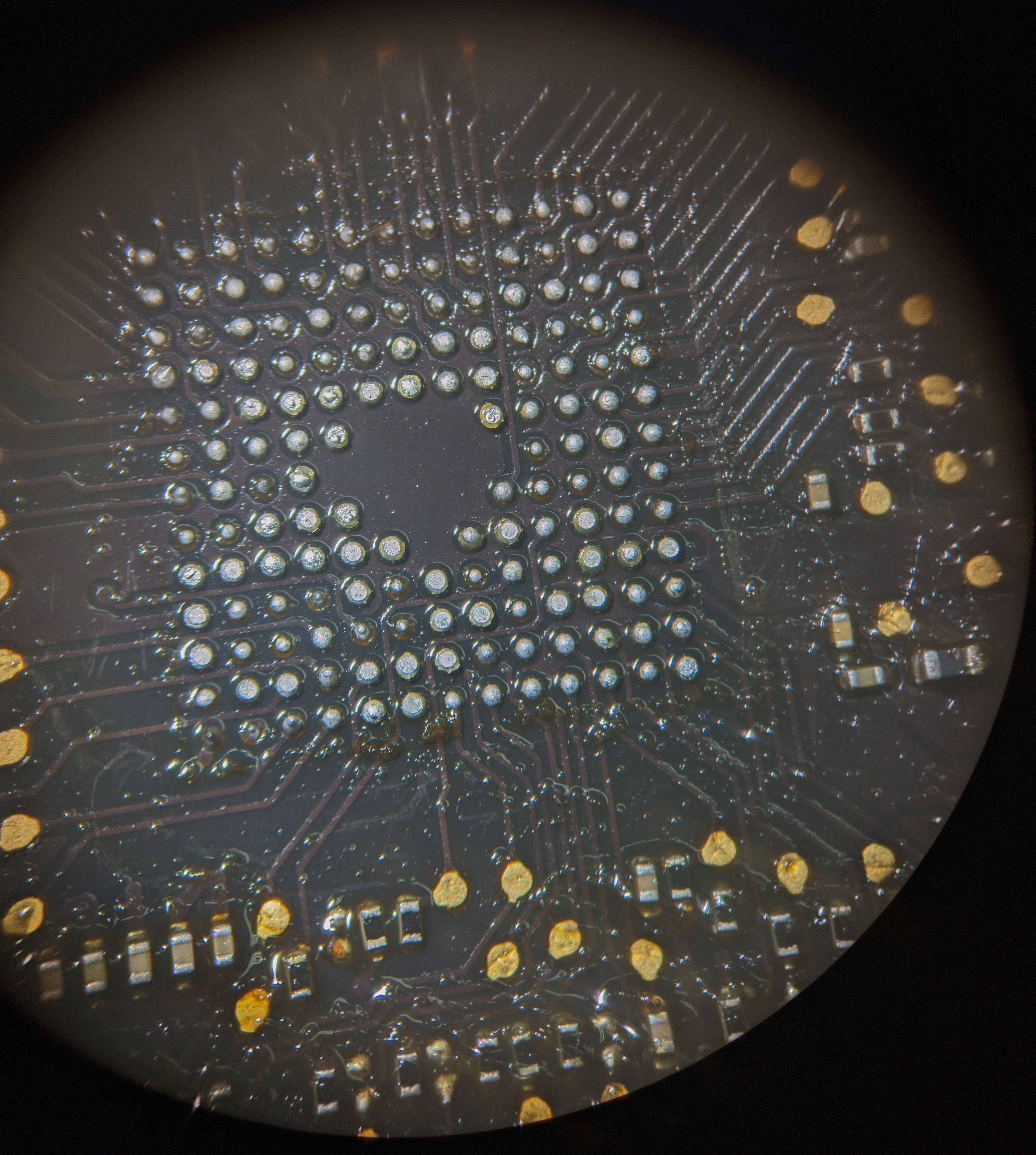

                        I cleaned the U7400 area with flux, solder and IPA. Unfortunately R7460 was too corroded to be salvageable, just like C5126​.
                        SMC replacement:
ID:	3301094 Click image for larger version
ID:	3301097 Click image for larger version
ID:	3301100 Click image for larger version
ID:	3301095 Click image for larger version
ID:	3301099 Click image for larger version
ID:	3301096 Click image for larger version
                        SMC_XTAL: 1.145V
                        SMC_XTAL_R: 1.206V
                        But still no light on the charger and no fan spin... what should I check next?
