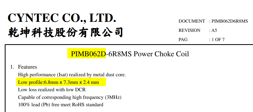

    When I took it out it broke, and I want to get the same one or one of good quality.
    Where can I buy it? On AliExpress they do not indicate the maximum amperages, and on Mouser or TME.EU it is impossible to search without having the exact reference.
    Inductor needed:
    It is the PP5V_G3S Coil of an A2159, 820-01598 (L7670)
    On the front it says: 1R5
    and in the schematic:
    1.5UH - 20% - 12.5A - 0.017Ohm
    PIMB062D-SM
    152S00268
    Can someone tell me where to buy it?
    Thank you so much.​

    Some details of the original:
    Still looking but you require a 7*7*2.4mm (height) inductor that can support 12.5A or more. Some good brands include Bourns and others. Even Cyntec is a good one to use here. So far, in this physical size, the peak current ratings are lower. This may be still ok since this power rail is not consuming such high currents but for a safety marging, higher the better.

        Note that the original board demands a 1R5 = 1.5uH inductance. The digipart search is with a 6R8 = 6.8uH inductance (not the proper replacement).
        Found a suitable match:
        HCMA0703-1R5-R Coiltronics / Eaton | Mouser Canada
        * change the currency to suit your locale

                10PCS 0420 0520 0530 0630 1/1.5/2.2/3.3/4.7/6.8/10/15/22uh Molding Power Choke Coil SMD Power Integrated Inductors (aliexpress.com)
                0630 = 7 * 7 mm inductor. Order 1.5uH.
                But confirm the peak current of the inductor before placing the order.
