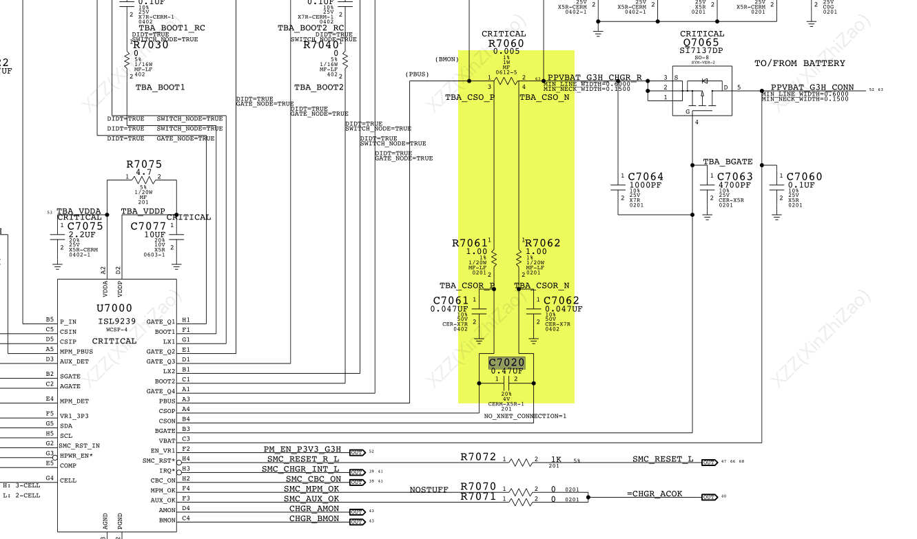

    macbook A1708 820-00840-A
    HI. I need help with this board! 5v/0a stable. Replacing the u7000 did not change the situation. Before I move on to replacing the SD3215, maybe there are some tips on what to pay attention
    also need a diagram and boardview

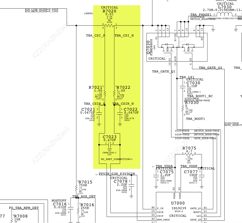

            With no power, check the full path resistance of the current sense resistor on U7000 (ISL9239).
            • PITERPENY
              • Jul 2023
              • 461
              • Ukraine
              all components have a good value within 0.425 to 0.547 in diode mode! Removing f7000 does not affect anything
              • mon2
                • Dec 2019
                • 14657
                Sorry - should have been more specific.
                1) Diode mode testing will only confirm that the I/O pin on the IC is not damaged. Your readings are good to validate this status.
                2) We are after the full path resistance of the current sense circuit so you will need to be in resistance mode on your meter (lowest scale if manual version meter) -> one meter probe on one side of C7020 and other meter probe on other side of this capacitor.
                We are wanting to confirm the start to end resistance which must match the schematic values. This is for the charging circuit current sensing.
                Repeat the same style of testing with C7023 = current loop sensing for the INPUT of this critical power rail.
                PS: Should you not be sleeping?
                Click image for larger version  Name:	current_loop.png Views:	0 Size:	219.7 KB ID:	3268669

                    C7023=2.4ohm
                    C7020=2.4ohm
                    • mon2
                      • Dec 2019
                      • 14657
                      These are good measurements. Are you using a usb C meter? Is it bidirectional type ? Does the same tool show a valid current draw on other devices?
