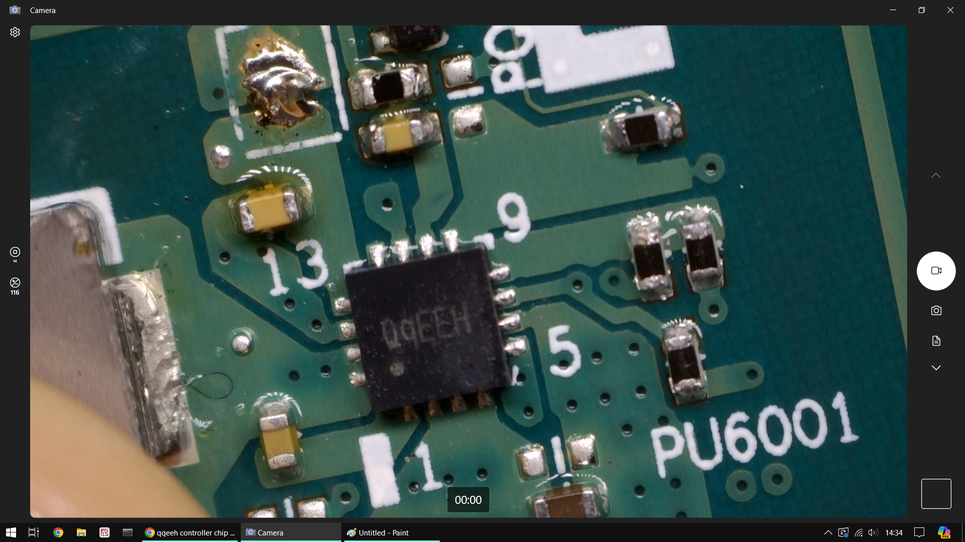

    QqEEH - Lenovo NM-D522
    Hi There
    So I am looking for a part. Namely, a QqEEH. I beleive this is responsible to create the 3.3 power rail, but on my motherboard it is shorted to the ground. injecting 1 volt into the 20 volt power rail the IC heats up. Around the IC almost everything is shorted to the ground,
    Anyone knows what this little controller chip supposed to be?
    Thanks,
  • mon2
    • Dec 2019
    • 14679
    From the above database of parts:
    Qq*** SY8386BRHC (EL432 EL532 LA-H131P)
