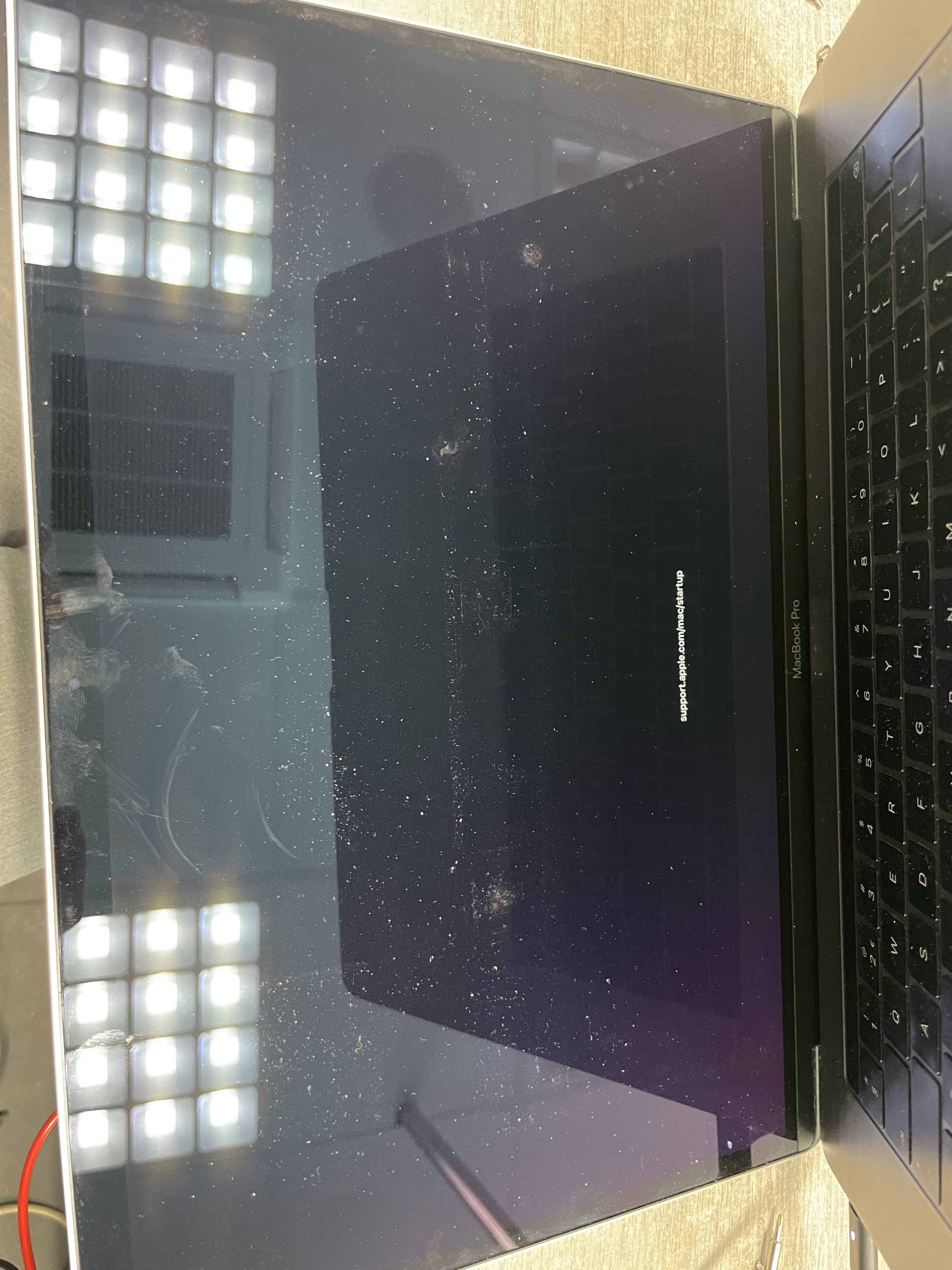

    Macbook A1990 stuck on logo
    This Macbook Pro 2018 boots up and then gets stuck on the logo.
    All the normal methods of resetting this Macbook have been tried but do not work.
    I cannot get into recovery mode and there is no bar displaying, it's just the white logo on a black background.
    Any help would be greatly appriciated.

      • mr.Data
        • Sep 2018
        • 77
        • Netherlands
        Can you show me which pins I need to measure?
        When I disconnect the battery and close the lid and open it up again I get the startup link from Apple but I dont think that means anything right?
