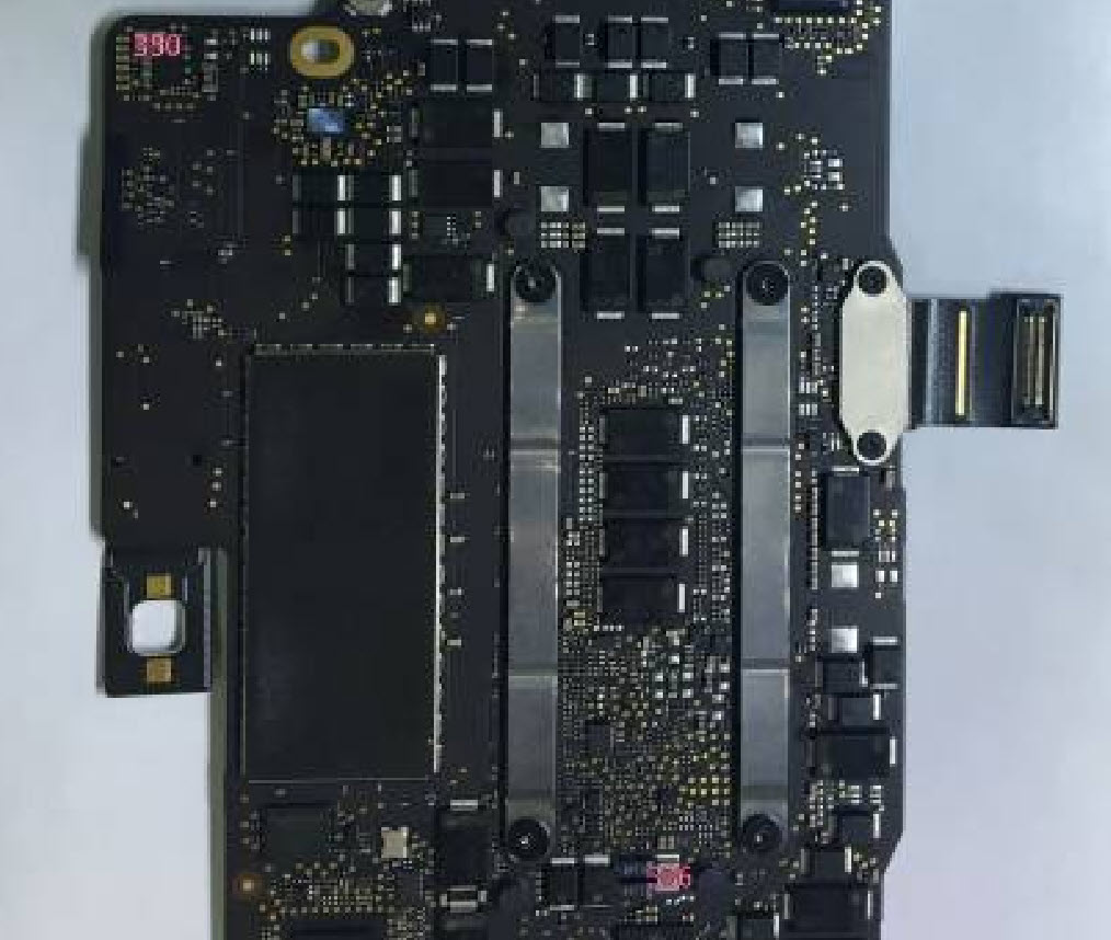

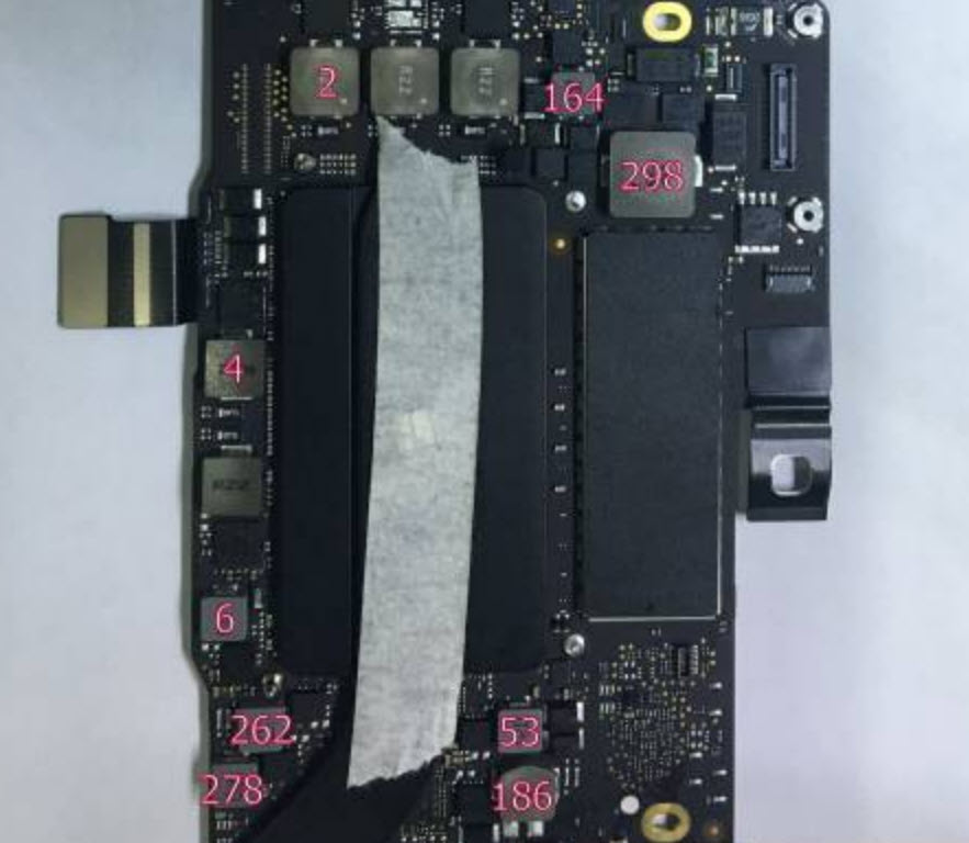

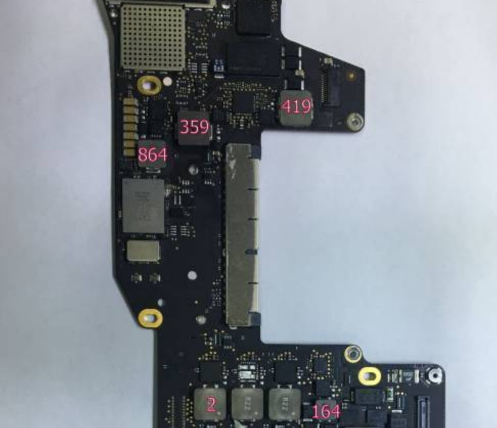

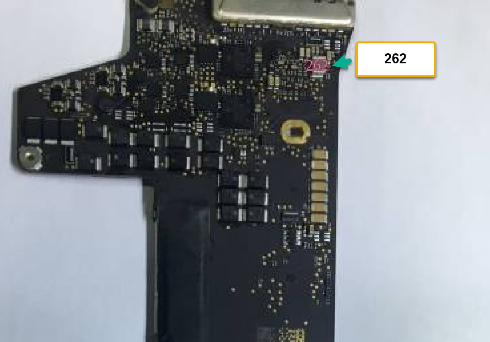

        Review each and every power rail - especially the SSD power rail.
        Also see attached for a chart of inductance to ground readings. Remove all power before taking measurements. Meter in lowest resistance scale.

          hi mon and tnx for reply. none of that measurement give me low value. those on first picture show an over ol scale when measure and voltages are good and present there.
          the only one reading different is l7900 that i resistence mode 0-200 scale give me 50 value, but there is around 1 volt there when pc is powered on.
          update: just discovered that first time i give power to board, fan spin, ppvcccpu_sog_ph1 start at 0,9 volt then drop to 0,63volt ( i see on another videovideo that around 0,6 volt are perfect after volt drop), while when board start reboot cycle volt here start again from 0,9 and then drop to 0,78 and no more fan spin.
          pp5v_s0 always present when board is on. goes off just after board reboot then comes on again. same for all other voltage 1,8s0 3v3 s0 3v3 s5 3v3 s4
