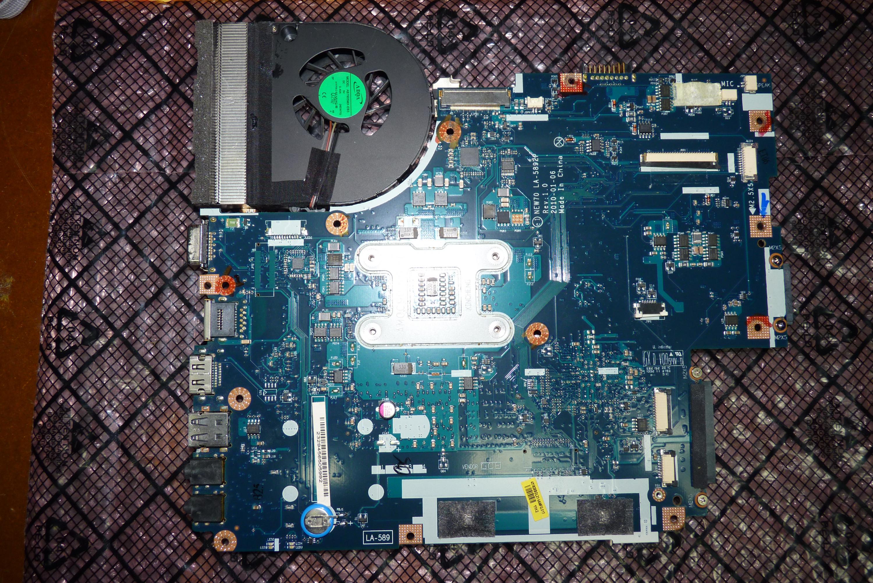

Gateway NV59C09U No backlight LED
  • Reech
    • Sep 2012
    • 21
    Motherboard: NEW90 L21
    I can faintly see image on the display with flashlight but screen has no brightness at all. Laptop was dropped; replaced the power jack and LED display cable. Both were damaged and the left hinge was snapped off and flopping around. The LED cable must have shorted something since the display was working prior to the repairs.
    The 2 fuses on back of the LED display check good.
    I could not locate any other fuses on the motherboard.

    You are going to have to post good clear photos of both sides of the boards.
    Dropping - if it was on at the time could have displaced graphics chip?
    Have you tried it with an external display?

          I am attaching two pics of the mobo.
          • selldoor
            Slow Learner
            • Dec 2010
            • 7870
            Re: Gateway NV59C09U No backlight LED
            IMPORTANT These pics look to be taken on an antistatic bag?
            and the cmos battery is in?
            Antistatic bags are slightly conductive and can short out sensitive components.
                  get some sharp probes and write down the voltage from LCD connector!
                  1=
                  2=
                  40=
                        first we need schematic to say that. what is the mobo code ?

                              check page 22, LCD panel conn. pins 1,2,3 - 8 and 9
                                    Tried again last night, the orig. display works fine on a known good laptop.
                                    The known good display has the same no backlight on the problem laptop.
                                    So problem is with the motherboard.
                                    If anyone has any idea of a fuse or something on the mobo, this one is toast!
                                    Thanks to everybody that responded, your help is much appreciated.
