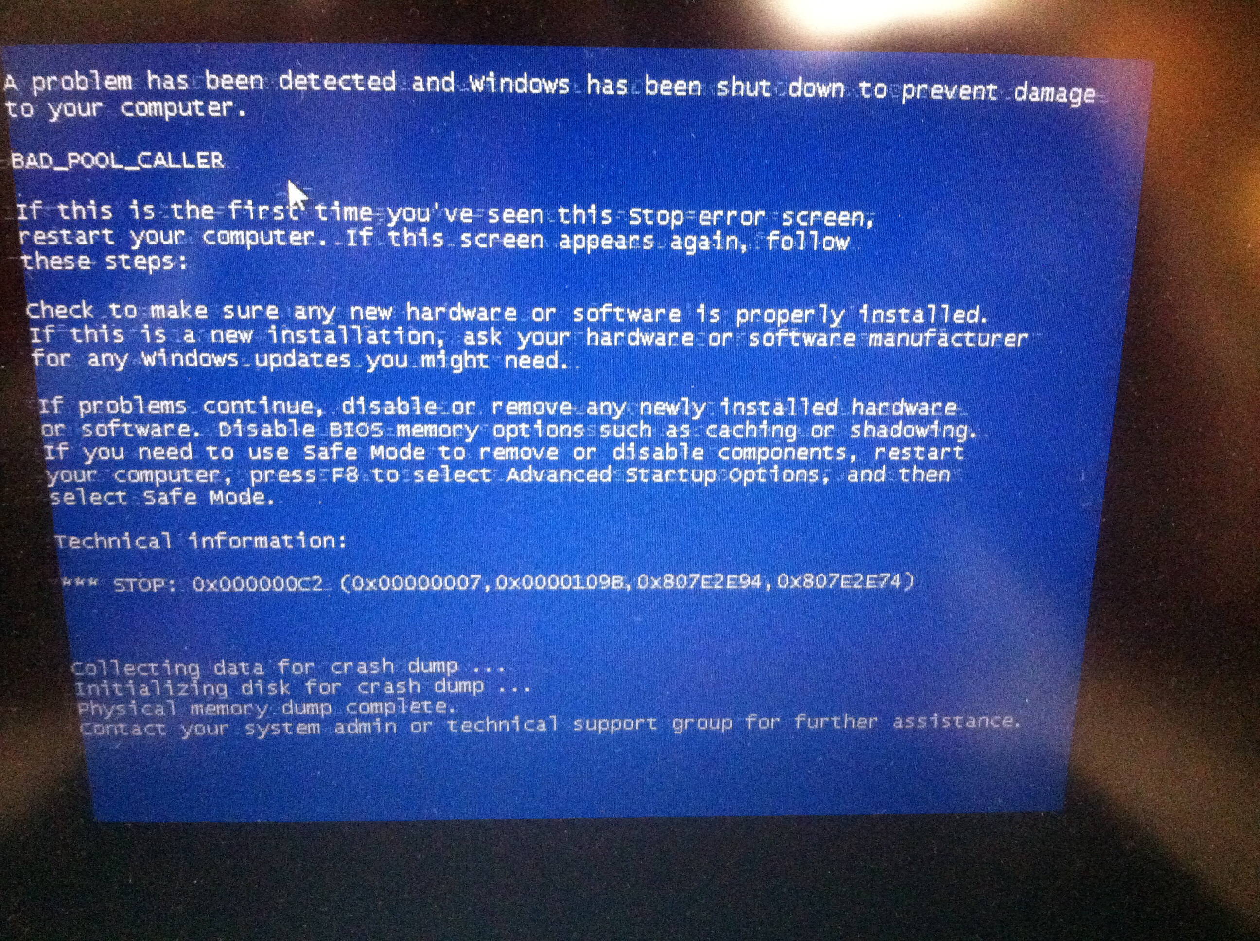

                Re: Alienware M17-R1, Windows 7, BSOD
                It finally crashed on me.
                • Th3_uN1Qu3
                  Believe in
                  • Jul 2010
                  • 6031
                  • Romania
                  That's typically a memory error. Run bootable memtest and see if it reports any trouble.

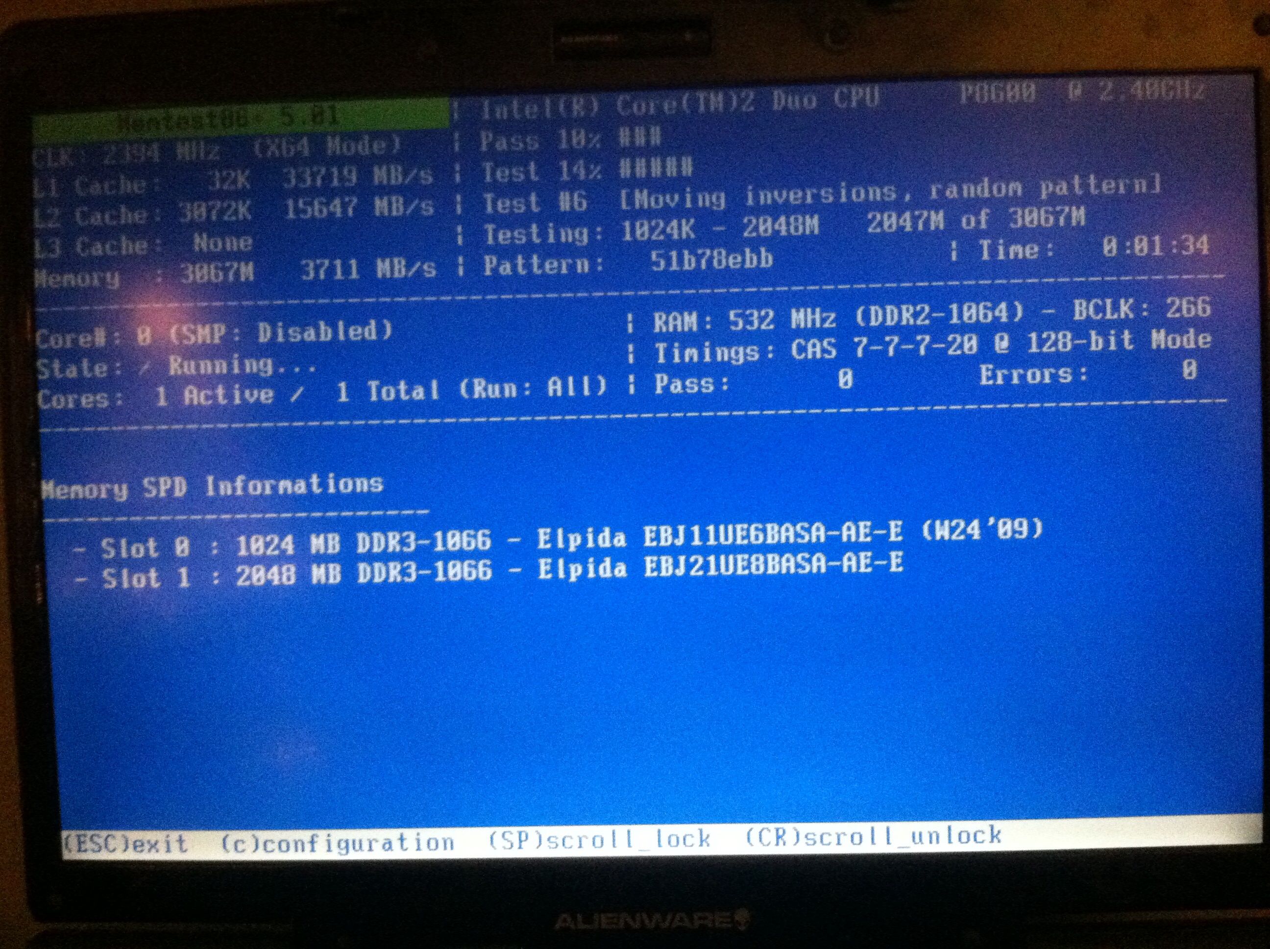

                        • johnboy1313
                          • Nov 2012
                          • 1959
                          I ran the test and went up to get ready to go out tonight. When I came back windows was booted. I expected there to be a message of some kind telling whether the memory was good or not. I'm running it again but I don't know if the test will be done before I go out. Here's a pic. Would running 1 gig and 2 gigs of memory side by side be a problem? I've always thought you had to use matched sticks.
                          • Th3_uN1Qu3
                            Believe in
                            • Jul 2010
                            • 6031
                            • Romania
                            That means it crashed and rebooted during memtest. 100% sure there's nothing overheating? Bad memory can also cause rebooting before it has a chance to display the errors.
                            It's usually not a problem to run unmatched sticks, but depending on speeds and timings, they may cause issues with certain configurations.
                                    It looks more like a power issue.
                                    No memory errors found with Memtest86. RJARRRPCGP, can you give a little more detail on checking the PSU?

                                      • spleenharvester
                                        • Mar 2010
                                        • 891
                                        Look at the artifacting on the BSOD screenshot. That looks like a GPU fault to me.
