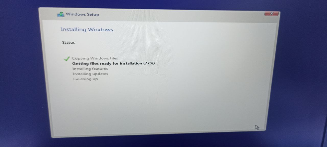

                    i suspects the CPU because in both windows and linux
                    i get BsOD OR just stuck there doing nothing
                    like now it's stuck on installing updates
                    or before it stuck on getting files ready for installation 77%
                    tried different types of flash drives even optical drives
                    attached a photo

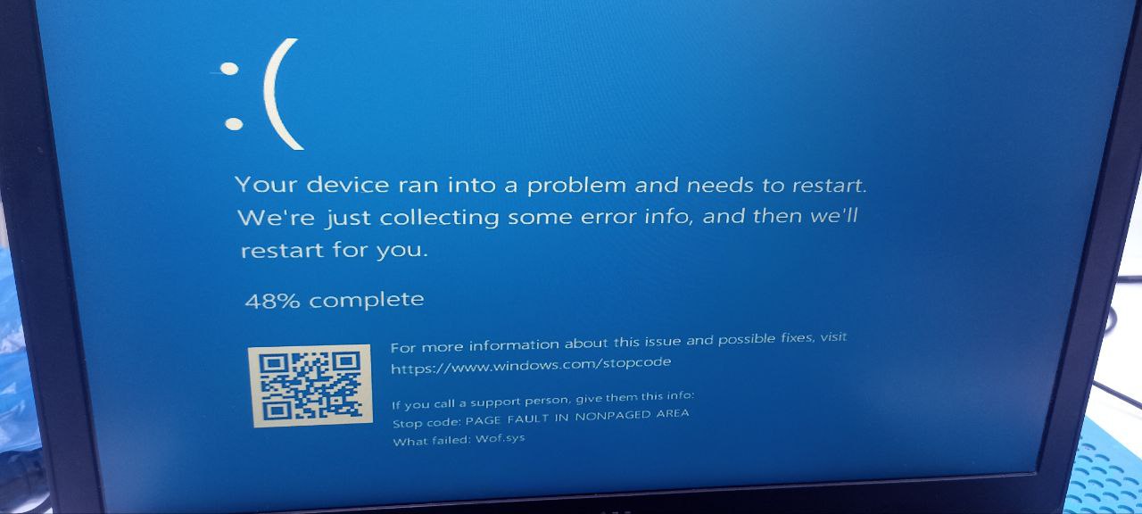

                      Re: PRECISION 3510 BSoD when installing windows
                      after downgrading the bios to the Recommended ver which is 1.31
                      i still get the BsOD but it's now shows the
                      Wof.sys as the failed thing
                      attached img

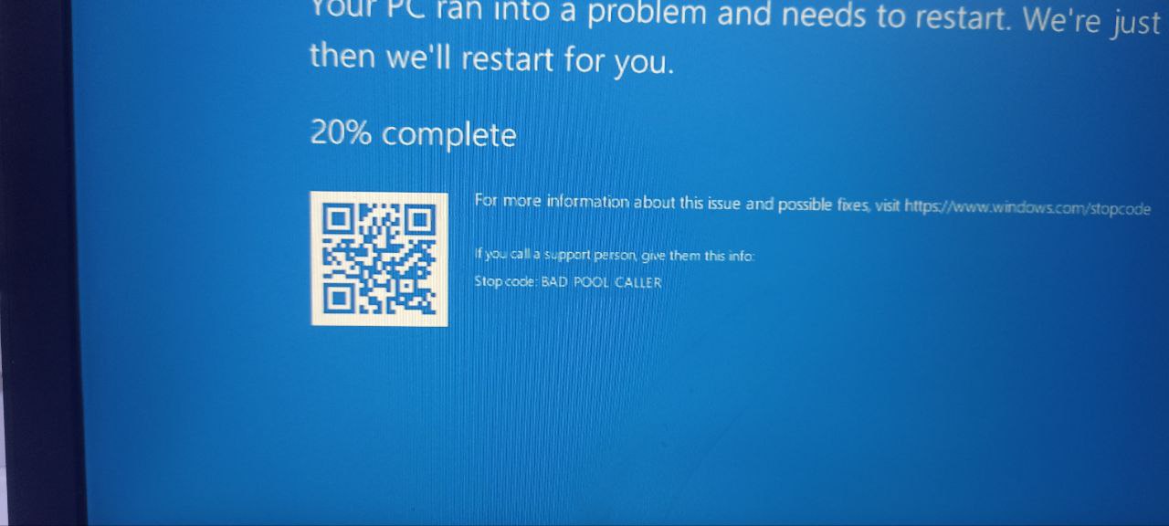

                              did a memtest86 everything passed good
                              Tried few other versions of windows and settings
                              i get different stop codes when installing windows such as
                              -memory management
                              -bad pool caller
                              that's why i think it's more of a hardware problem!!
