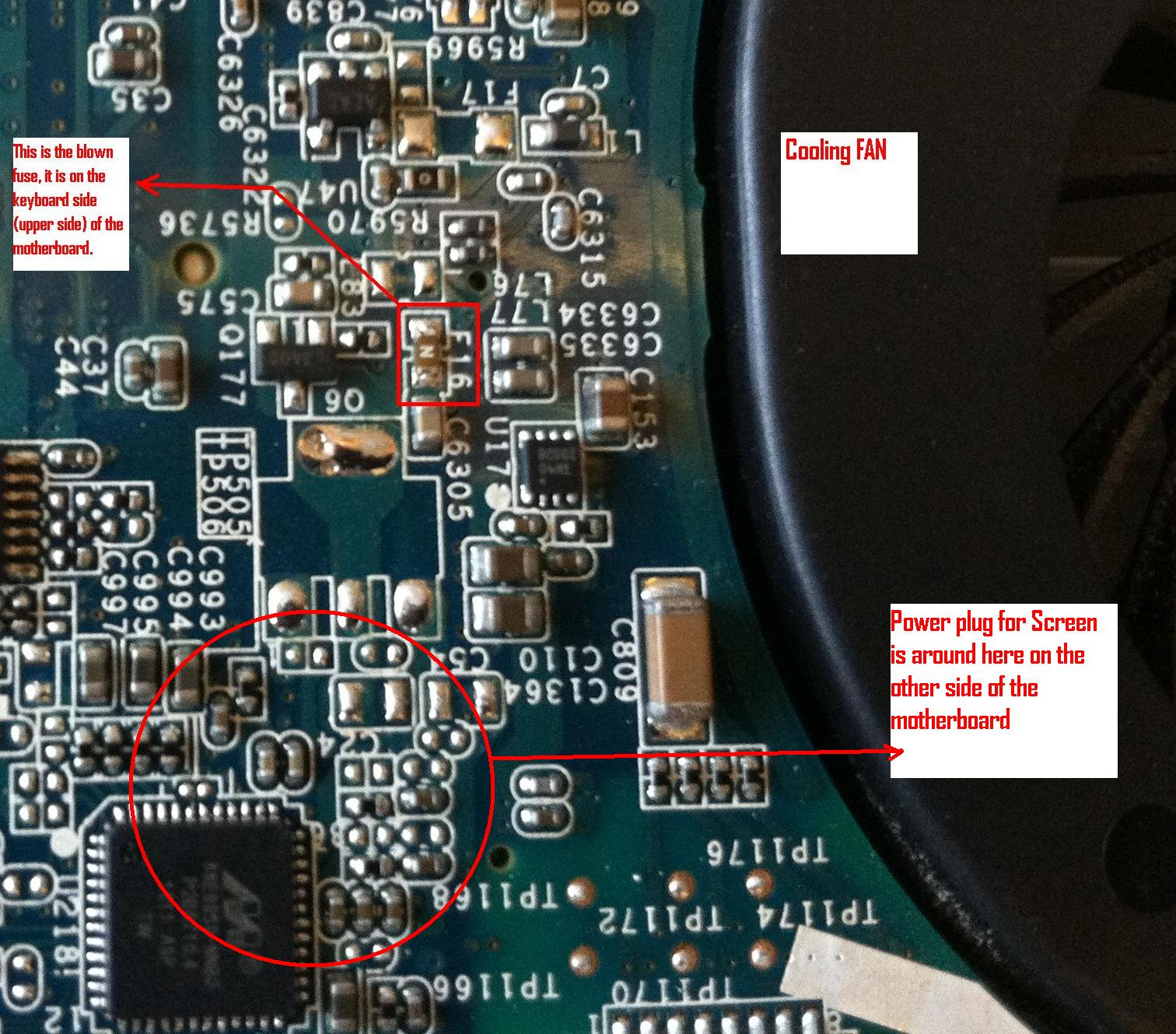

Sony VPCCA (MBX-240) fails to power backlight to the LED screen
  • orientalsniper
    • Apr 2013
    • 461
    I've tested with another laptop (same model), exchanged the LVDS and the screen remains dim. Switched the screens too.
    I remember reading there could be a failure with a controller powering the backlight, but I have no schematic and no idea where to start to measure.

    Re: Sony VPCCA (MBX-240) fails to power backlight to the LED screen
    Alright, I fixed it, it was a fuse on the upside of the motherboard, directly on top of the LVDS connector.
    The fuse was F15.
    It looks like the one shown in picture (Credits to lilizerg from http://forum.notebookreview.com)
