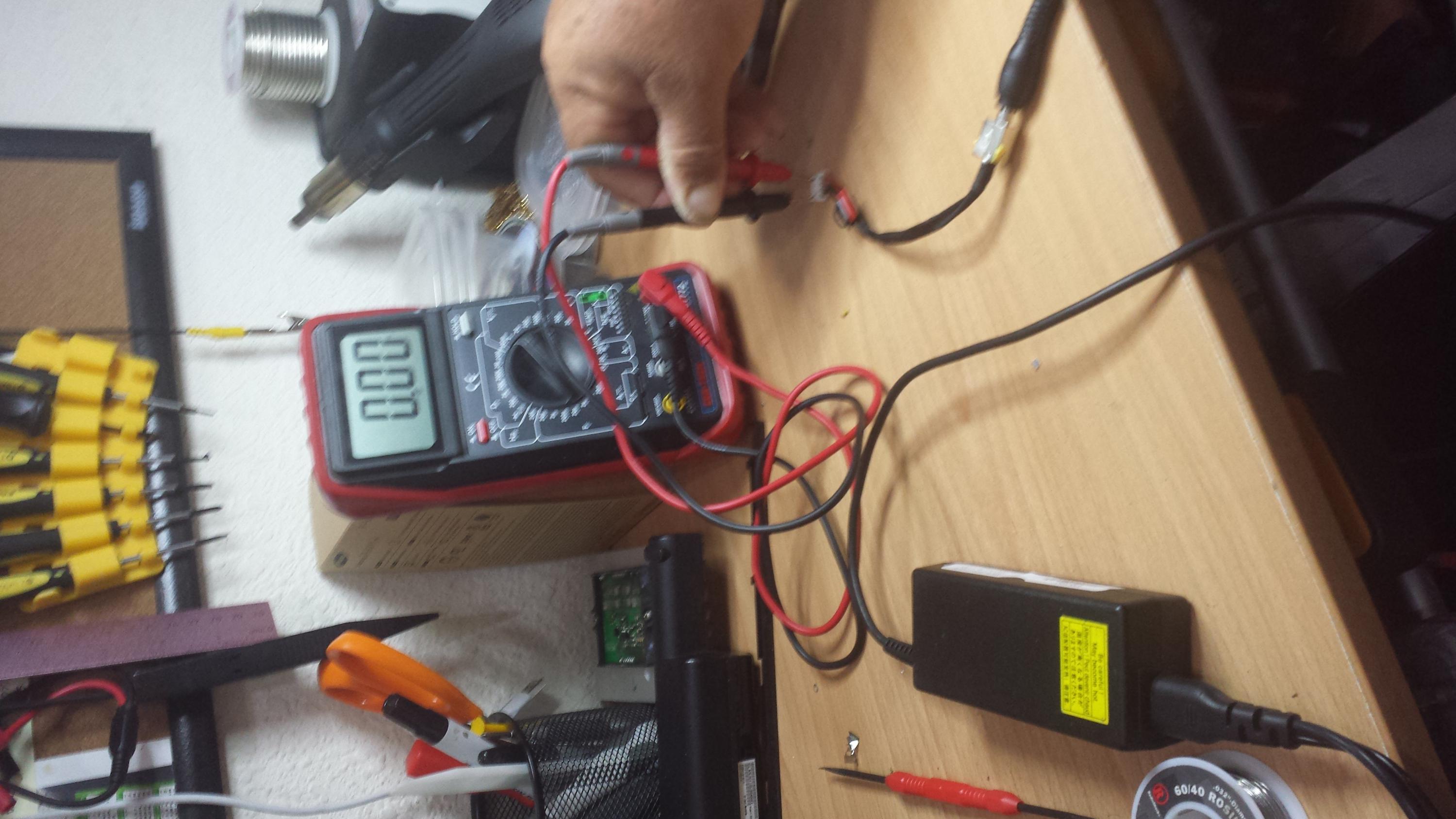

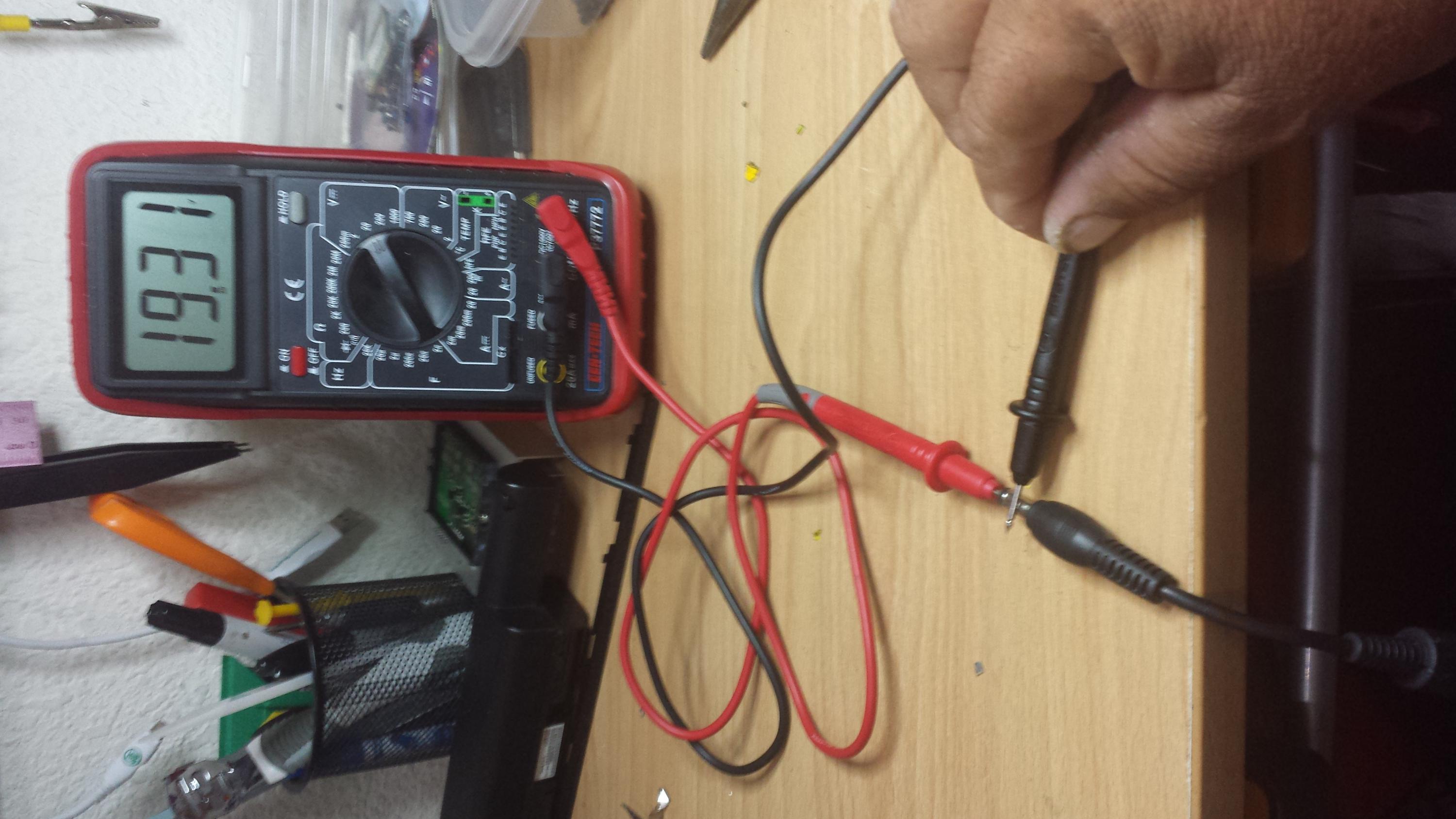

    Hello Fellas.
    I have a Acer Aspire 5349-2592 with power jack problem.
    Once I received this laptop (can't turn on), I proceed to check voltage of the power supply and I get it 19v., but my problem start once I check harness cable end (connect to the motherboard, red and black), I not get it voltage.
    I replace twice that power jack with the harness include and still no get voltage on the end of the harness.
    Do I need to get 19v at least on the end, right??

              Re: Acer Aspire 5349-2592 No power
              This is what I am talking about it.
              Check the pics.
                  thats a toshiba 19v charger the pin configuration its not the same.
                  the whole its to big for the pin.
                  try another charger
                    Thanks to all for you responses but on particular to dj_richoh
                    Was the fuck damn charger.
                    I try to universal ones and couple Toshibas but I thing Toshiba works with gateway but don't with acer.
                    problem resolve.
