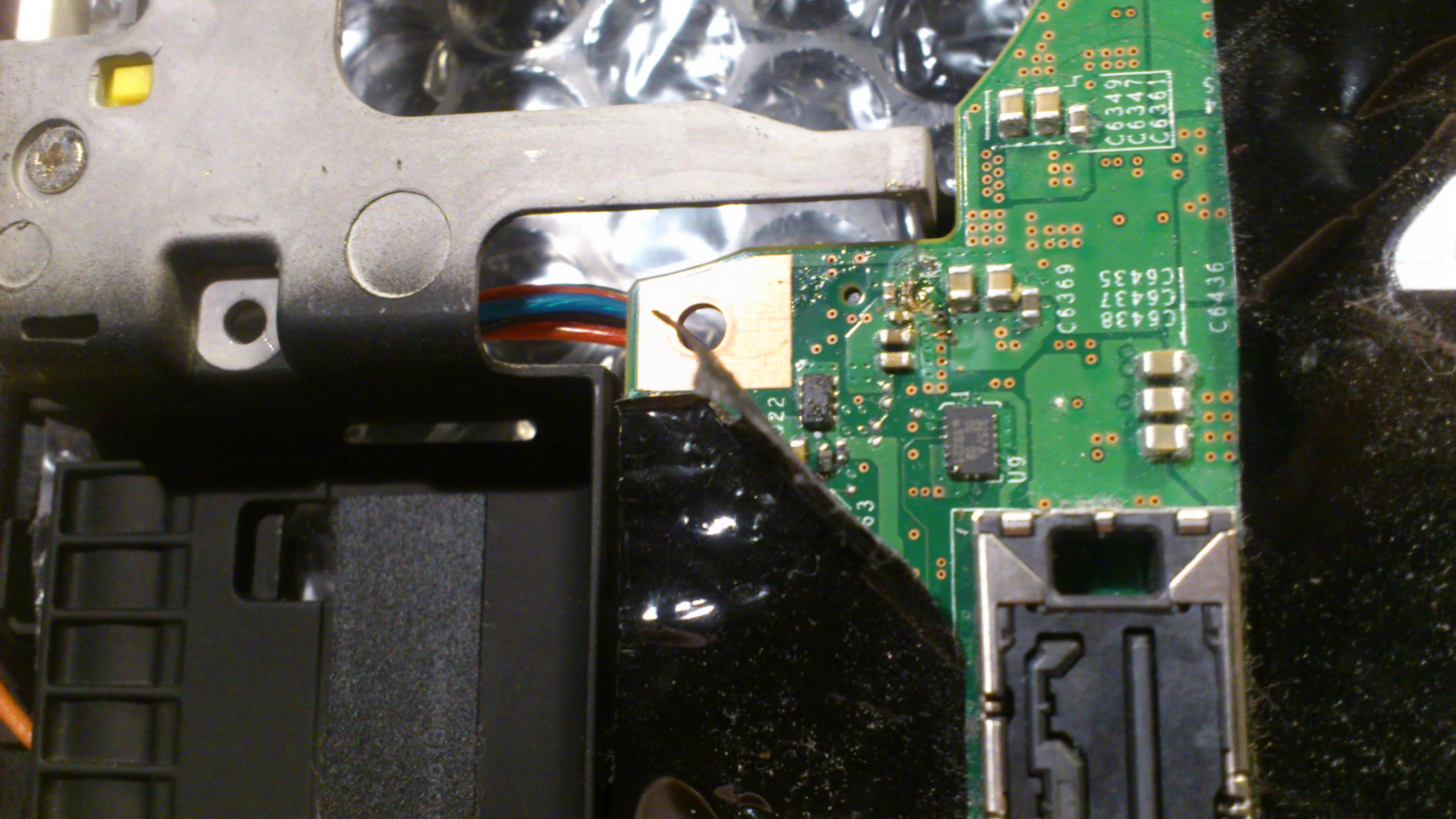

    can somebody help with a schematic for this notebook.
    i need to turn on the backlight i don`t need like a perfect fix just need to be on on full birghtnes.

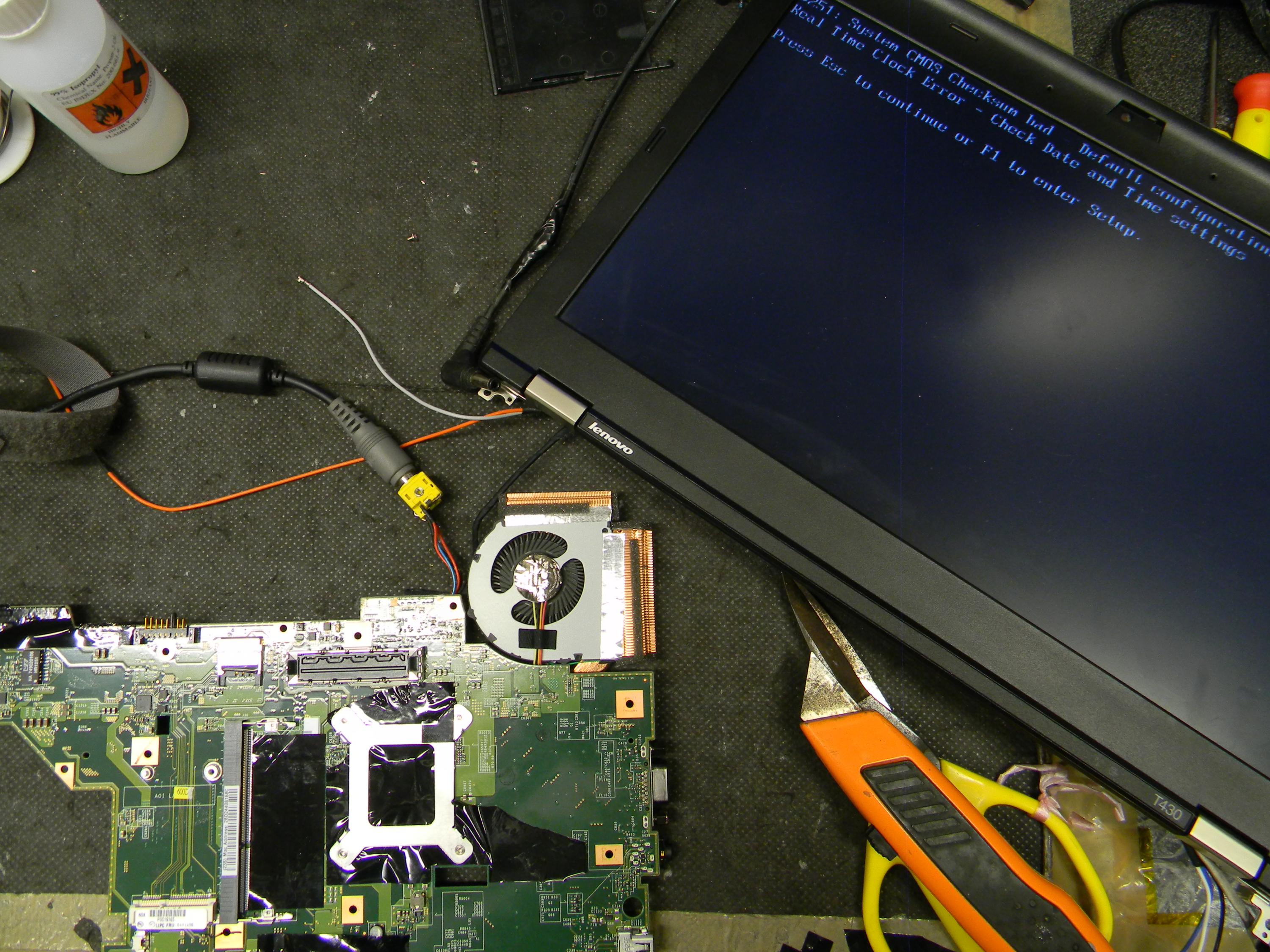

    i change the screen cable, i tested the screen in another notebook it works.
    it was note the same cuz if it was the same i will have taken apart and work mirror to the faulty board

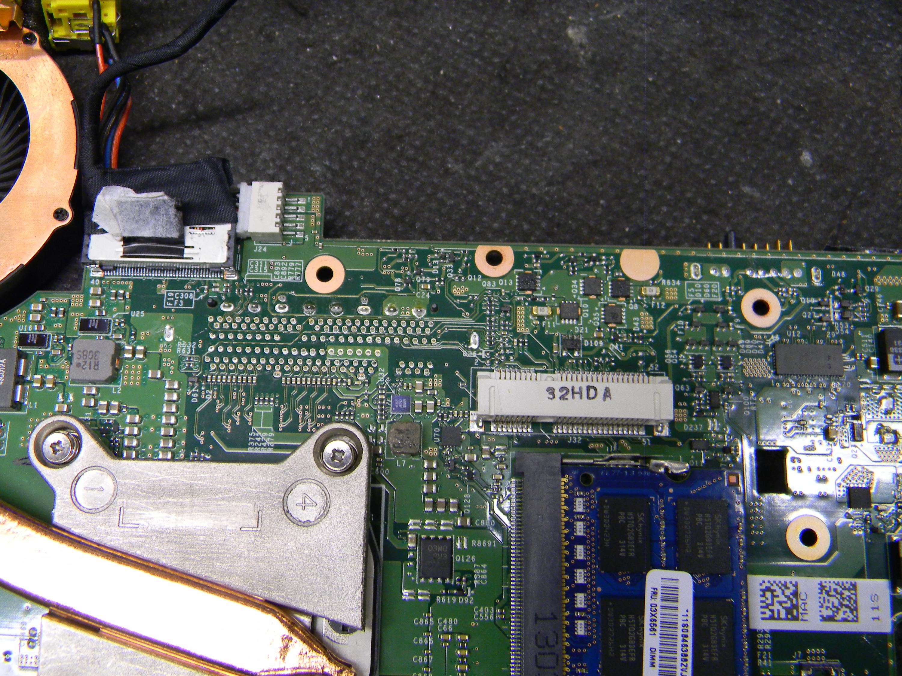

    strage part is that i never found a broken fuse but the one from the pic don`t have any voltage...
    it will be a big wonder if i new what V are in those fuses
    ty all

    Did you measure the voltages?
      Re: lenovo t430 no backlight
      0v on fuses
      i took out the screen full(whole case with cable just took it out from base notebook and connected to another lenovo and its working)

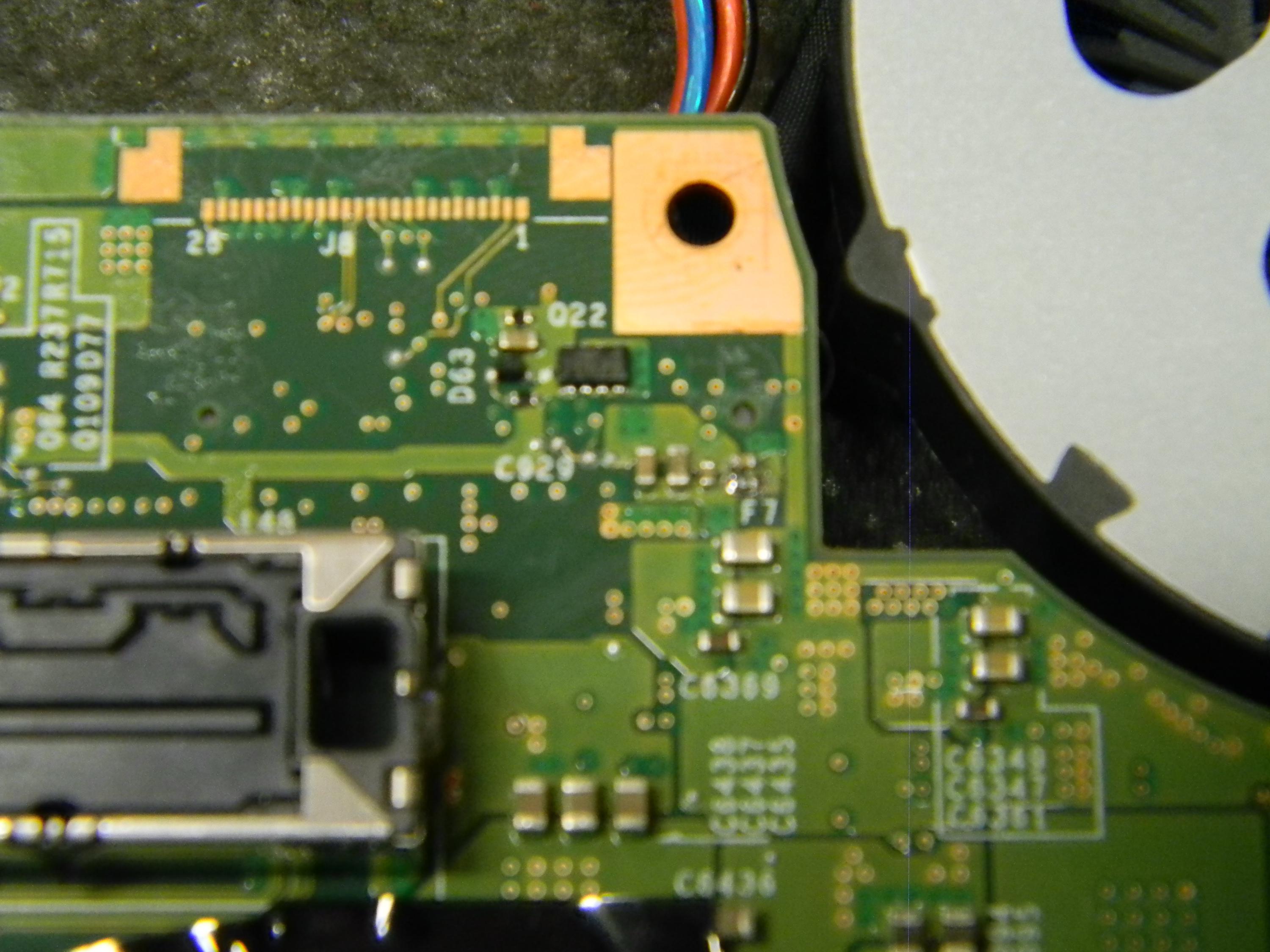

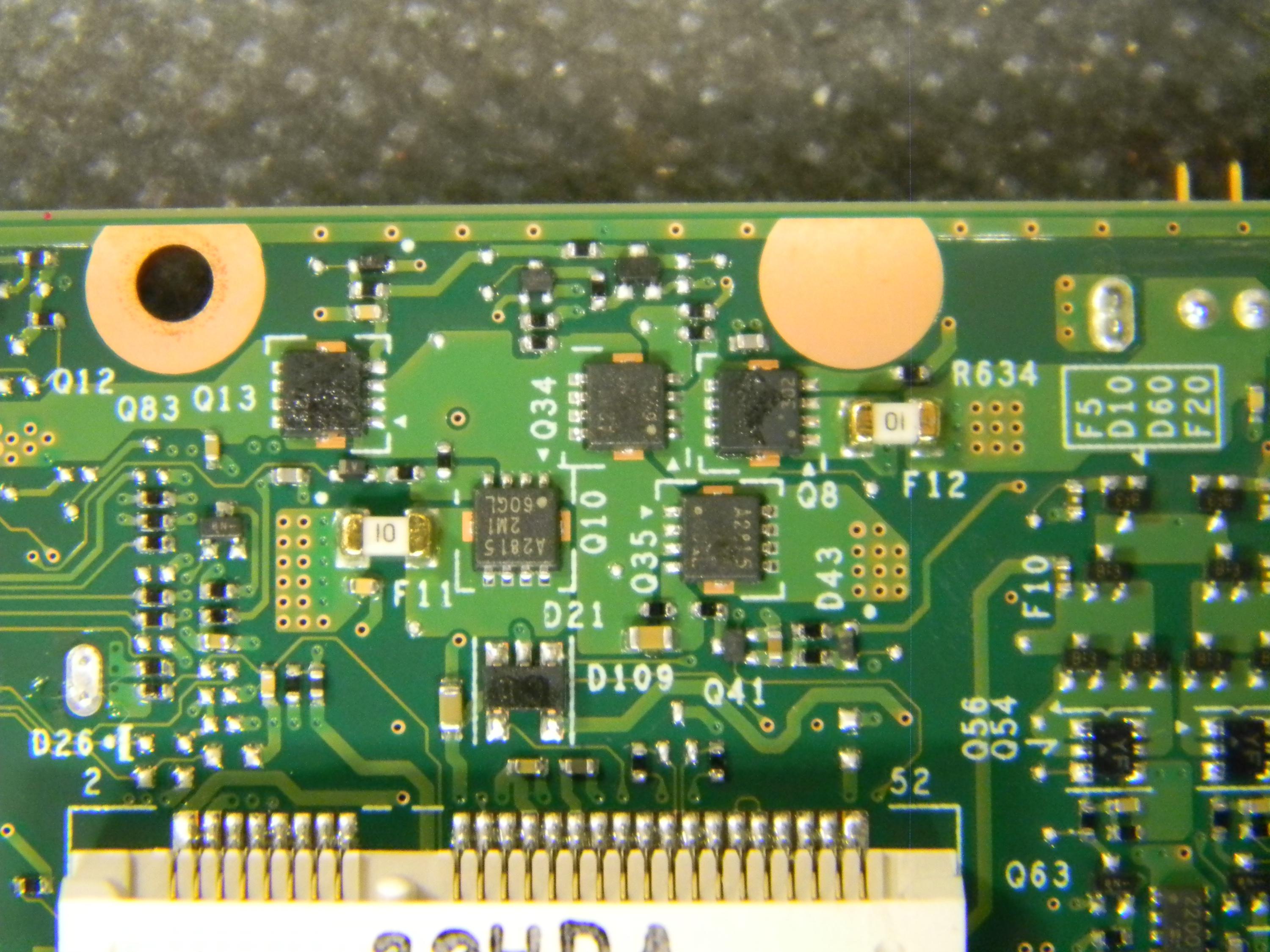

        SOLVED!
        the fuses from first pictures are for battery.
        the fuse for the screen its marked with F7 and its under the connector
        i do know that it req. 20v

                      you need to take it apart.
                      then we can talk because you will need to work and find that fuse.
                      its not hard i swear. you can fix it

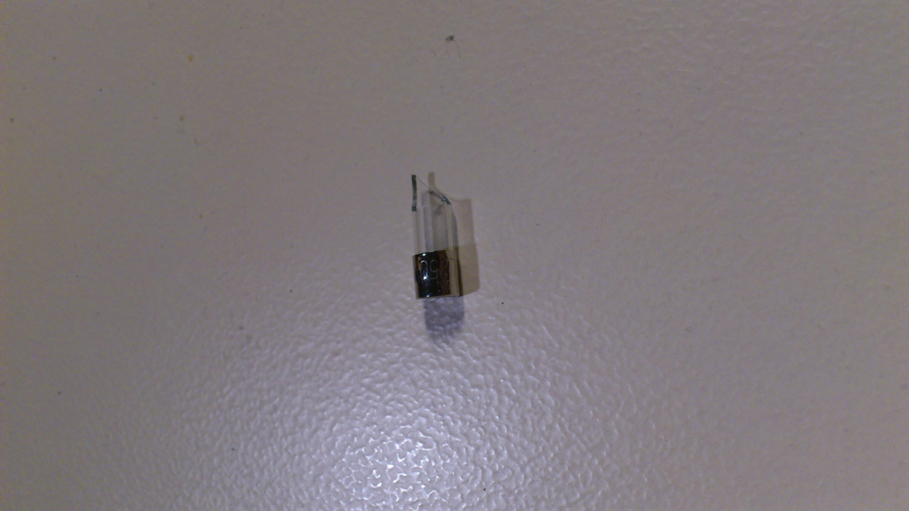

                                I use the fuse wire from a glass fuse that I break open and remove one end cap, solder the wire across the smd fuse and then cut off the excess wire and other end cap
                                always leave one end cap on for easy handling
                                you can use a glass fuse with the desired amp as the smd fuse that you are jumping, and feel confident that it is safe on completion

                                      Yeah, it finally worked! I broke open a 3 amps glass fuse, and soldered the little wire over the original fuse! Thank you very much, guys!
