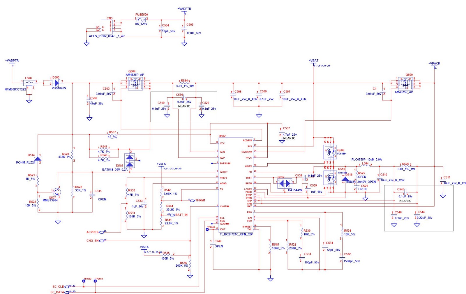

    I got this laptop where The voltage at D1(see page 46 in the attached schematic diagram) is fluctuating. Using power adapter,
    What i tried:
    1. TPS51123 is overheating so i replaced it with a new one.
    2. tested the mosfets, no short found.
    Havent tested the board using the battery. Any idea where the problem is? I also have acer 5570 zr1 with similar issue.

      Try to desolder these coils one by one and measure if there is a short

        I already measured the resistance from those those coils to ground but there are no short. Tried replacing U7 - BQ24745 charger IC but same problem. the voltage at D1 fluctuates wildly. I will try to remove U38 and U37 and post bact the result.

          Have you tested the dc adapter? I would put a load on the adapter alone (connect a 12v fan or something) and measure with volt meter to see if the voltage goes down. it should stay steady at almost the rated voltage. if voltage drops more than 1 volt try another adapter.

            Yes, adapter is fine. Tried another known good adapter still the same.
            I will try to remove the coil as suggested by tomodachi and measure the voltage across D1, will post back the result.
