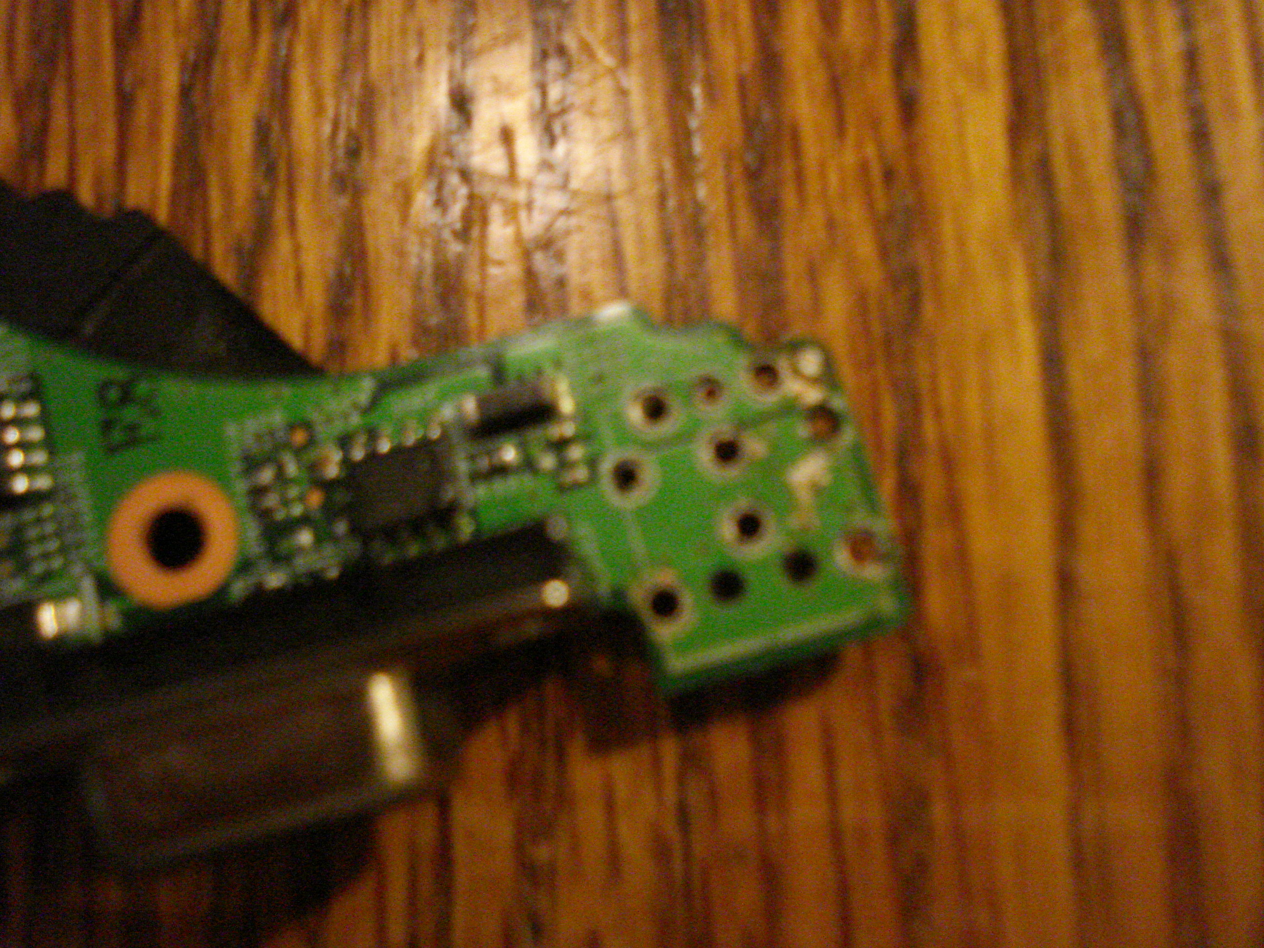

    Hi all, I just spent several hours last night disassembling and replacing the DC Jack on this Dell Laptop, I did a close to perfect soldering job when installing the new jack, got it all put back together and it still Will Not charge the battery.
    The charger is putting out the voltage, blue light on it is on. The battery is new, my Stepson (this is his laptop) got a new one thinking it was the old battery was bad but that wasn't the problem. I wonder if there's a small fuse in the charging circuit somewhere on the motherboard, or a way to fix this.
    Does anyone know of a solution other than replacing the motherboard? your help and replies are very much appreciated.

        Post a good clear picture of the area of the motherboard around the connector.

          I Fixed it!!! Yeah...Pulled motherboard out again and plugged in Powerpack, measured 19 volts at DC Jack Connector and followed to L31 had voltage on one side only, after a close inspection I saw a flaw where L31 solders to pads on motherboard.
          re-soldered both ends of it, measured voltage again and I had the 19 volts on both sides, I put the laptop back together and now it's working again and charging the battery. Phew what a job.

                This is a poor quality picture but its the corner of the motherboard with the DC Jack removed, if you look just to the upper right of the IC Chip you will see a black surface mounted device that looks similar to a resistor, that is L31 and the bad solder connection was on the side closest to the jack but I re-soldered both sides.
