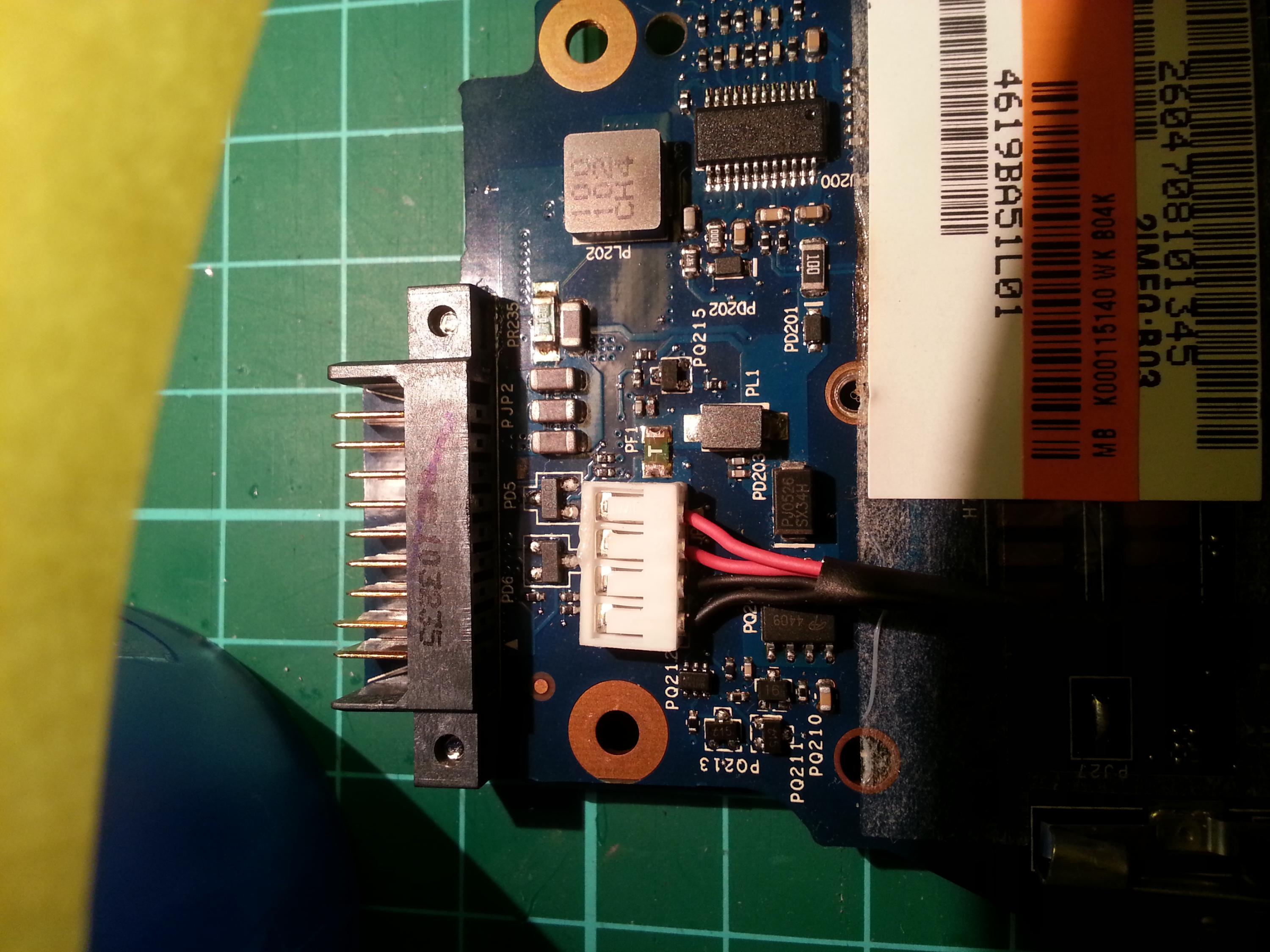

    hey guys, ive been reading this forum for a little while and i figured i might register. So anyway, the fuse on the laptop's motherboard (labelled PF1) is blown and i have no idea where to get a suitable replacement, also the laptop refuses to boot on battery power, just turns on then off. was really just a test laptop for me to mess around with it and see if i could fix it. im quite keen on getting into component level PCB repair and the like. Any help would be greatly appreciated!

    Can you post a good clear picture of the fuse and the area of the board

      ive tested the area around the fuse with a multimeter and tried bridging the fuse... when that it done the PC works fine... heres the pic (the light is from my $1.50 halogen globe from the 2 dollar store and a post-it note light filter)

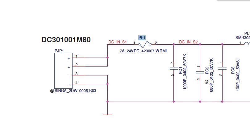

        Hi - ok not a simple answer the fuse is a Bourns 2.5A But I believe the schematic for
        a C660 (not sure about the D has a 7A24v Fuse so has it been replaced previously.
        So it may have blown because it is too small amps. I will attache some supporting info and you can decide. Perhaps try a 4Amp one??

        This is the datasheet for the fuse mentioned in the schematic as on pic
        429007 wrml
        https://cdn.badcaps-static.com/pdfs/...80ed0c5c0c.pdf
        This is the datasheet for the fuse you have in and you can see T is 2.5A but you can get a 7A

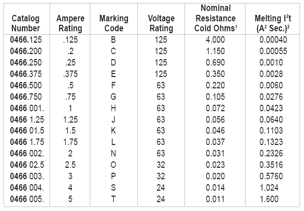

                  Well good thing you brought that up. I thought SMD fuse codes were more or less standard. In the past, I have been using this data sheet from LittleFuse to determine what the codes meant (or at least a screenshot I took from that data sheet - see attached image).
                  Given that this is the input and that most average laptops can use over 3A of current, I think a 5A fuse (minimum) is appropriate vs. 2.5A.
